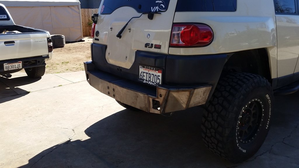

    Little fj action. Bolt on with swing out in the works.
    Need to add one more hole for the back up sensors.

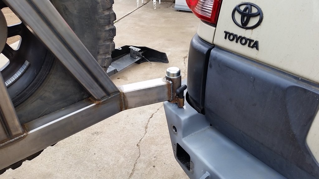

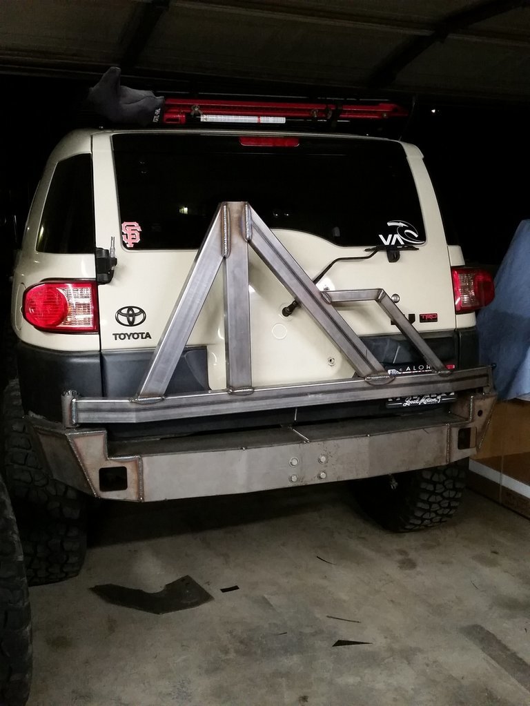

    Swing out structure complete, just gotta put some tabs and the mounts for the spare tire and rotopax.

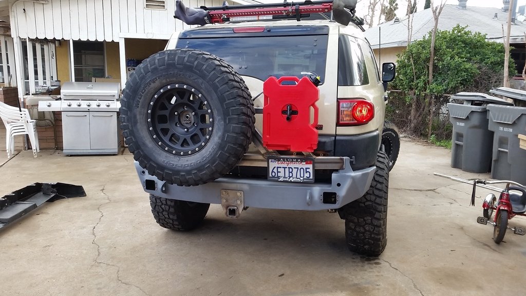

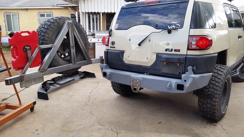

    went home with her new owner today

    There's a shit ton of weight hanging off of that swing out. Those km2s are crazy heavy. That's sealed Bearing sure is doing its job though

    Looks like some solid work bud. :thumbsup:

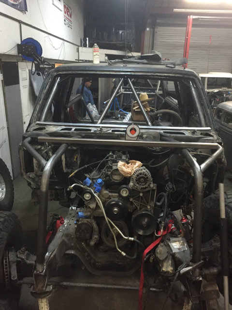

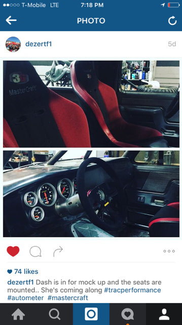

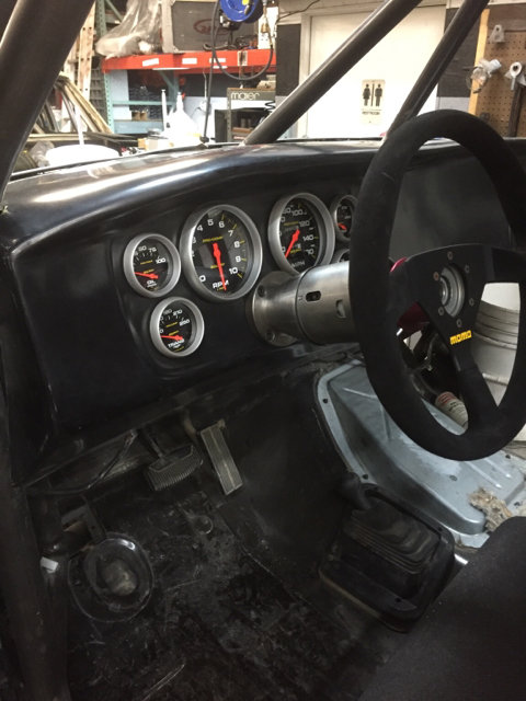

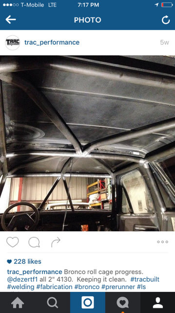

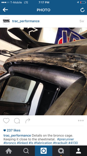

    Bronco I've been building. Some big plans for this thing. Ls motor, 4l80e, np205, 40 spline floater, 3.0 coilovers, 4.0 bypasses. All 4130, main cage is 2" mixture of .120 and .095 everything else will be 1 3/4 .095 4130. Full interior, ac/heat 65 gallon cell.

    What year body on that Bronco? 65gallon cell, damn!
