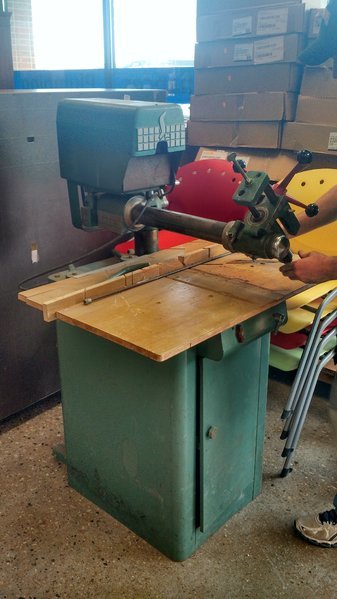

    Thanks. I have a crappy bench top drill press but its weak and the lowest speed on it is like 650. I had to look up what a mag drill was. :anonymous: I might try to rent one or find a local shop that will drill the holes.
    I've been considering getting this behemoth for $150. Some kind of radial arm drill press. Seems pretty nice but can't find any info on it. Has a saw attachment too.

    Save your money. That's looks like some version of a shops moth or similar. Mainly for woodworking and no parts available. They did lots of things, none of the well.

    Probably why I can't find anything on them.:oops:
