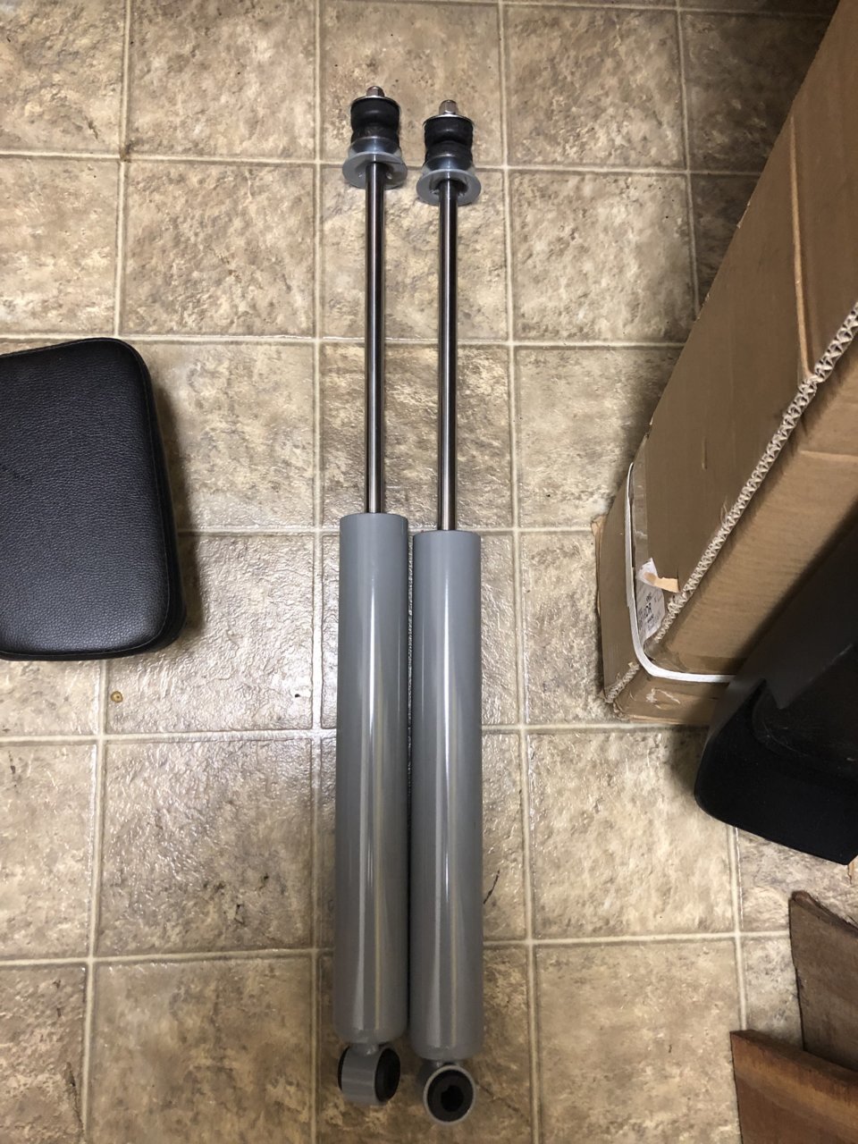

    Got the shocks, they look good. Also got the brake lines from wheelers. Install hopefully soon when I have time.

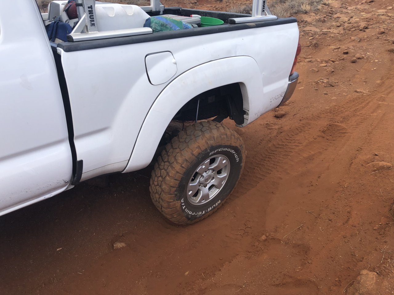

    Spent about 3 hours on washboard roads and about 2 hours in 4 low crawling. They performed great. No idea if they actually got me more travel, but my friend driving behind me said my rear axle was flexing out more than before. Lol. So take it for what it is. Bilsteins are sold out forever and these are working great. $130 for the pair.
