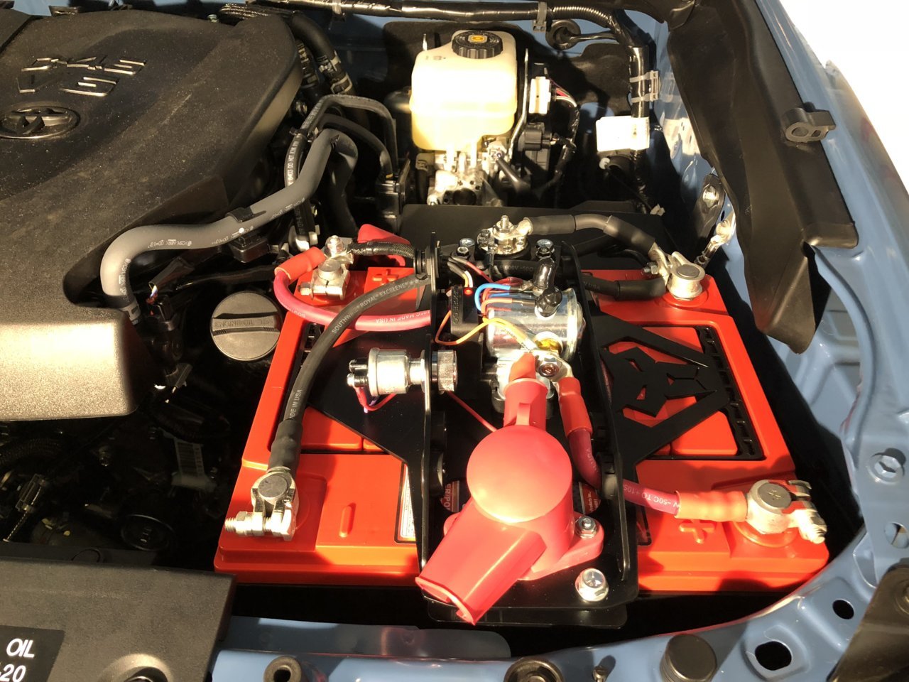

    I have this setup with Odyssey 34-1500 batteries. Clearance is tight but manageable. The only thing I don’t like about it is cutting the perfectly good fuse box clip. Other than that the setup is solid. Genesis recently upgraded from rubber wellnuts to steel ones so torqueing them down is a none issue now. It took me two hours for the install but probably could have done it in 45 minutes if I minus beer breaks!

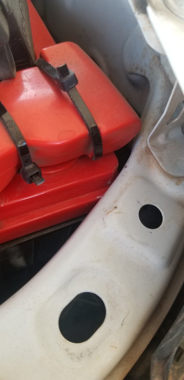

    I have no affiliation with Genesis but their dual battery system has caused two issues on my buddy's Tacoma while we were out on trips together, both of which caused fluid leaks as follows...
    May 2018. Genesis Dual battery system installed.
    March 2019. Oil filler neck broken due to Genesis Dual battery system too close to engine. (We plugged the valve cover temporarily with the positive terminal cap cover, at least that part of the system was useful).
    July 2019. Hole in radiator due to cracked wheel well support in 3 places from the weight and mounting of the Genesis Dual Battery system.

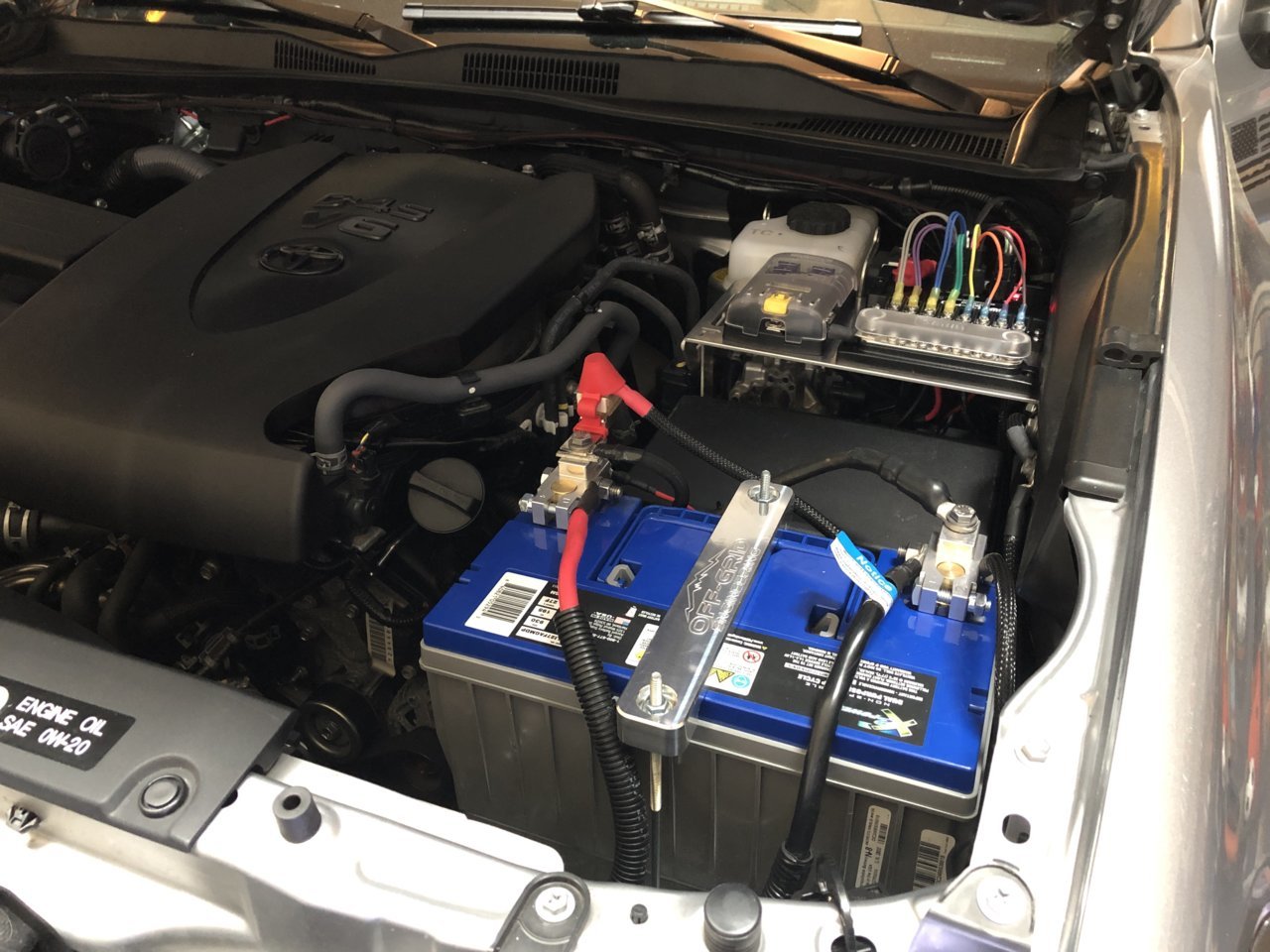

    This is why I didn’t go this route, I did single 27F AGM. That’s too much weight in the corner combined with very limited clearance is no good. There is a company out there, can’t remember who, that makes a new filler that relocates to clear the batteries. It would be nice if Genesis would make it with 25 group size to aid in reduction of weight and generate a little more clearance, or get on the band wagon and make a separate mount for passenger side.
  18. Jul 13, 2019 at 10:46 AM
    #38
    EricTRD4x4
    EricTRD4x4 [OP] Well-Known Member
    Jul 18, 2016
    #192294
    99
    2016 DCSB TRD Off Silver Sky Metallic
    Bilstein 6112 and 5160, CBI Hidden Winch, Warn VR10, TRD Wheels w/ BFG KO2
    My setup.
