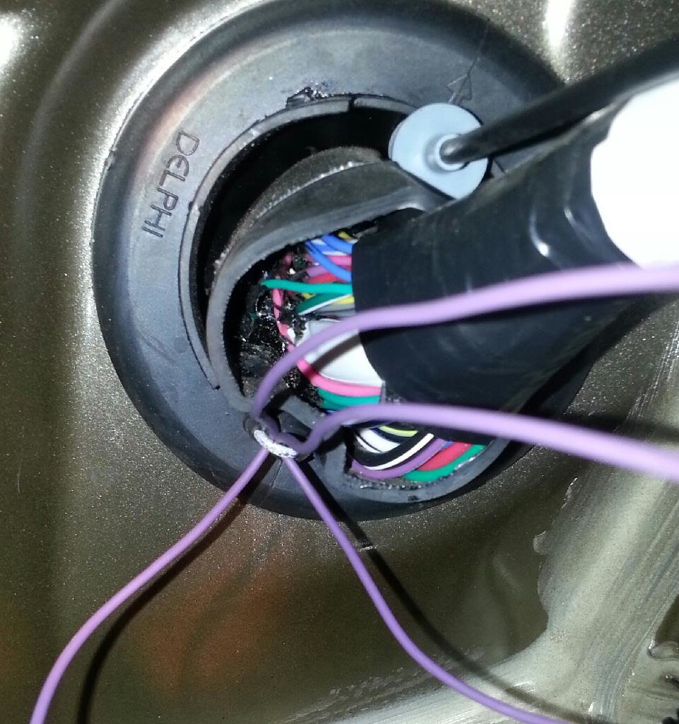

    Install is really straightforward, thanks for the detailed post.
    The only thing I would add is some detail on fishing the wires through the firewall grommet which took me the most time in the whole install. The hole on the side of the grommet in the first picture is where you push the hanger through. I could not get the loop of the hanger to pierce through the rubber dimple either. Inside the engine compartment you will see the tip of the coat hanger inside the rubber protruding beside the factory wire harness. I also had to use a knife to make a small slit in the end to expose the end of the loop allowing me to pass the wires through.
    EDIT- see post #68 later in the thread on Page 4- he had an alternative method for feeding the wires. There are also some alternative places shown to mount the sensor up behind the open grill without drilling.
    Tip of the coat hanger loop protruding just through the dimple so you can run the sensor wires through it:

    You are welcome, and yes, that grommet is thick and hard to push the wires through. It also took me a long time, since I worked carefully to avoid damaging any of those factory wires which are in that area.
    Thanks for your picture.
