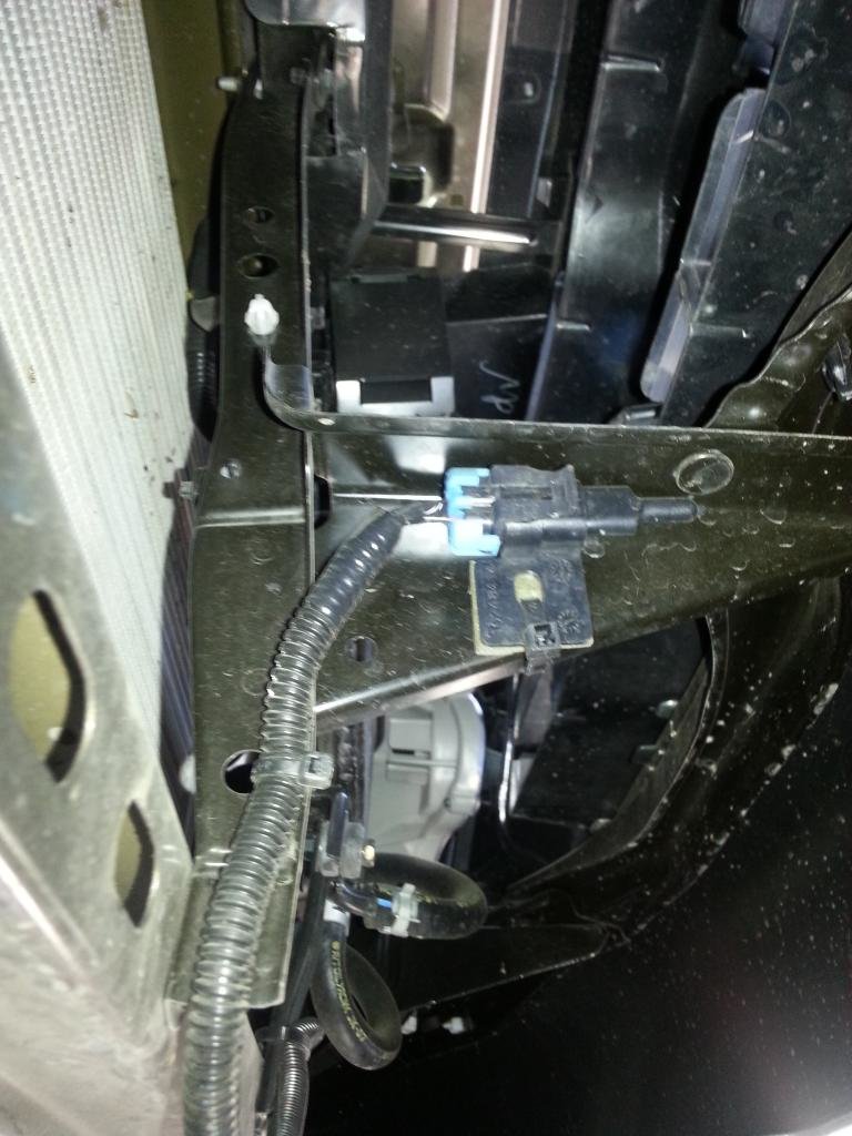

    Probably a dumb question, but does this mirror stay on all the time?
    I am wanting to utilize the 14 pin plug, (shown in Part 3 of the first page of this thread) for hard-wiring a dash camera, rather than the mirror, but I just checked it and it has 12V power even when the ignition is off. I wouldn't want the thing to be running all the time, even if it uses very little power.
    I thought it would be really nice if I could use the already available plug right where I would put the cam anyway.

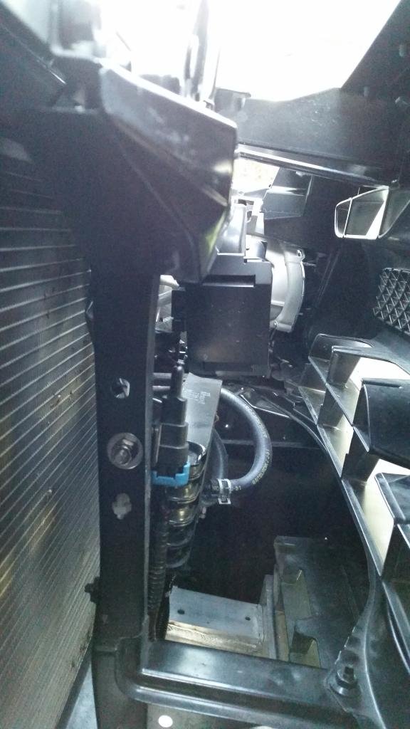

    Editing this post- after seeing another post later in this thread I moved my sensor up to a different location near the factory sensor using another pre-existing hole. I didn't need to drill or take anything apart under the hood.
    I originally mounted it like in the pic below but it was behind the bumper and under the bracket. The sensor would give really high temp readings when idling in traffic and I would not recommend mounting like below.
    I just mounted it here on my OR w/ tow pkg. Put a piece of closed cell foam behind the mount for vibration control and used an industrial tie wrap- done.
