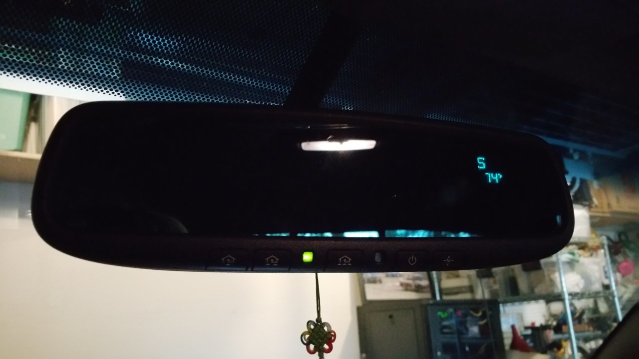

    I just did the Gentex Homelink mirror mod to my '14 Tacoma, and I found the directions on the first page of this thread to be excellent. I followed them as accurately as I could, and I was able to get the mirror installed in about 2 hours. Most of that time was spent fishing the temp sensor wires through the firewall! The write-up is spot on, so thank you @MustDrive.

    Just bought the mirror (Compass, Temp and Homelink) from Bob, fantastic kit that was put together along with great installation instructions and documention for setting up the mirror. This mirror is identical to the mirror in my Avalon Touring Sport SE. The used mirror looked new and worked perfect! Thanks Bob, you are highly to get a kit from. Thanks to this write up as well and the install was a breeze. Took about 2 hours taking my time, but actually as mentioned above most of the time was spent fishing the temp sensor wires through the firewall. If there was no temp sensor I would have been done in less than 30 minutes. Not sure why toyota never included a temp sensor on these trucks as they have been on toyota cars since 2002.

    Bought the Gentex 177 mirror (compass, temp, autodim) from Bob (copper_z71 on ebay) end of March but finally got around to installing today. Kit was very complete and install was really straight-forward. Fishing the temp sensor wire through the firewall grommet was actually pretty easy. Used an angle cut length of wire coat hanger to pierce through the grommet, taped the wiring to it and pulled the wiring through. Only modification I did to the kit was to cut down the wire cover at the mirror by about 1/2 inch to get it in place. Mirror and install looks and works like brand new factory installed.
