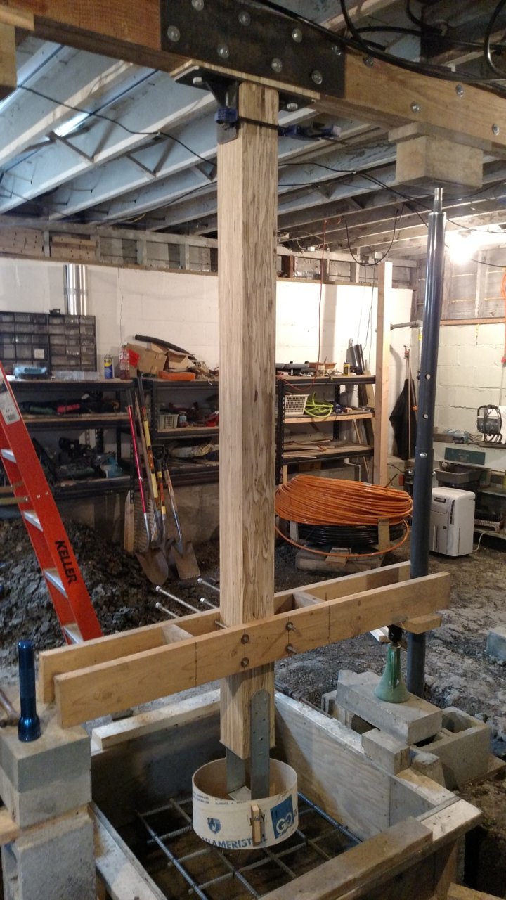

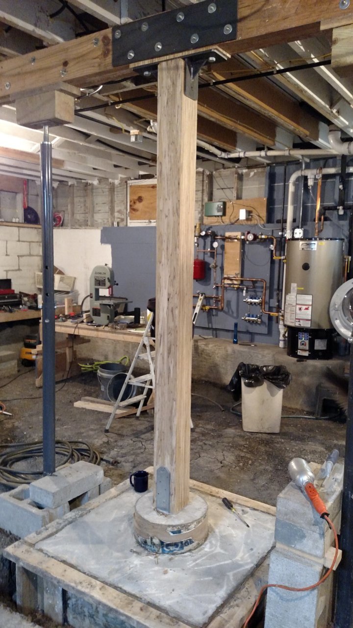

    column1.jpg column2.jpg My wife and I started back up on this project in the spring of 2014, after a 9 month break where I focused on regaining my health post cabgx3.
    We were quite ambitious, the goal was to remove our ancient furnace, brick out the chimney which would allow us to remove and replace the last column/footing in our basement. Additionally we needed to fabricate and install our first floor radiant heat system before winter hit. I got the radiant heating system up and running just in time, and it has been running really well.
    We are also going to install radiant in the basement slab, hopefully by the end of 2018. In the background of the photo you can see the roughed in radiant manifold/heat exchanger setup.

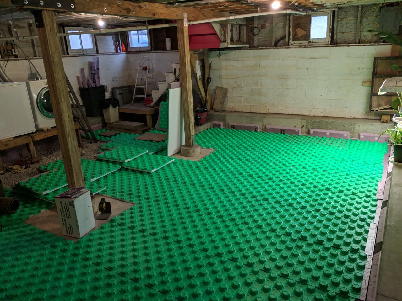

    Still plugging away on this project. We put in a sump pit along with perforated tile to handle any ground water etc. Then we carried in the gravel for the sub base and have just started compacting. Following the compacting we will put down a vapor barrier and 2" of insulation which has knobs built in so we can snap in our radiant tubing. Then we can finally start thinking about getting the concrete poured, hopefully sooner than later, just tough finding time. We installed all the green insulation to make all the cuts etc, then pulled it out for compacting.
