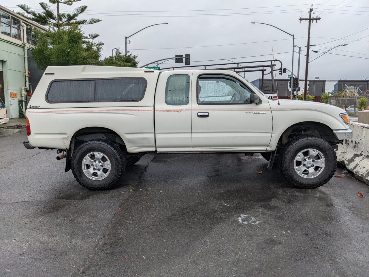

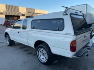

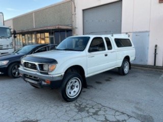

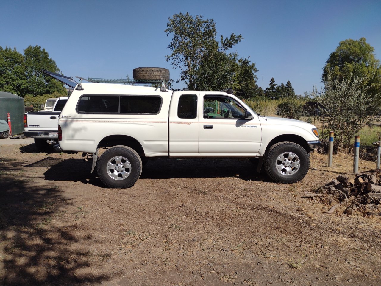

    Combined a later 1st Gen leaf pack with the existing to get the rear lifted:
    Leveled it out nicely with 5100's:
    Purpose: daily driver and dog hauler, weekend camper and explorer

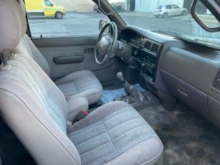

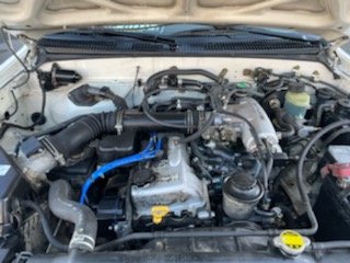

    Background: My work neighbors flip cars and when this thing came in I committed to buying it within an hour. It had a very clean engine bay, rust free frame, only 190k, manual locking hubs and a camper with a built out bed platform. It looked like it had recently been tuned up and was well taken care of. According to the title I might be only the second owner. The bed platform is covered with a padded shag carpet and looks professionally done. After a detail the interior and bed platform were dare I say like new.
    The biggest shortcomings are the suspension (stock) and gearing (3:58). The leaf springs were almost parallel with the ground and the front hits hard on the tinniest of bumps. The under gearing wasn't too noticeable with 225/75R15's but now that I've put on 265/75R16's it's very noticeable. Though, still the 3RZ-FE feels more "powerful" than either of the two 3.0's I've owned. Also, both bumpers are dented and bent. DIY front and rear bumpers done hopefully by next spring.
