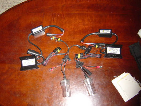

    No I dont think those are HIDs from how you are explaining, But I also cant think of any reason why there would be a wire with a fuse coming off of them. But just for refferance this is what a HID kit looks like.
    Also the 9003 style wire harness is very confusing!! OK lets see if I can explain without getting myself confused. It has power constantly it is switched on by the ground. But when you switch from high beam back to low beam it switches the grounds. Sorry so vague. This is what I ran into with my HIDs. they would turn on (low beam) then I would switch to high beam they would come on, but then when I switched back to low beam nothing. I would have to turn the lights completly off then back on to get the low beams on. So I had to use a relay and now they work fine. Sorry if I lost you but maby this may help out somehow.
