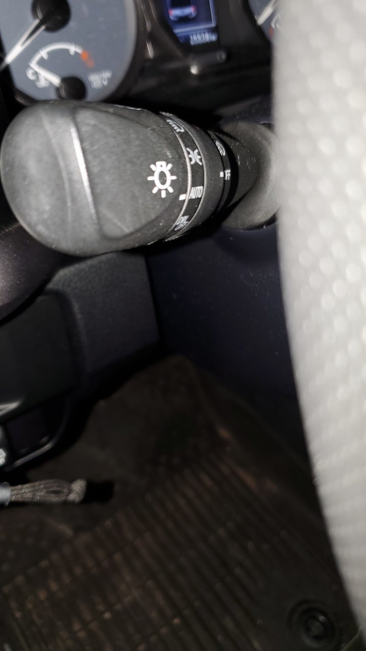

    Like on your stalk? Interesting.

    DRL Off, Auto, Parking, and Low Beams
