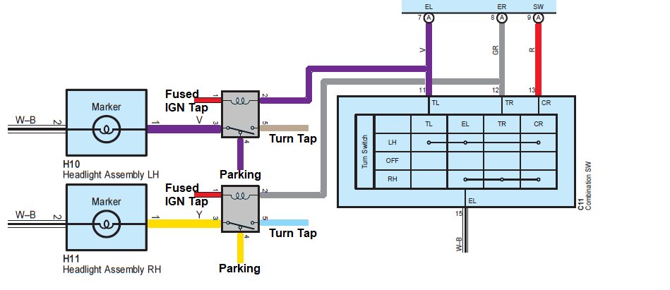

    5 pin mini relay
    pin 30 (3) towards Marker
    pin 87a (4) NC to Parking wire
    pin 87 (5) Turn Feed Tap
    pin 86 (1) Juice from fuse IGN source
    pin 85 (2) Tap to C11 (Light Stalk in Cab)
    Parking selected = juice to Markers via 87a & 30 (NC)
    Turn selected = Juice for coil is grounded vie tap to Signal Stalk, Markers flash via 30 & 87.

    So a general wiring question: Do you use diodes when you switch with ground? I always have as that is the way I learned it. Seem un-needed?
  9. Sep 11, 2020 at 8:04 PM
    #29
    caribe makaira
    caribe makaira Well-Known Member
    Feb 13, 2011
    #51121
    11,782
    Caribbean, Puerto Rico
    05 PreRunner TRD Offroad AutoTrans
    Hood Struts, My version Fogs always ON, Map & Overhead Light Mod,
    Not for this.

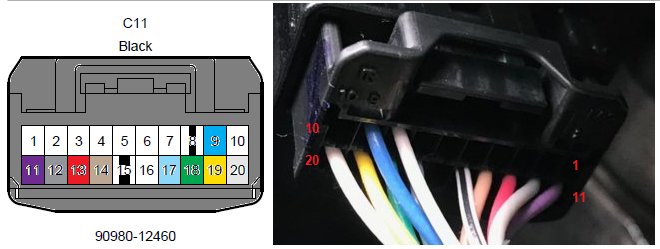

    Here is a question with an obvious answer: Do you have the full pin out for C11?
