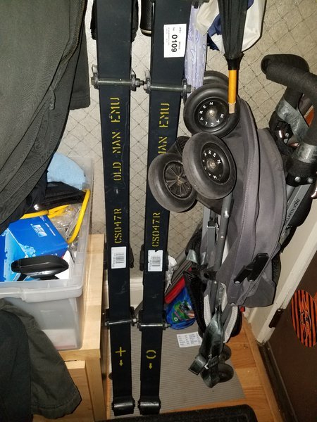

    I received the springs why does one have + on it and other one has () on it?

    + means higher spring rate than spec. Put it on the driver side. 0 means at spec.
