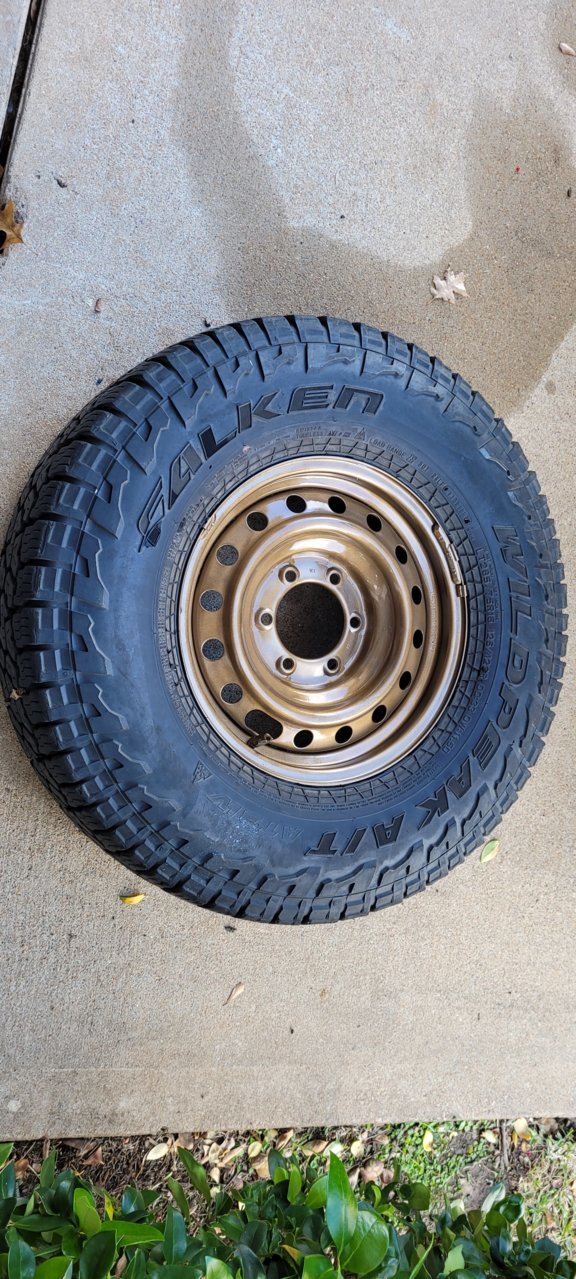

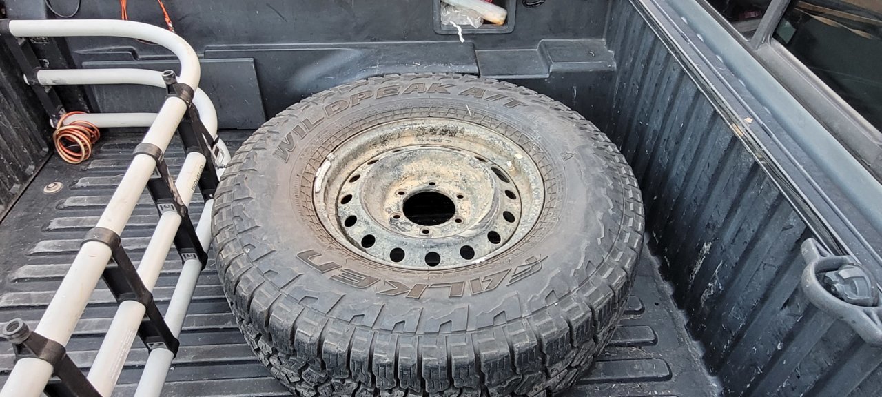

    I used a short needle nose pliers and used it as a lever. I reached in from the bottom from under the tire and got an arm in between the tire and frame.
    I'm relatively flexible and that was a pain in the butt. I wasn't going to delay getting my full size spare tire mounted and throwing on some paint to match the current wheel color

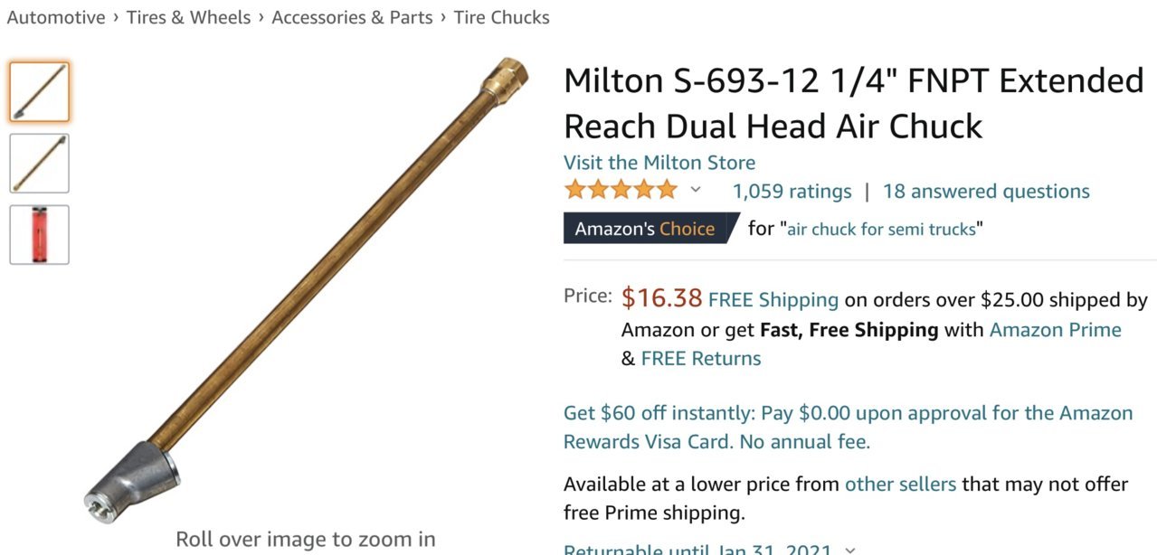

    I use one of these to go through the access hole in the rim. (It’s bigger, look at the photo above of the rim where the stem is located)
    Go through the hole, and pull down to air up.
    (The cap can be tricky if you have large fingers)

    I have one , but never thought to use it under the truck for the spare lol
    Great idea
