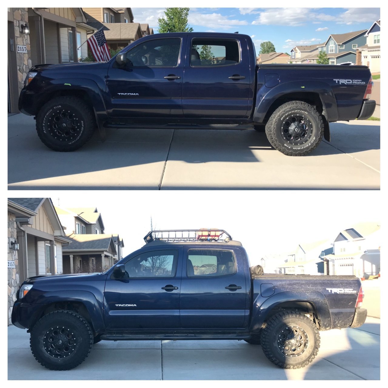

  17. Jan 9, 2021 at 11:24 PM
    #17
    buku556
    buku556 [OP] Well-Known Member
    Jul 11, 2019
    #298935
    46
    N. Colorado
    2012 DCSB TRD Off-Road
    885 OME Springs Bilstein 5100 shocks Wheeler’s AAL 2”
    It has been done! 2” lift installed this summer and last week got 255/85R16 Maxxis Bighorns. Photo pre lift and old tires (265/75R16) vs now.
