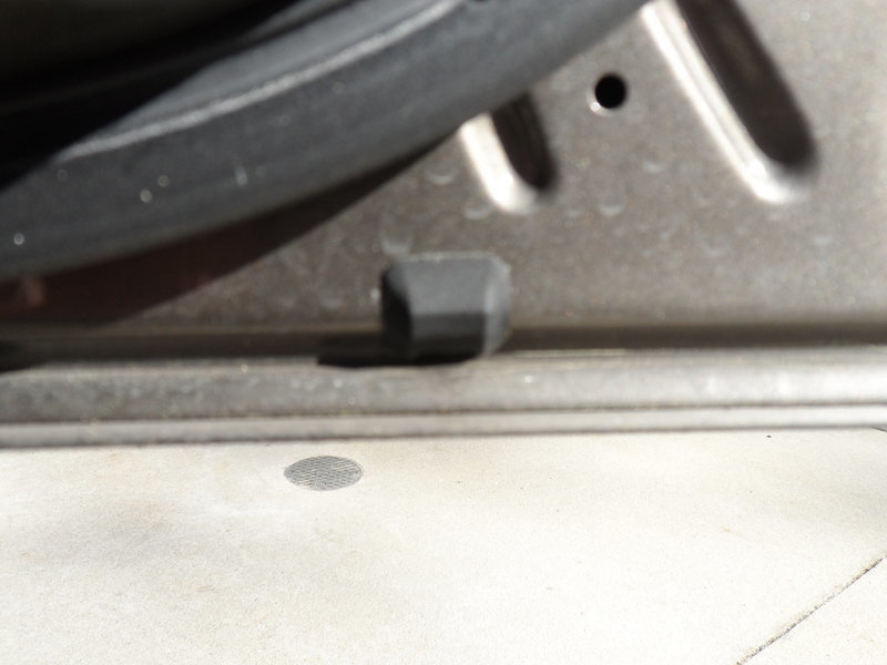

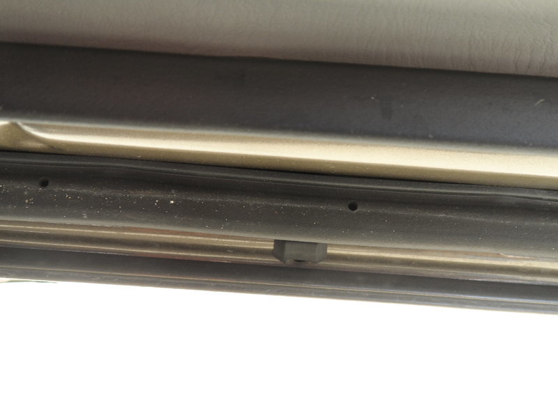

    Here's a couple of pics from the bottom of the doors on a 2014, they actually have some holes in the rubber inserts.

    Thanks for taking the time to post some pics!
