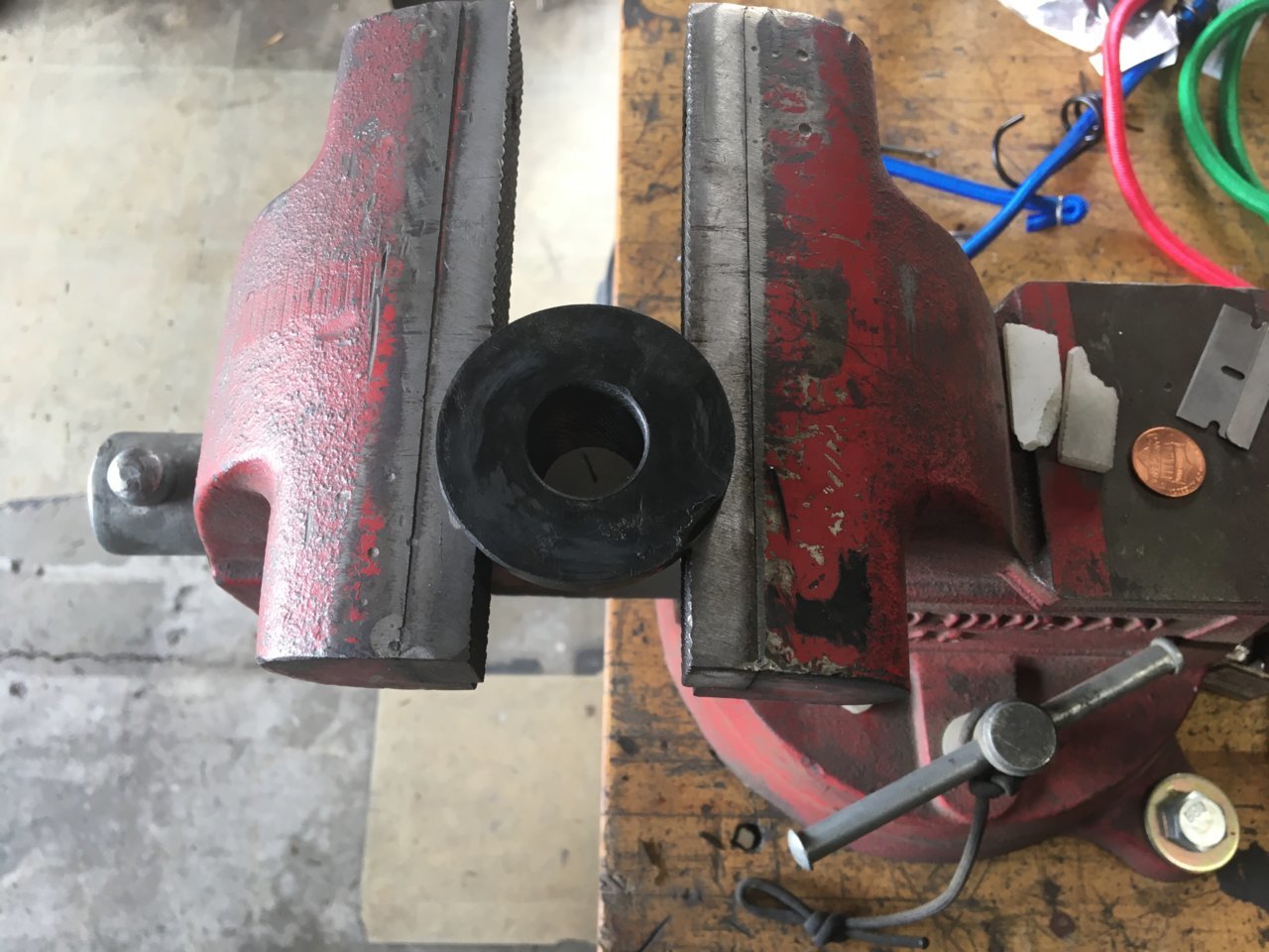

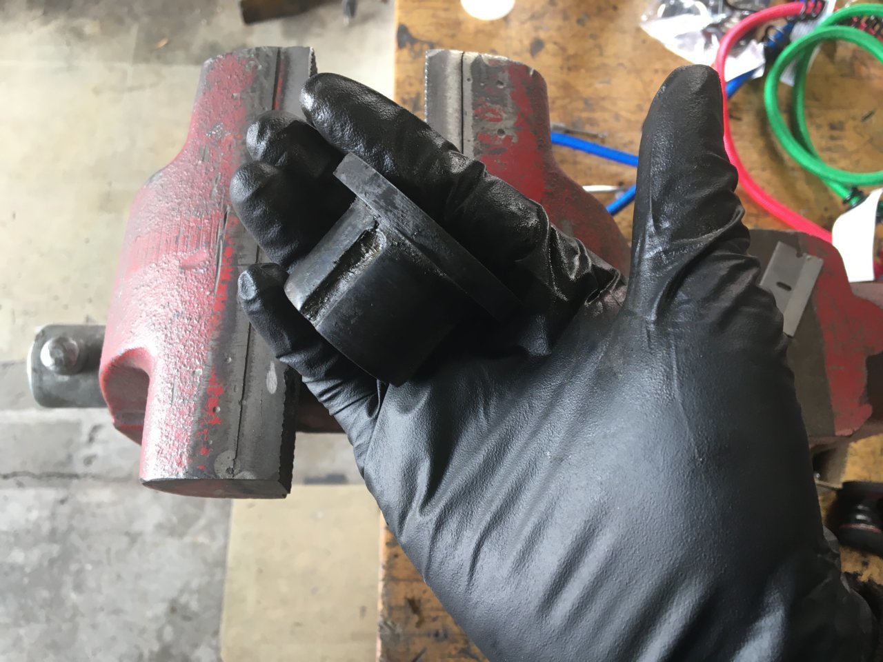

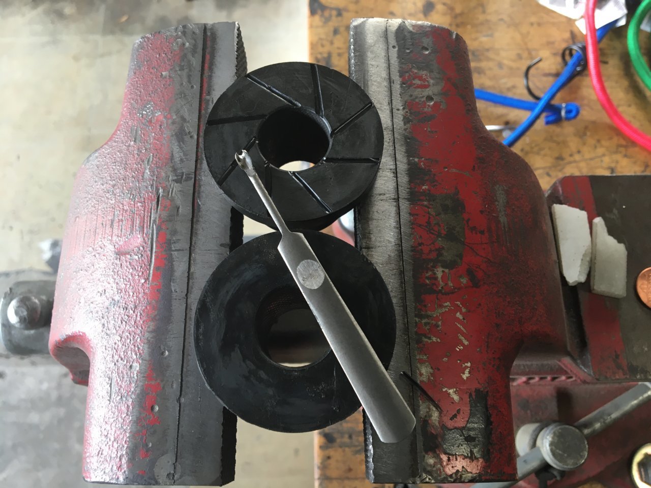

    Good question, Ghost Ship. I was getting an annoying squeak from my leaf springs- the front bushing specifically. I have a thread about upgrading the preinstalled bushing that comes in Dakar leaf packs (which is now obsolete since they come with polyurethane bushings). I replaced my bushing with Wheelers bushings and then again to Dobinsons bushings some time last year. One thing to note is that the Dobinsons bushings have a thicker shoulder which makes them fit tighter in the stock frame hanger up front. Sounds great, right? Well the tighter fit squeezed out all the grease I had previously applied to the bushing and I was getting an annoying squeak that made my truck sound like it had mid-70s Chevy suspension. Having known about the siping that some bushings have to keep grease in place, I saw no need to get new bushings if I could add my own siping. I resorted to my leather craft tools and found something that would work. Here are the comparisons and results.
    Stock siping in the bushing barrel:
    Stock bushing face, pre-mod:
    Comparison after the mid and the leather tool I used:
    I think it worked but time will tell. I had a nice quiet ride around town after the install but I’ll be keeping an eye on longevity of the “upgrade”.

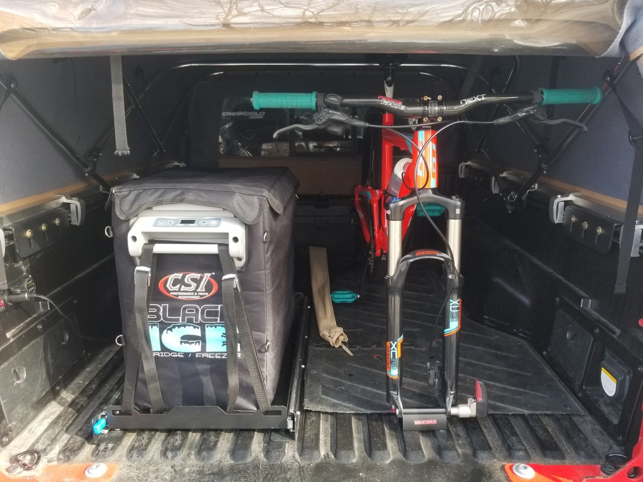

    Sergio I need some type of outboard bike mount. Tubing is 1.75 hook a brother up

    I'm good now Sergio I just lock it up in the bed with a lockable fork mount.

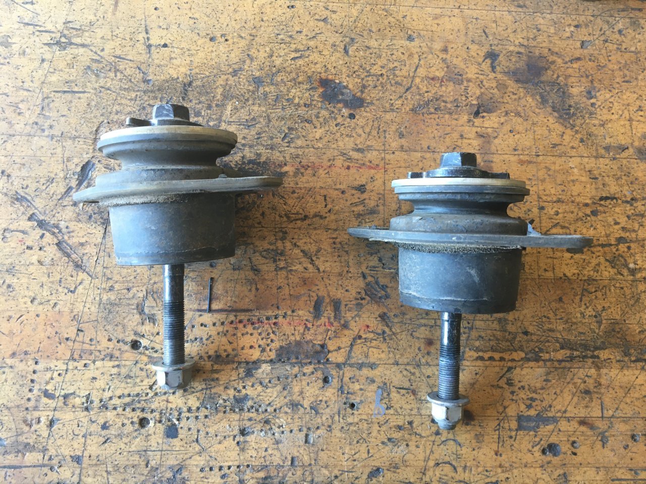

    Anyone need some stock body mount bushings? I pulled these off a 2019 so super low miles. Should fit 2nd gens as well if I’m not mistaken. Free, just pay shipping or come get them. They’re trash in a week.

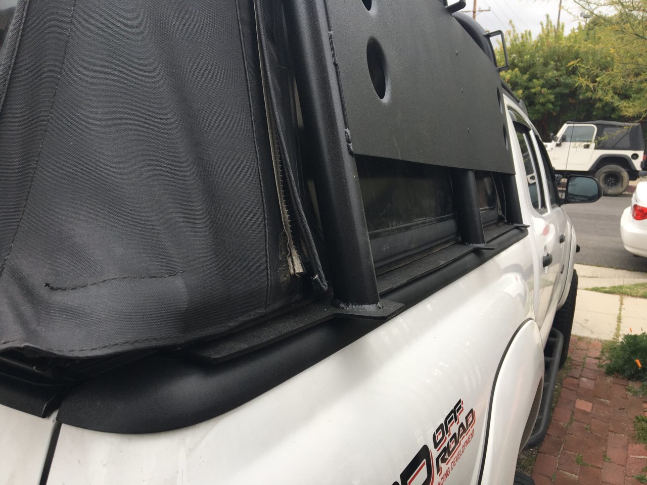

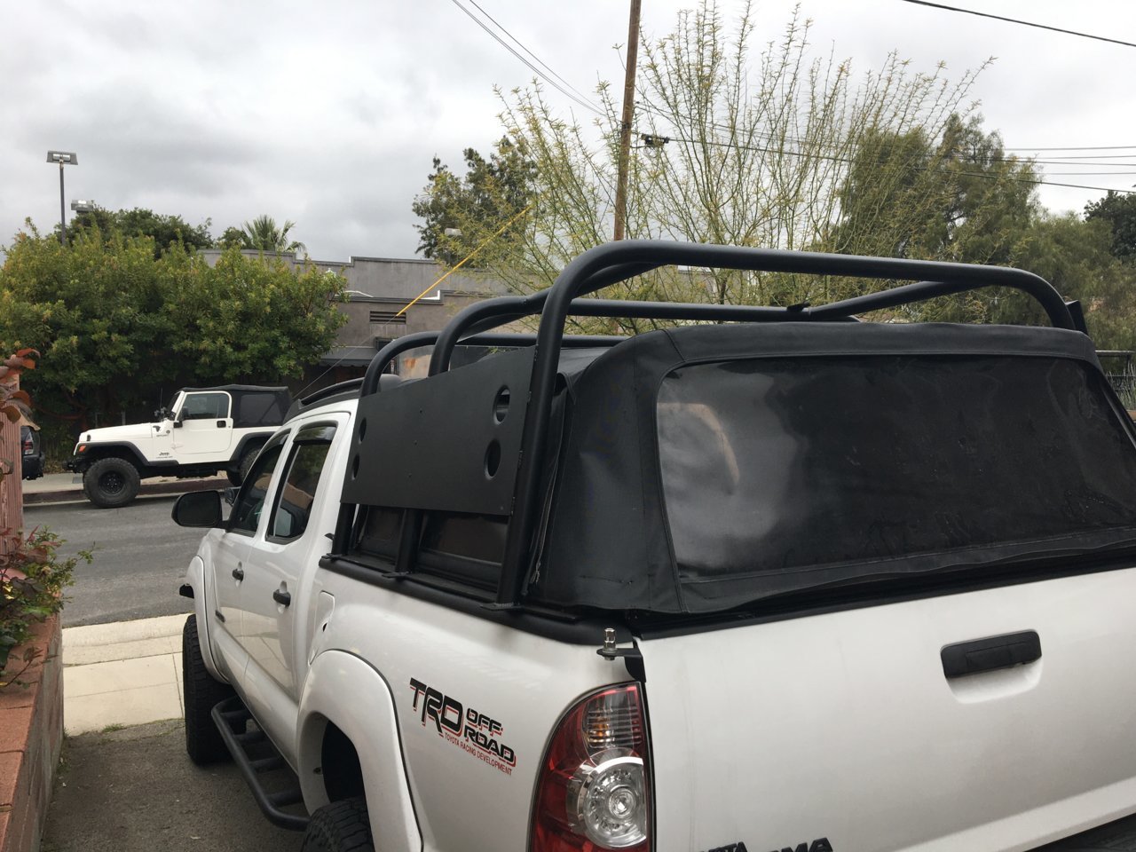

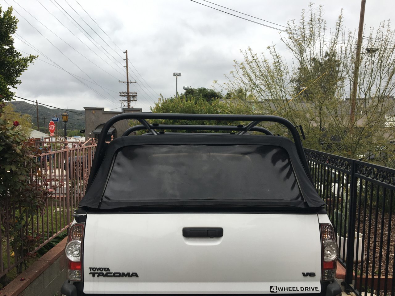

    Over ST bedrack completed. Looking good up there.
    Detail of the full length mounting plates. This helps retain the seal of the topper without leaving weird gaps.

    Is that high enough to fold the top down?
  19. Apr 5, 2020 at 1:21 PM
    #379
    GHOST SHIP
    GHOST SHIP [OP] hates you.
    Mar 9, 2015
    #150537
    22,398
    GHOST
    No. The topper needs almost 12” of additional clearance to be able to fold down. While it can be built, at that height the rack just looks really goofy. An option would be to make a removable top section for the rack but that would still make it a pain to fold down the topper easily IMO with the addition of extra bolts/tools needed to fold it down.
