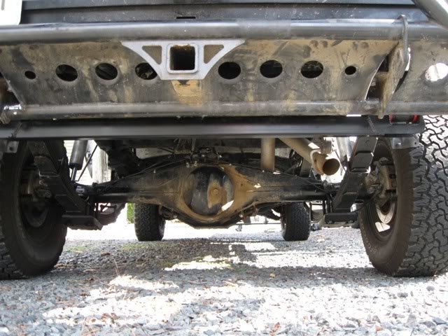

    Anyone running this setup? Comments/reviews on operation and install?

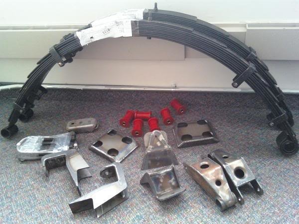

    Tacoma 2005-2008 64" Long Travel Leaf Spring Kit
    Capable of up to 21" of Travel!
    Kit Includes:
    Exclusive 64" triple wrapped race spring
    Front and rear mounting brackets
    Shackles
    Protective ubolt bash plates
    Axle spring perch
    9/16" ubolts
    All necessary bushings
    The all new Tacoma 64", 21" travel spring kit is available in a bolt on version that makes your installation even easier.
    Price: $1700
    Available for:
    2005 - 2008 Toyota Tacoma
    Check out our custom bypass shock setup for all long travel spring kits - "Giant Motorsports Link Killer"
    Link Killer 2.5 shocks are available in black anodize.
    $1375 or 3.0" for $2050
    Tacoma Bolt in Bed Cage
    The new Tacoma bolt in bed cage has a space saving design for cargo and comes with tire mount that that is positioned so you can fit a dirt bike.
    Price: $1850

    Pretty serious setup and I am between this and the Defined Engineering kit. And since you are a prerunner keep in mind you will need a slip yolk in your driveshaft with these systems.

    There is a red Tacoma from Team Shark Attack that used to race SNORE that ran the DMZ kit. MJP2 does run this Giant 64" kit.
    No. Not much is when you get to this level. You are going to have to weld in plates to box your frame etc to keep it from bending if you run this kit. Weld shock mounts and limit straps as well. Its a never ending cycle:D

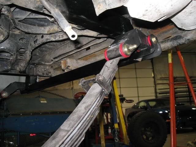

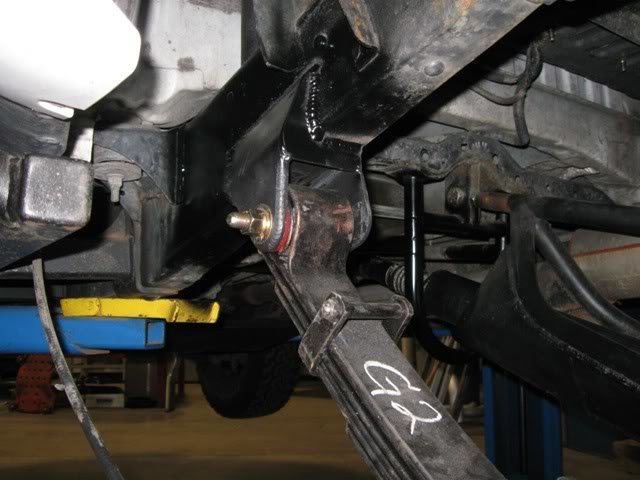

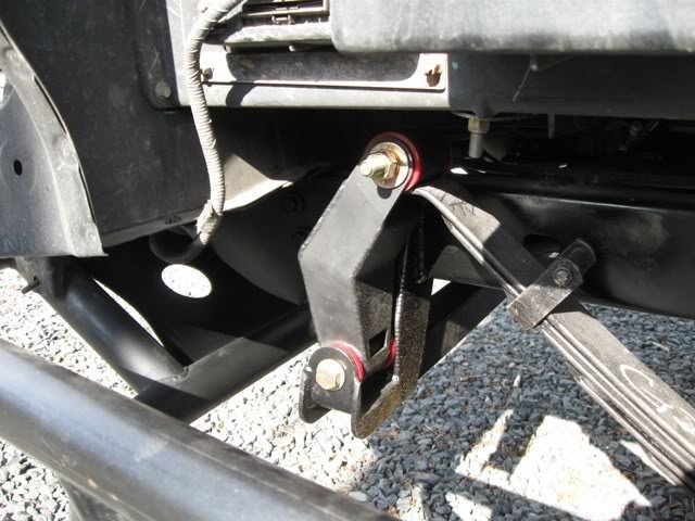

    I have an early version of this kit from before it was offered as a bolt-on setup. Geoff at Giant makes a solid product and he's one of the nicest guys you could do business with.
    On my truck the suspension sits at about stock height, but with 2 batteries, 60 gallon fuel cell, 2 spares, and jack in the bed area I'm heavy in the rear.
    The ride is nice and the parts are stout. I tied the rear hangers together for added strength. It's a good idea but unless you're racing it's not something you'll need to worry about.
