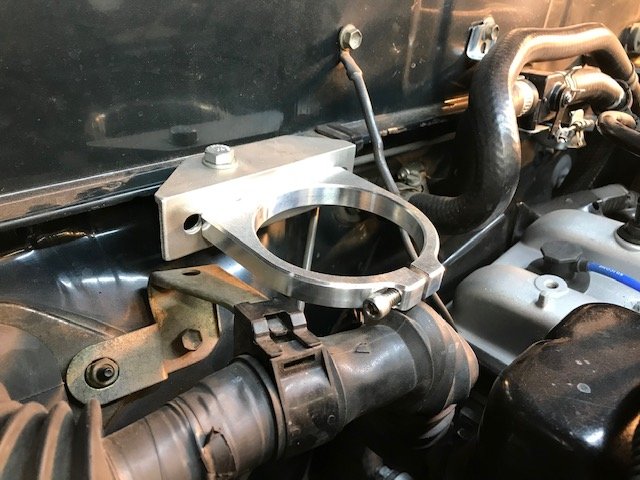

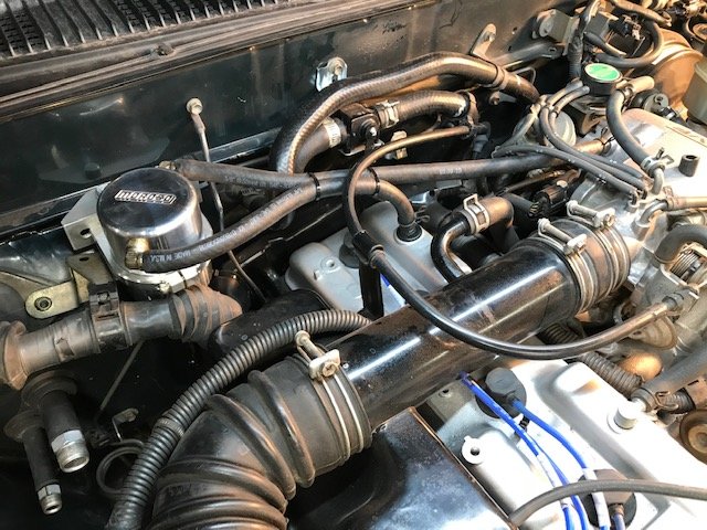

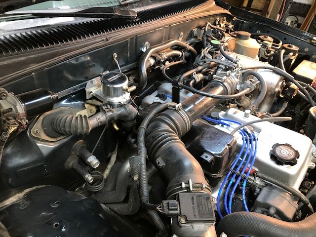

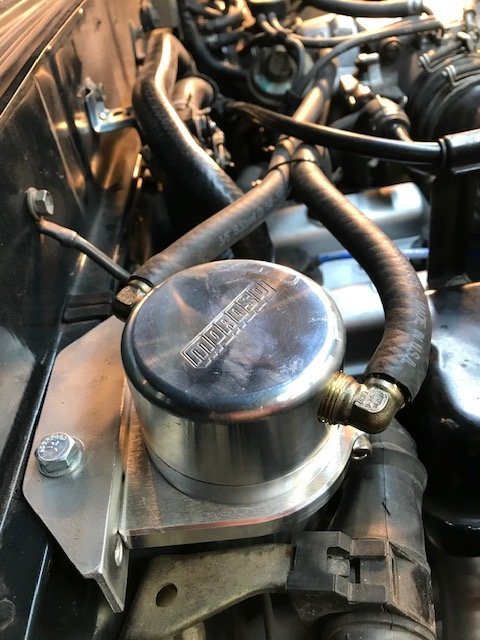

    During the re-assembly and installation of my engine I spent quite a bit of time cleaning the intake manifold and upper plenum, I was really amazed how much crap there was inside and wanted to prevent anything else from entering my new motor. I just did the 500 Mi oil change on the new motor and will check on it at 3K miles. Hopefully it will keep crud out of the upper plenum and throttle body.

    Yes, its hooked up. On the bottom of the can there is a ball valve to release any excess/build up that may be present.
