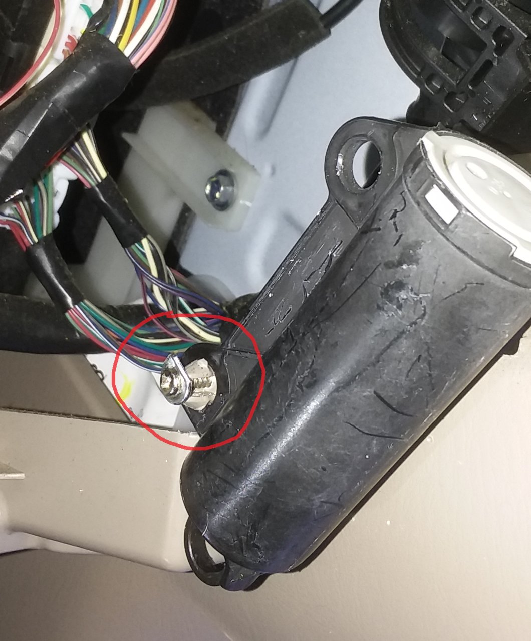

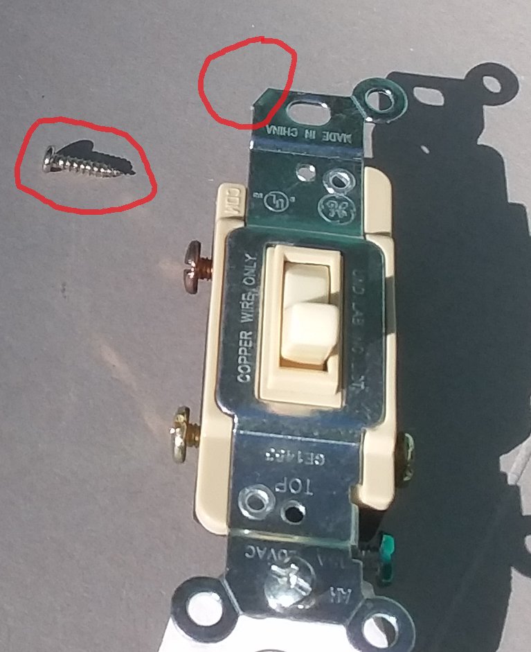

    My 2008 Tacoma has not had this problem... until today! While installing the cabin air filter for the nth time the piston fell off the dash nub and wouldn't stay on. I read all the solutions but wanted something a little more permanent. I did use a screw to spread the barbs on the dash nub. I also drilled through the slot of the nub with a 5/64" bit. I used a small screw and a lug from a duplex receptacle as a washer. It went together nicely and is holding great.
