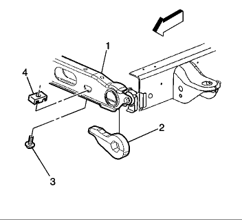

    Here's a pic of some parts so you can get an idea of what you're working with.
    1- torsion bar crossmember 2- key 3- adjustment bolt 4- bolt keeper
