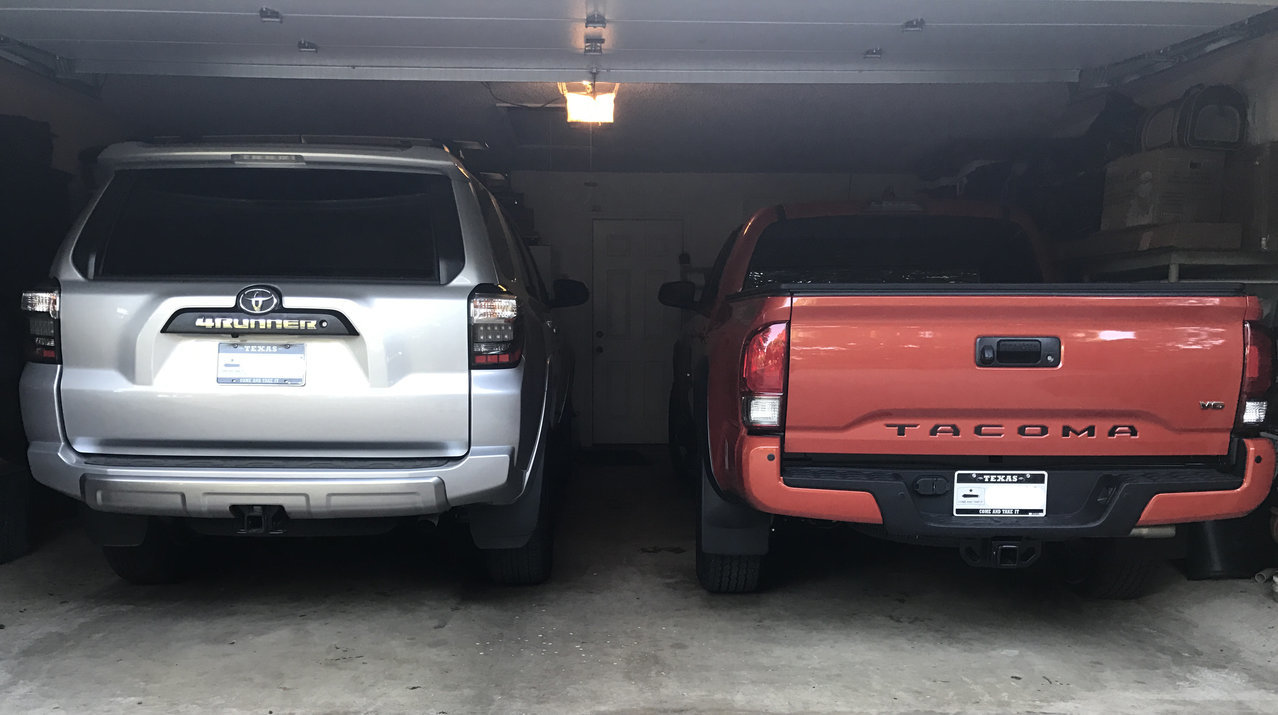

    Hey Tacoma World hivemind.
    In came the 2016 Tacoma TRD Off-Road with Tech Package.
    This is how it sits as of right now. Really the only thing I have done since delivery is plasti-dip the front grill (what were you thinking Toyota?).
