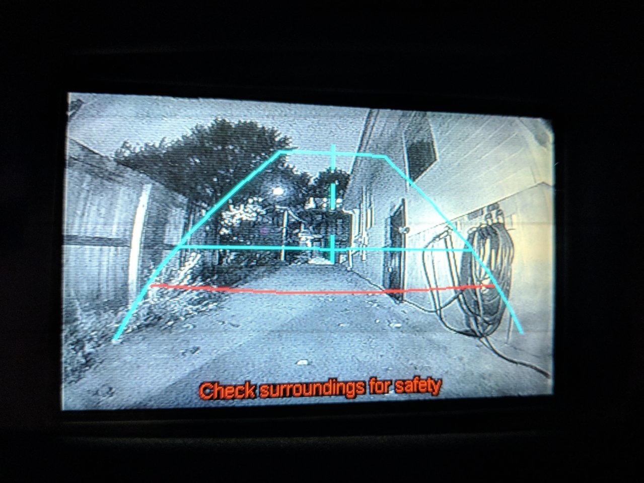

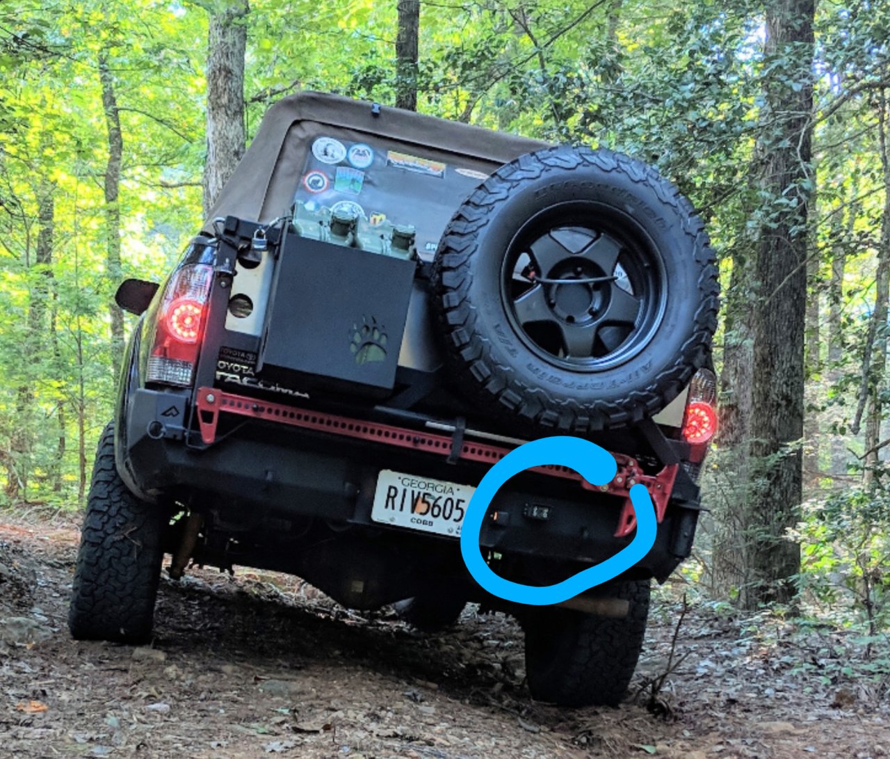

    Here's one... If you have a swing out blocking the rear camera and your view, I bought a camera that plugs right into the existing wiring harness. This thing is rock solid and gives a great image. No issues so far and I wheel every weekend and the truck goes swimming a lot. It is mounted to my bumper, but mounting it to the extrusion would be a great idea. Here is the link -> https://camera-source.com/2010-2015-toyota-tacoma-camper-camera-kit-plug-and-play.html IMG_20180925_070422-01.jpg 1549456371.jpg
