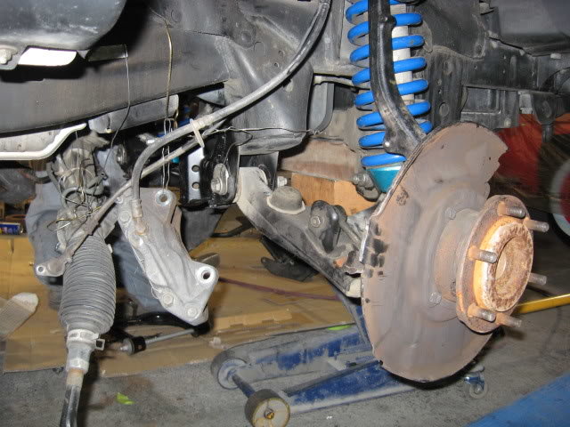

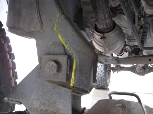

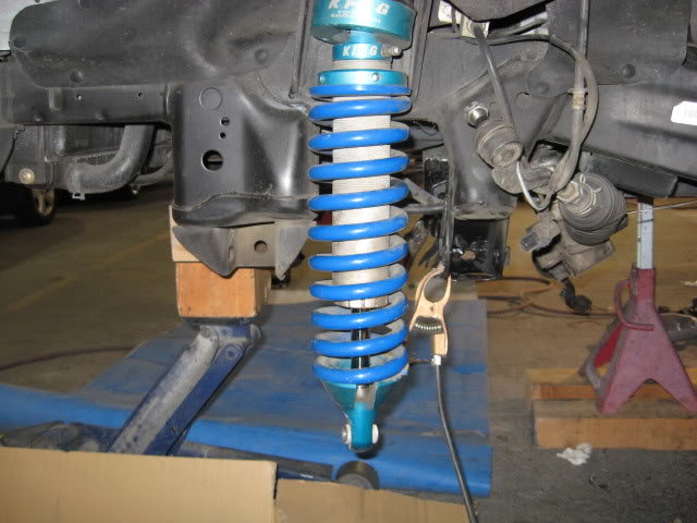

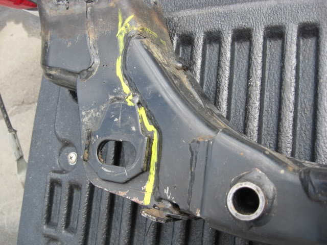

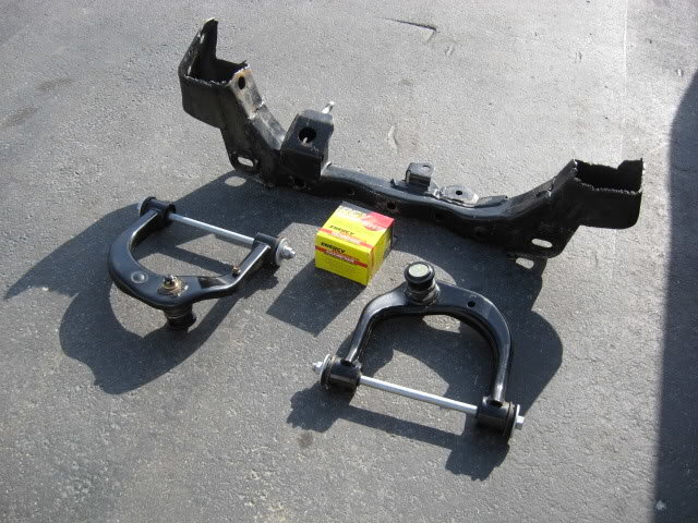

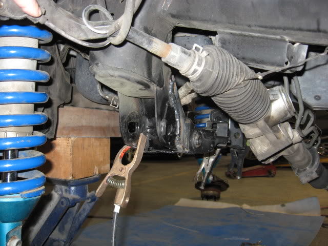

    As some of you may know, Im getting rid of the POS TM 6" drop bracket lift on my gen 1 (03 Pre Runner 2wd) 9 out of 10 people have told me "It cant be done" Well, it can. Work started yesterday:
    Parts:

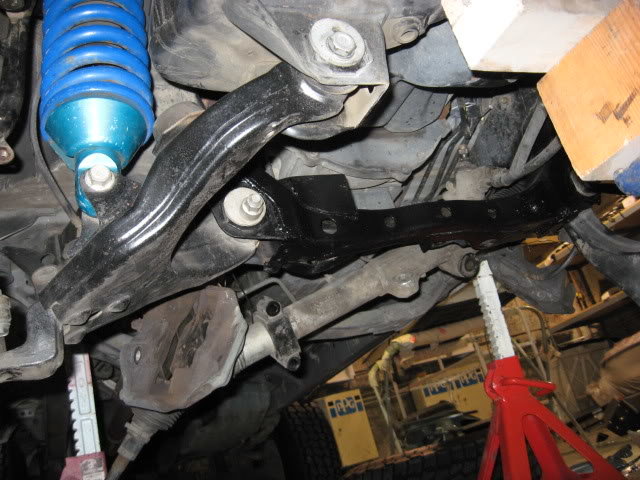

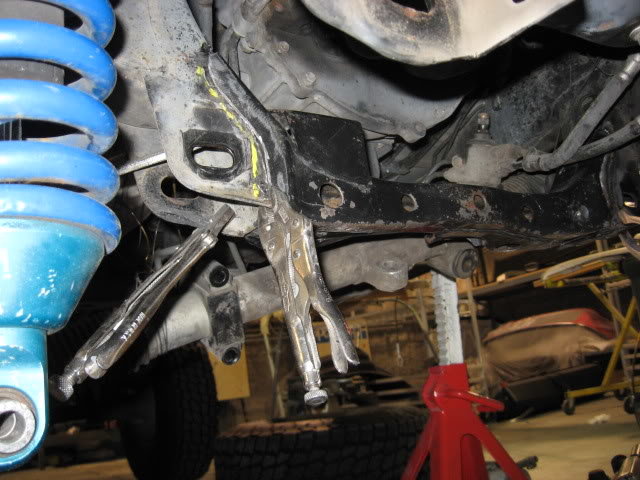

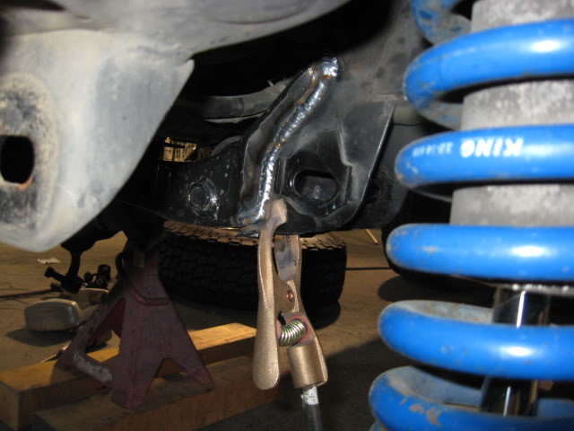

    The crossmember will be cut/trimmed here @ factory seam:
    The truck will be trimmed/prepped same spot:
    These are were measurements are taken w/tram gauge.
    More to come

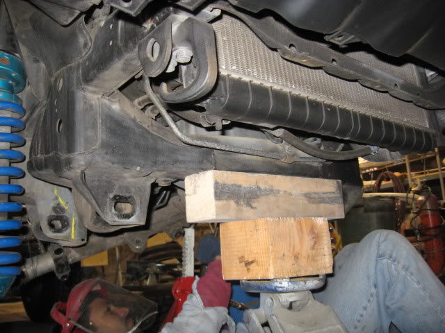

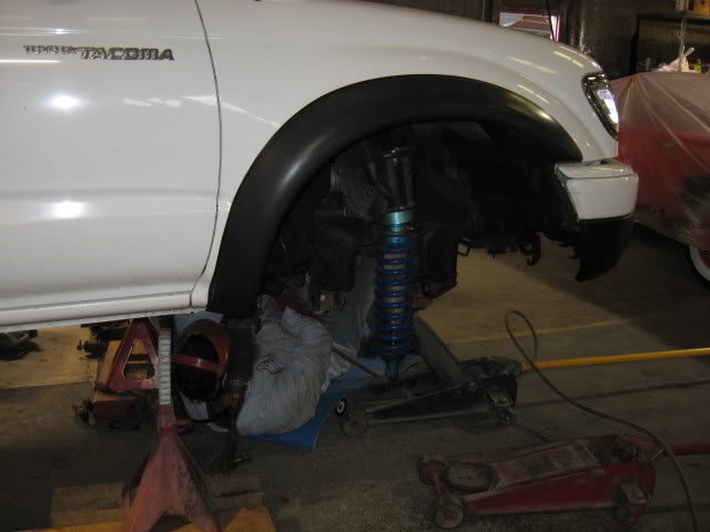

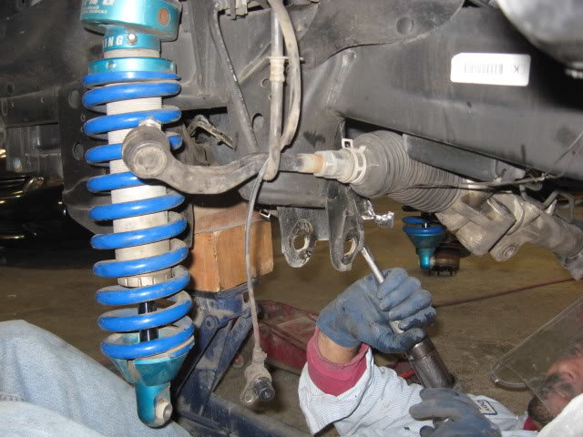

    Thursday 4/21/2010:
    The "fun" has begun:
    Prep/clean frame

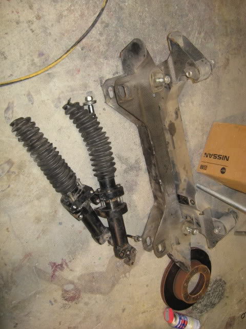

    Kit is gone

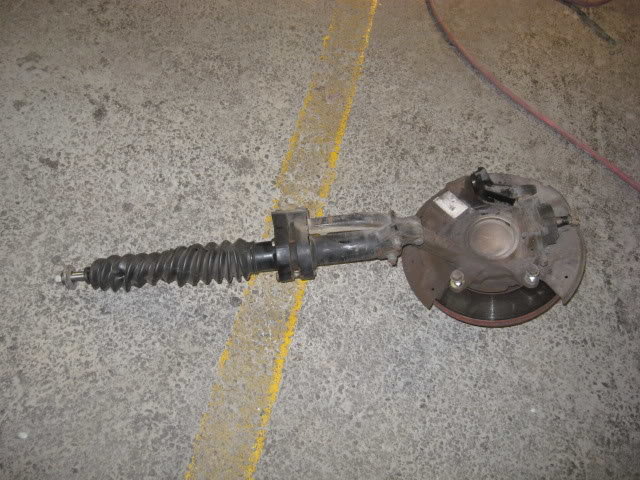

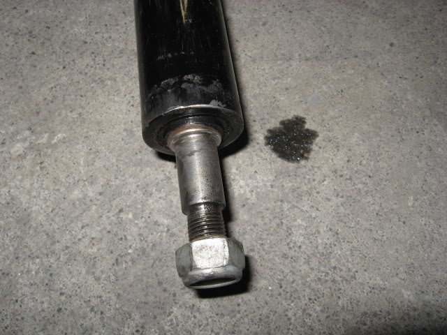

    POS TM struts BLOWN/leaking:
    as it was, and never will be again :)

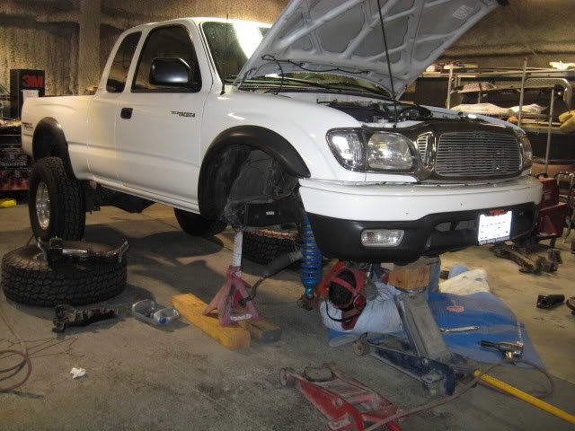

    Its going quite well....

    $hit Kit:
    Man, I "hope" its straight! lol :D :welder:

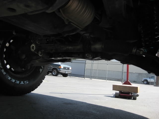

    3:00pm same day. Going back together....

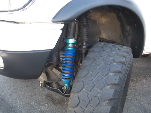

    Is your King shock bent? It looks bent in a few pictures... :confused:

    I was always under the impression that Prerunner's don't require the cutting of the xmember thus allowing you to be able to go back to stock?

    No, the top bracket is seperate, and swivels. There is a thru bolt you cant see in pics. Basically that shock will work on many trucks. You just have to get the correct top bracket for your apllication. Not bent

    Yes, this true if Fabtech kit is used, but this was the POS Trailmaster kit. It requires cutting #2 crossmember on both 2wd & 4wd. The TM kit also eliminates UCA's adding a 2nd strut(!) in its place. Its a TERRIBLE lift kit.

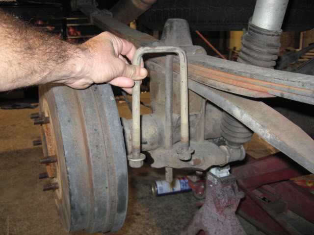

    Im working on the rear today. Losing the 2.5" blocks, but keeping the AAL's. Hoping the Bilsteins will work OK too. My 315's are getting swapped for 285's today as well

    OK, Im done!! Truck is at alignment now. I'll have it back to me Sat AM. Will get pics then.

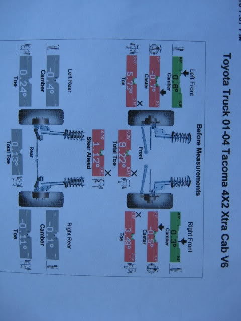

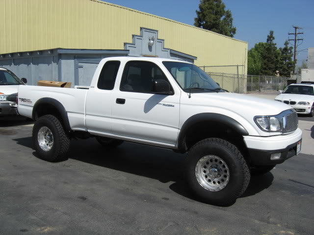

    Just back from alignment. Heres a complete pic. Same wheels, no spacers, 285's instead of 35's. Best off, no more DB kit
    Hytenor: Align specs before
    Align specs after:
