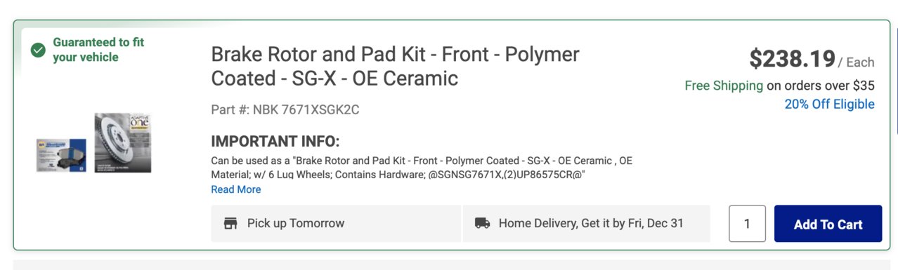

    I JUST did my fronts last week with all NAPA's best.
    Wanted the BEST rotors since the cheap ones ALWAYS warp and give you the "whump-whump-whump" when you step on the brakes.
    Pics below of the parts. I ordered most of the parts in several orders since the NAPA website gave you $20 off every order of $75 or more, so I split up my order and ended up saving $80! (I bought 555 LBJ's & front sway bar ends too).

    Lol any rotor always warps, not just cheap ones. Feel free to search other forums. Tons of people agree cheap rotors are just fine. It's just a hunk of iron. I've run cheap rotors on every car I've owned for the last 15 years and never had an issue as you describe. To each their own.

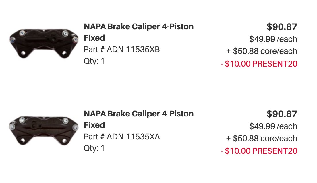

    Consider doing the 1st gen Tundra caliper and rotor upgrade. Best mod ever on a 1st get Tacoma IMO.

    Before you spend the money for the upgrade, know that you will need 16" or bigger rims in order to clear the larger calipers.

    15 inch wheels will not work with the Tundra brakes. Caliper is too big.

    Quite a bit too big. Some 16 inch wheels don't even work. That's an aweful lot of grinding. Even if you could grind enough off, I just think it's a bad idea to do that much (and that kind of) modification to things that can kill you (or someone else) if they fail.
