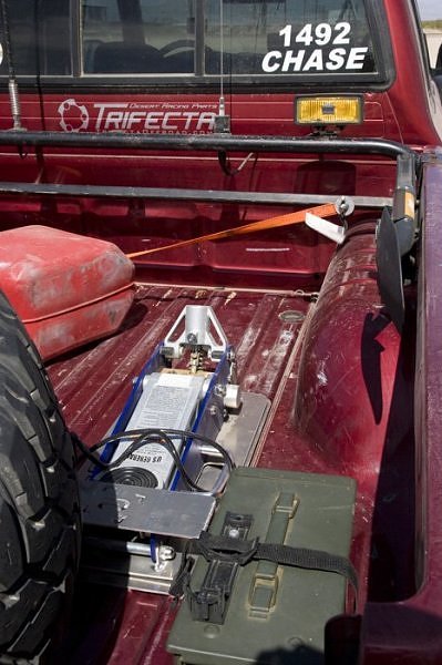

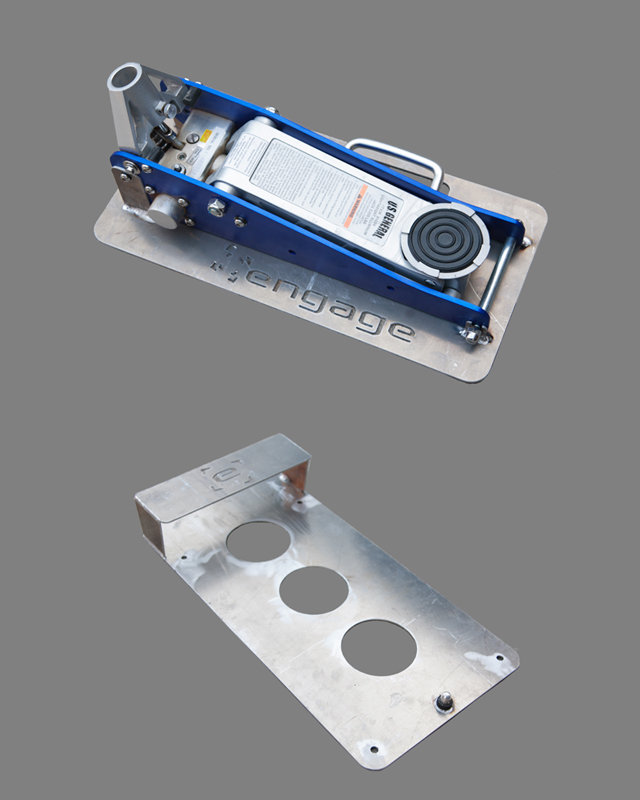

    we run the harbor freight aluminum floor jacks in the beds of our race trucks and daily driver chase trucks...
    they are a lot easier to pull out of the bed as they aren't as heavy and cumbersome as the bigger shop style floor jacks...
    for the back, we lift from under the differential... for the front, we either put a big block of wood to lift from the crossmember, or for simple tire changes, under the lower control arm...
    here is mine...

    Mike: I like the what You guys did with the plate.

    thanks!

    Now that is a pretty cool idea for your jack!:thumbsup:
