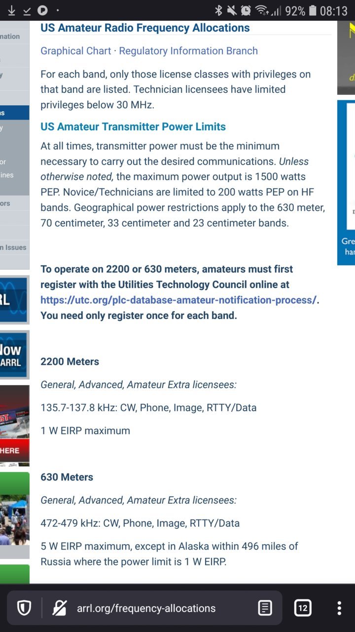

    (Ham Technician license is max 1500 watts on VHF/UHF and 200 on HF
    http://www.arrl.org/files/file/Tech Band Chart/US Amateur Radio Technician Privileges.pdf)

    Where are you getting 50 watts for technician?

    It was in reference to more of a mobile radio setup for the truck. Thats all I can find when I shop for vehicle mounted units. Sure the license gives you much more transmitting power but in a vehicle 50 watts is bueno
    ill amend my post above
