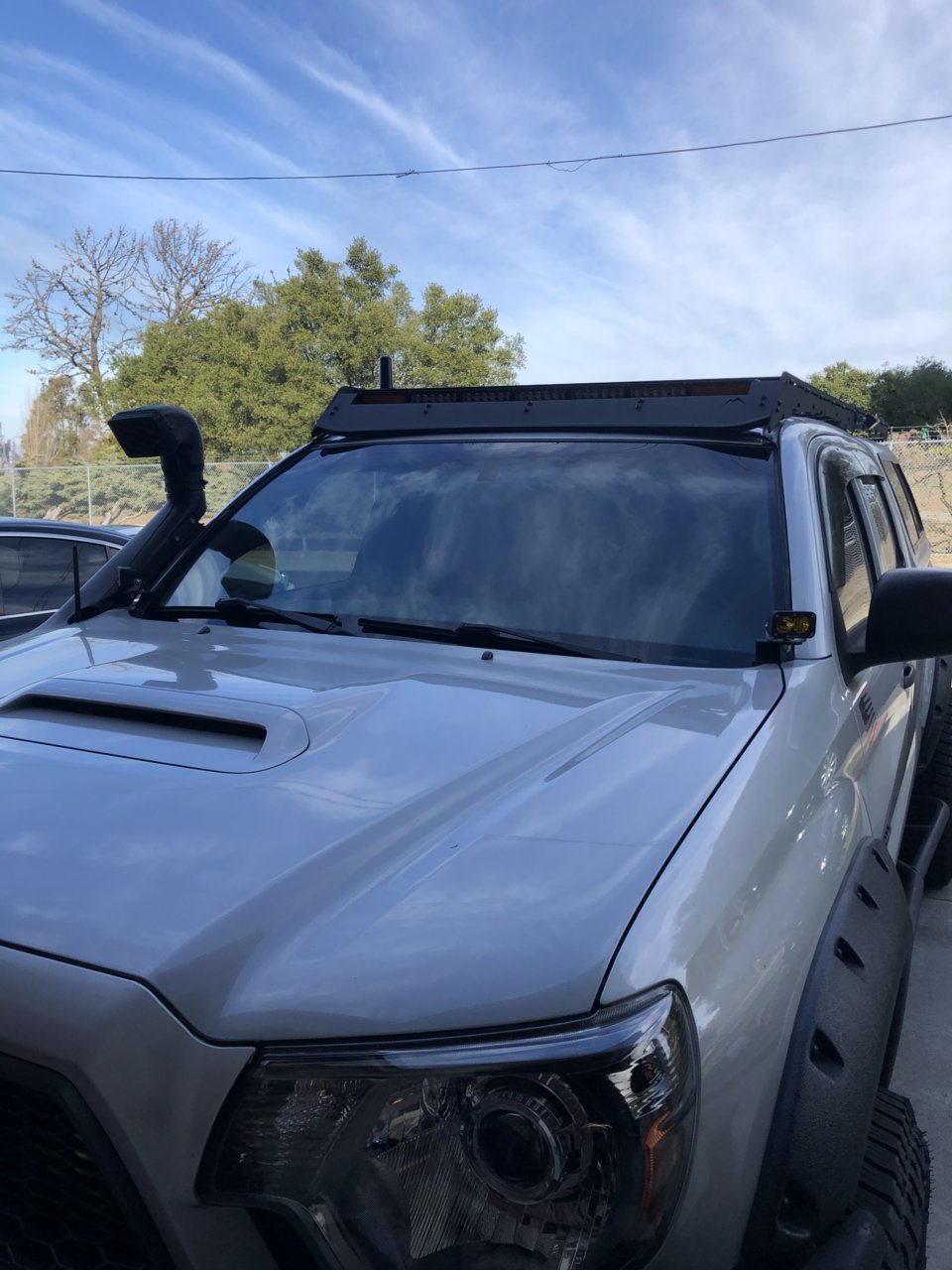

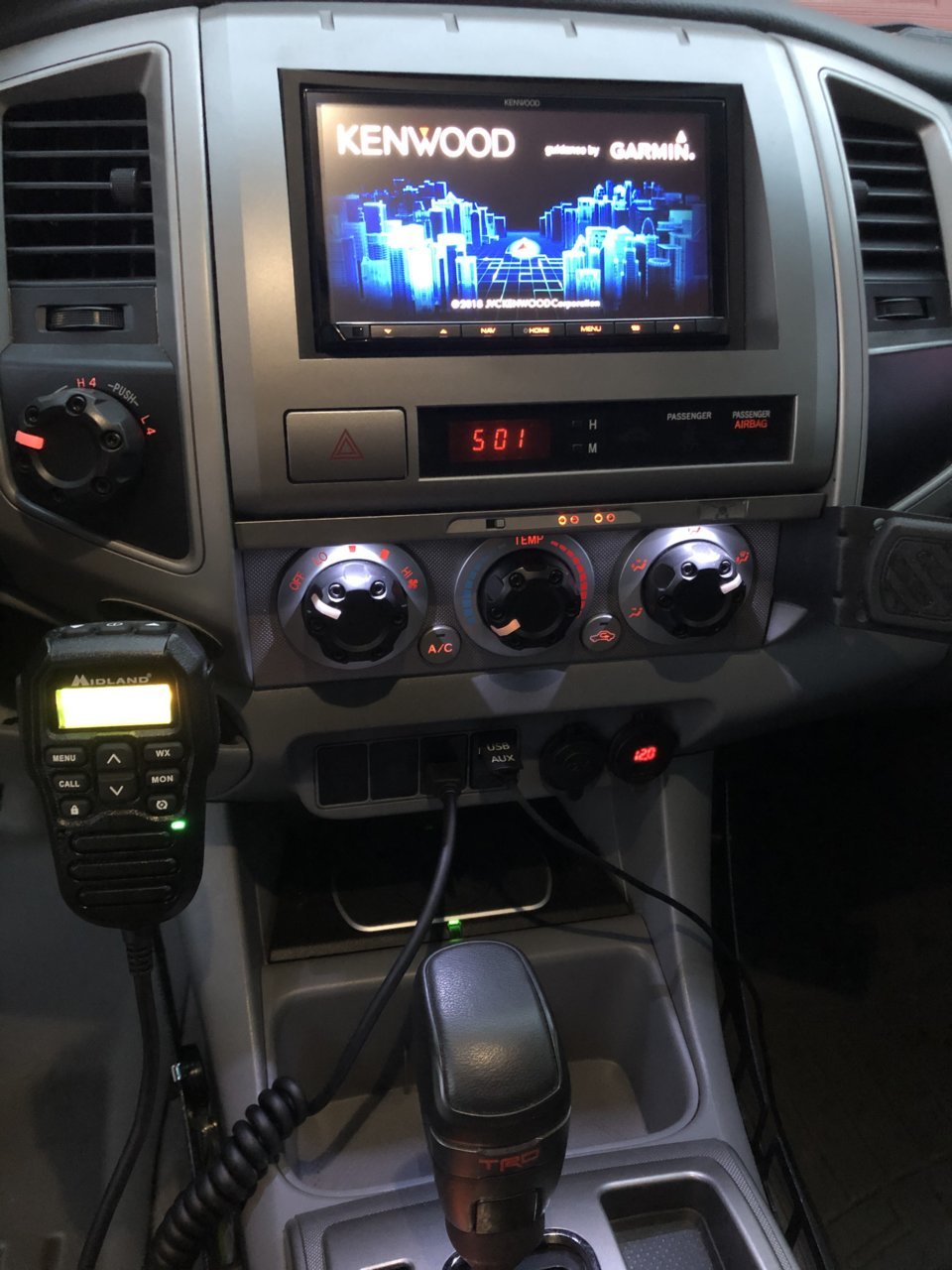

    Of course. The base is tucked behind the cup holders. 12v plug is cut off and extended the power wire to the engine bay auxiliary fuse box. A ethernet extension is ran to a rj45 switch blank and can detach the mic when not in use. Also ditched the included antenna, went with their low pro cable and ghost antenna mounted to the roof rack.

    Clean install! That's what I'm going for. Which fuse did you tap into?

    It is best if you run straight to the battery unless you have an auxiliary fuse box installed. I wouldn't hack into a fuse box. I'll have to find some photos of my install.
    The ghost antenna is a big compromise in gain. You would have better tx/rx with a real antenna.

    I didn't as its connected to a blue sea auxiliary fuse box in the engine bay. I wired in a traditional blade inline fuse and removed the glass tube fuse that was originally on the wire. You can wire straight to the battery.

    Where’d you get the light panel that’s mounted over the climate control knobs and under the radio bezel?
