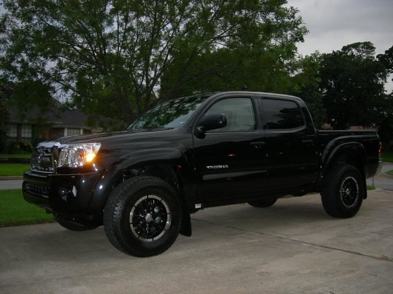

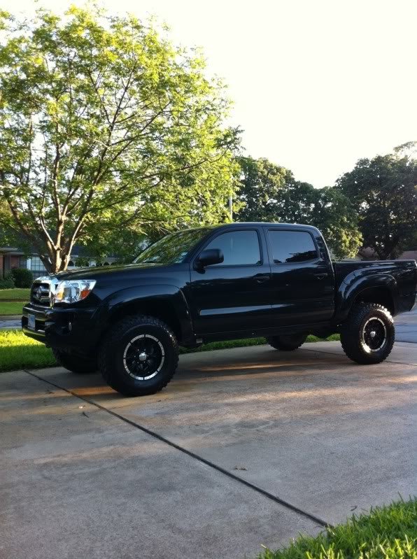

    I did 885 springs and the back sits higher. I will be ordering the 1/2" top plate spacer to make it sit a little more level. The back will still be a little higher. Get a quote from trdparts4u.com. They were great to deal with.
    You will need 4 new bushings for the rear mounts on the leafs. Put some antisieze on them and use 2x4 blocks to hammer them in.
    This is the only pic I have after the lift on level ground.
    This is before.

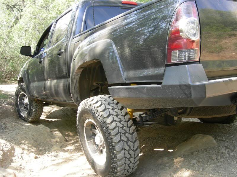

    very good information, gives me a lot more confidence in doing it myself. now looking at your rear bumper, i want one too, well maybe after my lift. lol

    I am telling you it really is not that hard. You can do it if you have confidence and follow the directions online.
    The bumper was added due to the stock suffering damage as well as the lower part of the rear fender.
