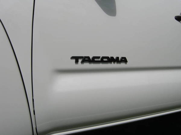

    Are you wanting them black?
    Like this?

    Yup just like that
