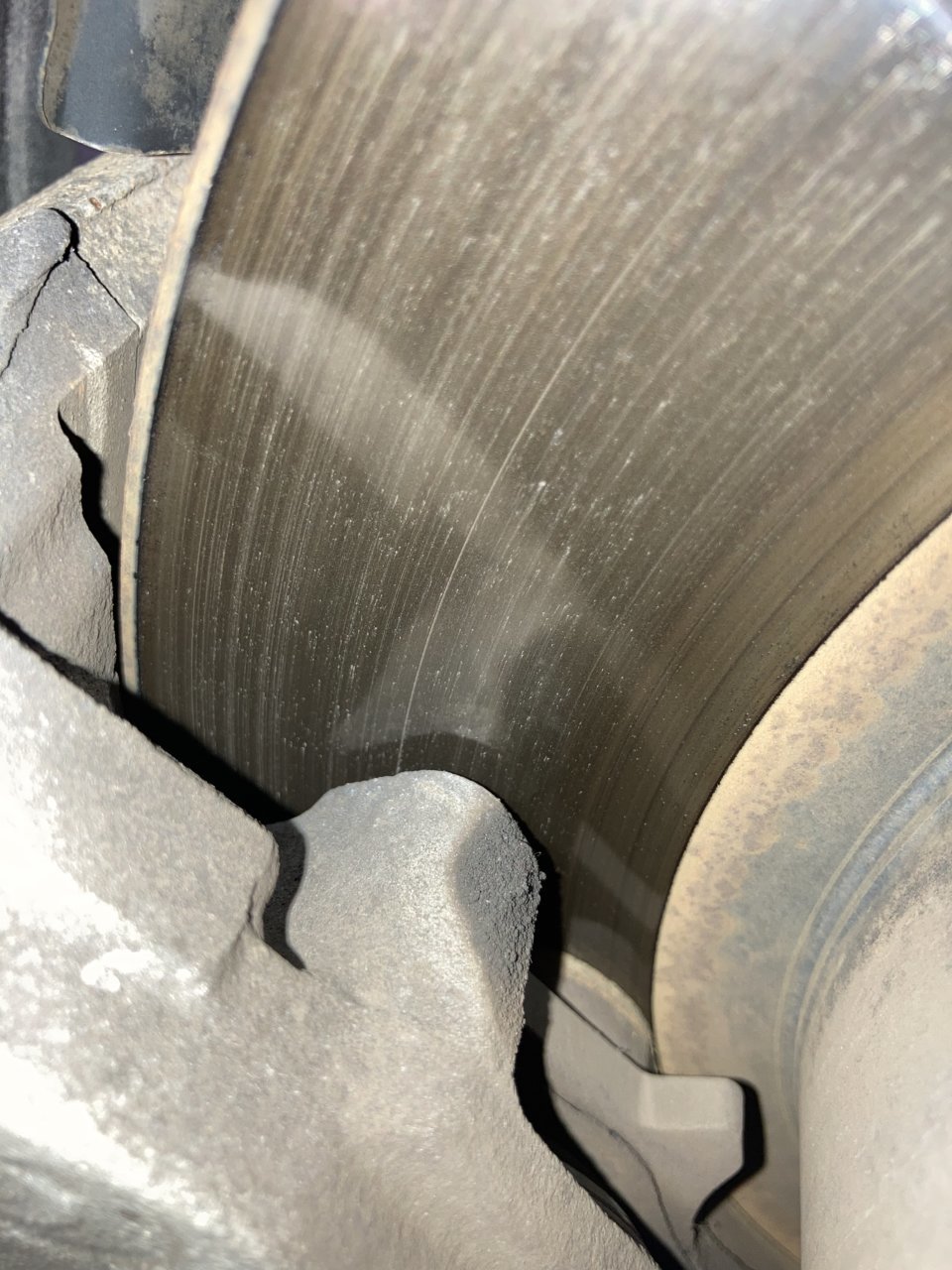

    I crammed my cellphone into a wheel spoke and got this photo of a 48000 mile brake pad.

    There's ton of life on that pad.
    If you pull the wheel, you can look straight into the calipers and see the pad material remaining.
    It would be a good time to check the lug nut torque also.

    Standard rule of thumb I use for determining brake pad life is when the pad thickness of the backing plate which the pad is mounted to, I replace them.
    I agree, that pad looks like it has some life left in it, although if you're going to replace the Rotors, do the pads at the same time.

    Don't just check the outer pad, you need to check the inner pad also, Disc's can wear at a very different rate if the caliper on the piston side sticks even a little bit.
