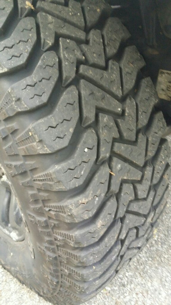

    Here's mine today with ~43k miles by my calculations. They about 11/32's tread left out of the original 18/32's. One of the tires has a slow leak that I can't find, nor could the local shop. 4ubeseve_29a07f1c6a1c56895867123cf3d55c01fe4cc11d.jpg

    Is that one with the weird wear? Do you see snow where you live?

    They all look like that. Mine don't have weird wear like the OPs though, just uneven wear due to lift. And ya, we get a good amount of snow where I live. About 110" last year. Plus I drive north to Maine 3 hours 1 way 3 times a week where there is even more snow.

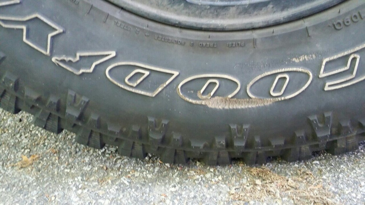

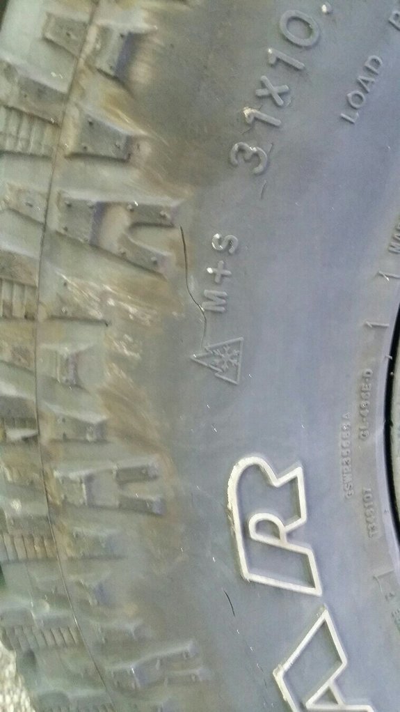

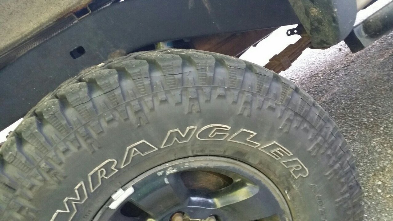

    My tires have also been beat on pretty well. All of them have a combination of slices and gouges like so:5yhapehe_e5efa00b7a05cc2fb35027a5aee9294bf2936a21.jpg5ujynepu_67db310ffc837365de73d6eb3951fe53618f35b3.jpg3apy9y8e_105ea8667a6faf2e3f131aa5ea314e8260b53f7a.jpg

    They are really good in the snow. I'm actually looking at getting a set of st maxx. The at3's are supposed to be good in the snow, however if snow performance is the main driver the Goodyears are severe service rated(I.e. branded with the mountain snowflake symbol), where the coopers are just regular M&S rated.

    I measured mine yesterday and they are at 11-12/32's, or about 60% tread left after ~43k mostly highway miles back and forth to Maine, with offroading mixed in.

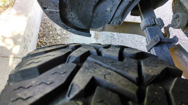

    sorry im late but this kind of gives you an idea, both tires that were on the front have this goofy stepping.

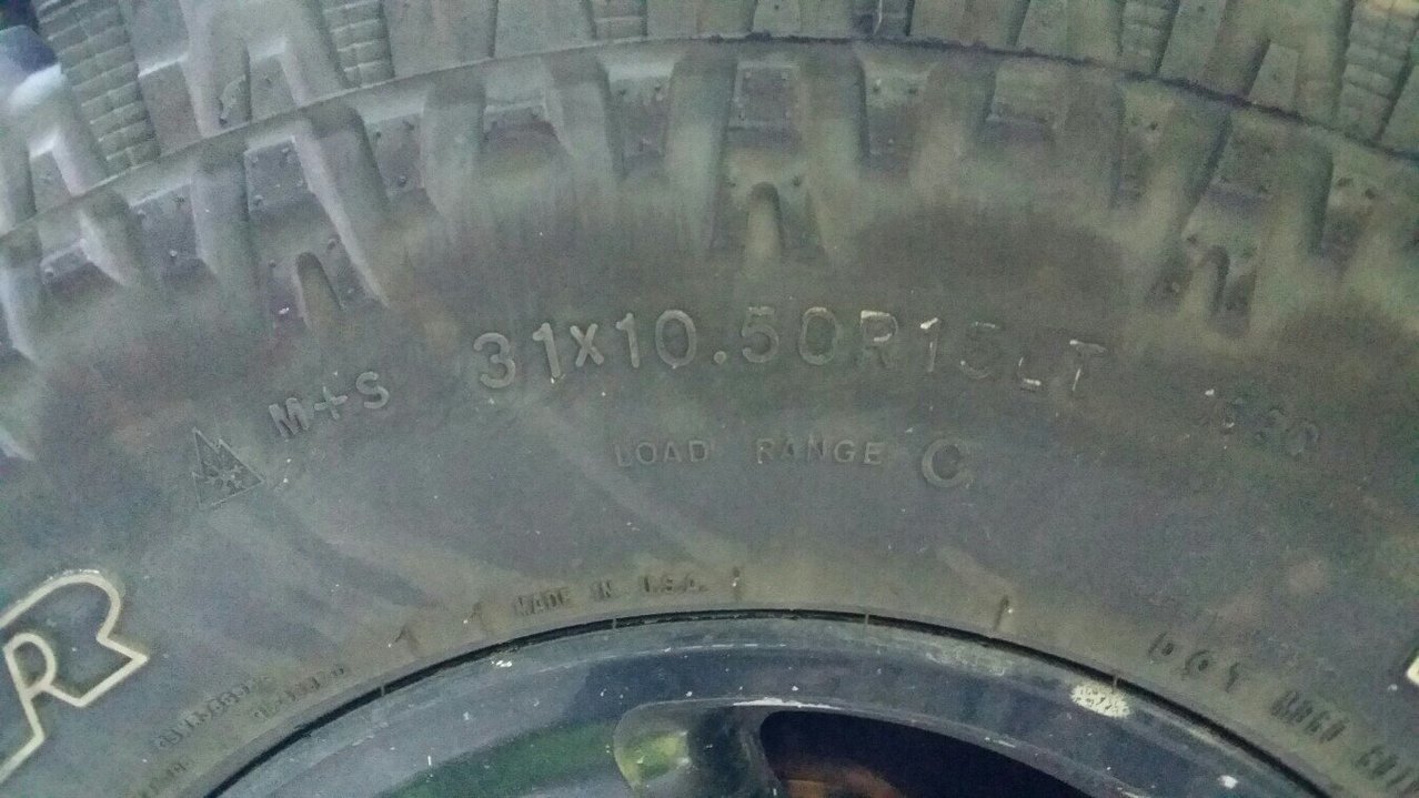

    Been looking at these tires for a while and I think reading this thread is definitely making me pull the trigger real soon..the only concern is the speed rating. I'm on wally worlds website and it does say a speed rating of C...I.looked it up and it's a translation of 37mph. .wtf? Did anyone else get the C rated tire and exceed 37mph? I can't seem to find any other authoritys with a higher speed rating..

    That's not the speed rating, that's the load rating.

    It says..
    Speed rating: C
    Load Index: 12

    It's wrong...

    These tires are typically a speed rating of Q, which is 99 MPH.
