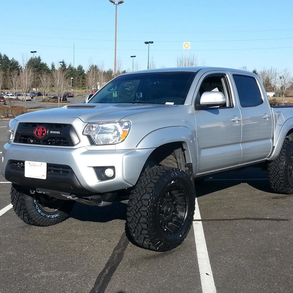

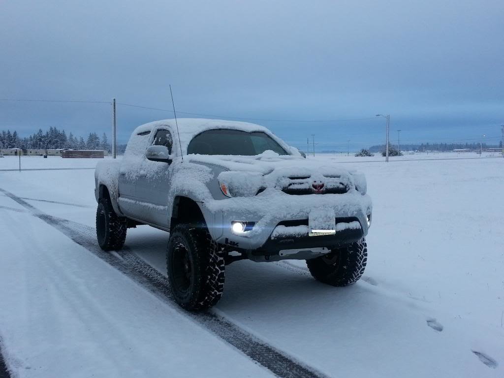

    Got my new duratracs on friday 285/70R17 and then saturday got dumped on. I was powering through things in two wheel drive no problem. Compared to my old Cooper A/T's these tires are awesome!! Plus they look badass! ;)

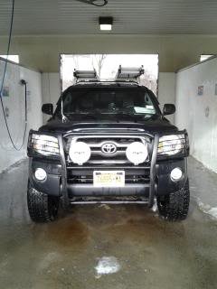

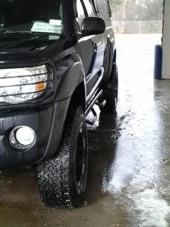

    I only had a couple pictures of the 285's,and they were from when I was selling them. I had them on Moto Metal 9 " rims, with 4.5 backspacing. The truck has a full 3" + in the front,with 885 X on 5100's set at zero, and a lean spacer plus a top plate spacer. I had to trim, the plastic inner fender on the front pretty hard on both sides, and would still rub when backing up at full lock. Other than that no issues, except they were too much tire for my 4 banger, and the BFG AT's stuck out to far, and held so many stones it was sandblasting my truck. Much happier with the Duratracs in 235-85-16 and put them on a set of stock TRD OR wheels.
    017_zps1f5d1671_f1b794a206d54a509b5596b7af177c5a6fa29254.jpg018_zpsb566699b_c8f02f68d3a16eecfbe2c70625ac522cabe0bfa1.jpg
