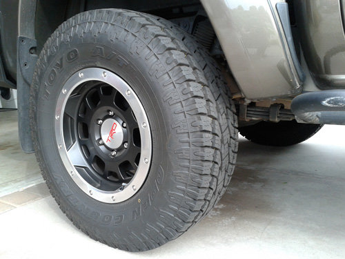

    I just put on a set of Toyo OC AT2's. Of course they are new but wow what a difference! These AT2's are quiet and smooth. My truck drives like new again. They don't look as aggressive but hopefully they will still perform well offroad and in the snow. Wet and dry traction is great. My Duratracs were down to 7/32's with about 30k mi. They still were good offroad but onroad they were very noisy, had some vibration and wet traction was not good. I ran them at 36psi recommended by the tire guys. Same for the AT2's. My truck is a DD so I had to get off of those Duratracs and onto something better on the HWY. I'm very happy now except now I can feel the front diff vibe again. Next is the ECGS diff bushing. Oh and while I was at it I got a set of wheels.

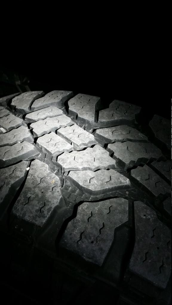

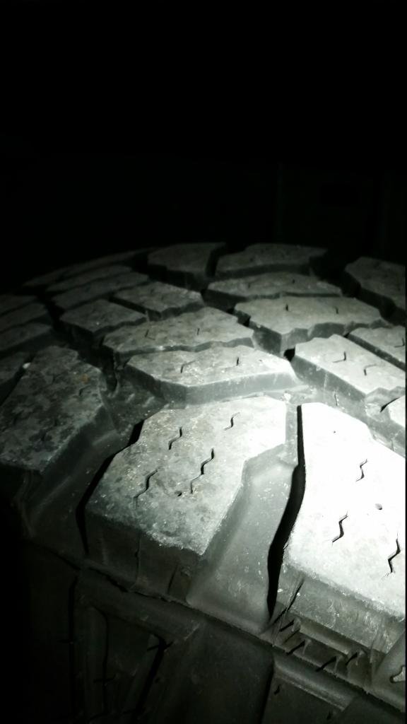

    Reporting in with 3.5 year old, 33K miles on my 265/75/R16 Load Range "C" Duratracs.
    They are loud at highway speeds, and wearing fast! I expect to replace them in Summer (2015) when they hit 40K miles. I will probably try out the Cooper ST Maxx tires in load range D or E, maybe a heavier Duratrac. Not really happy with how fast my Duratracs have worn, but the traction has been excellent. I did not have any balancing issues. Tires rotated and balanced every 5K miles.
    Since owning them I've poked four holes in them. I don't blame the tires though.
    Here is a picture of one with 33K miles
    Compare the above to the day they were bought new:
