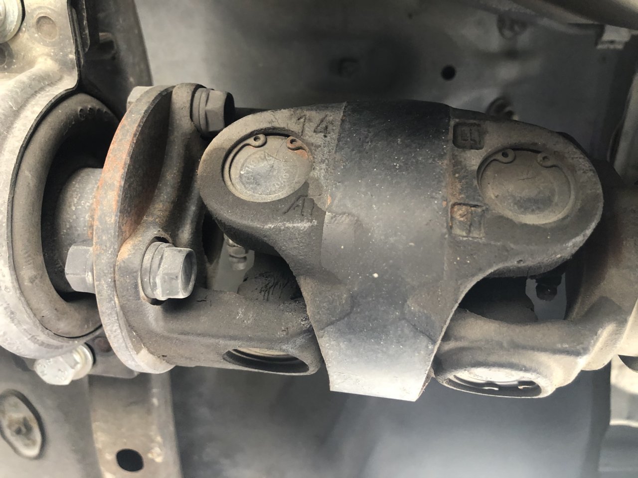

    Bought grease gun and grease this afternoon.
    On my access cab pre runner I found 5 zerk fittings - 1 up front where shaft connects to transmission , 3 in the middle (photo) and 1 down near the rear where shaft connects to rear dif. Could I be missing any?
    don’t have proper setup for slip yoke at least no torque wrench that goes up to 60+ ft lbs. might do this later..
    Taking it on test drive I didn’t notice any sound of any squeak or ping of any kind, so that’s good news. Solved? Seems like it so far, fingers crossed
    thanks for the tip!
