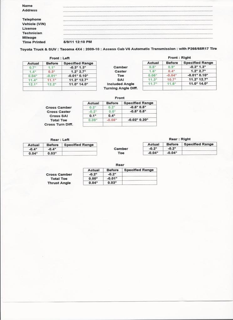

    Here is trip 2, after telling him the specs to shoot for:
    Rubbing has stopped on the Cab mount, but its time to hit up the front plastic again.

    Not perfect but much better! plastic is easier to trim! haha

    That second go round is much better.
    I got mine done at Toyota and they were able to get me to
    1.9 Caster, +0.8 Camber, 0.05 on both sides Toe with Stock UCA's and 5100's set to 2.5.

    Yea, definitely better on round 2. I'll be ordering some new UCAs in a month or two so I can get it perfect. I was very pleased when they didnt charge me anything to "fix" the alignment.
    Trimmed the little bit of plastic out of the front I needed to get rid of the rub. Haven't rubbed on the Cab Mount yet at all, not even in reverse on full lock!

    Looks much better. About as good as can be until getting the UCAs. How does the caster feel? Shouldn't be crazy bad annoying.

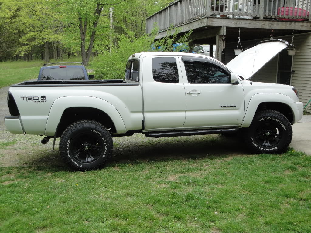

    Finished Product

    No more rub?

    nope, not driving easy anyhow. If I was wheeling, then I would Still rub
