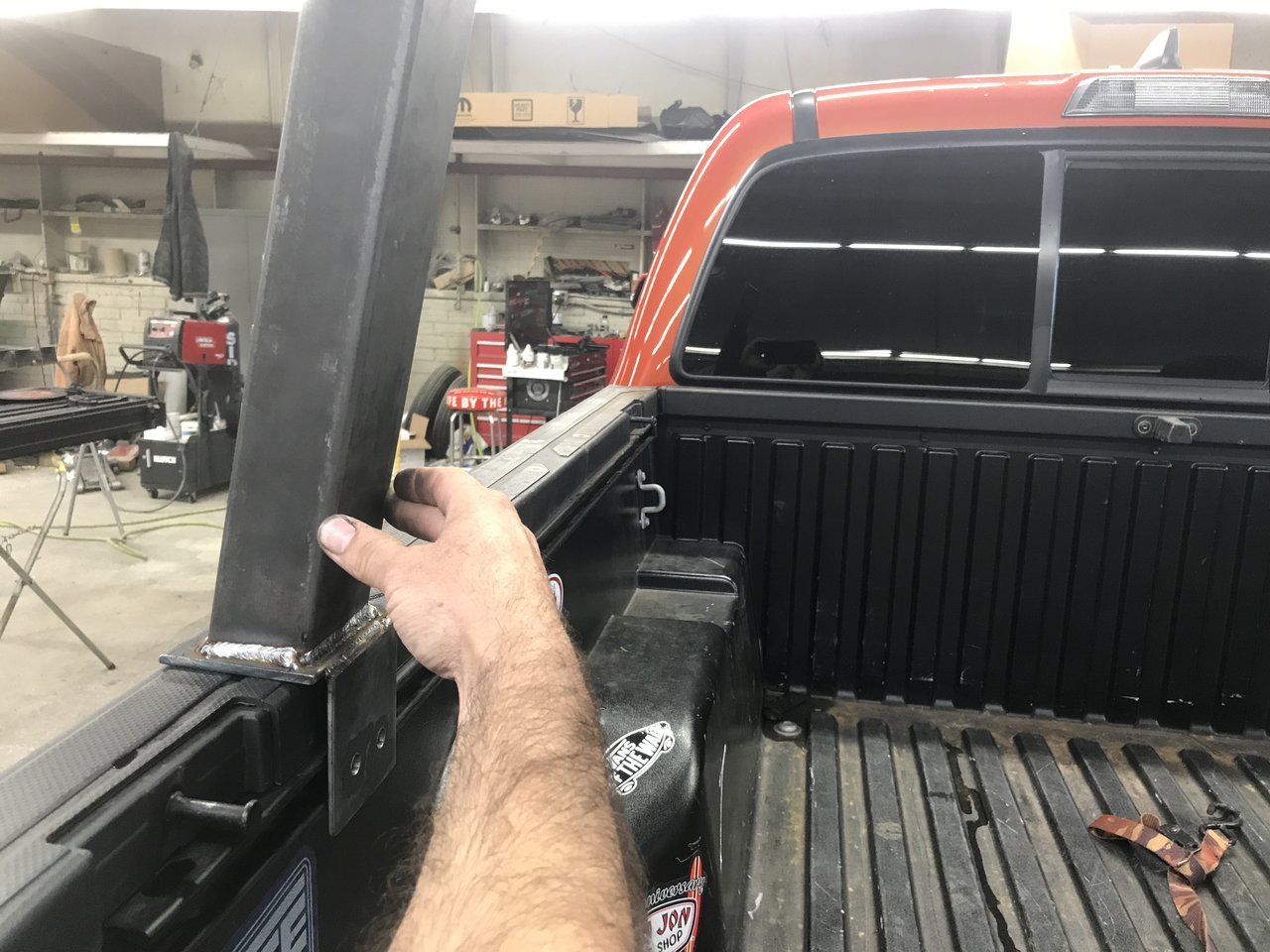

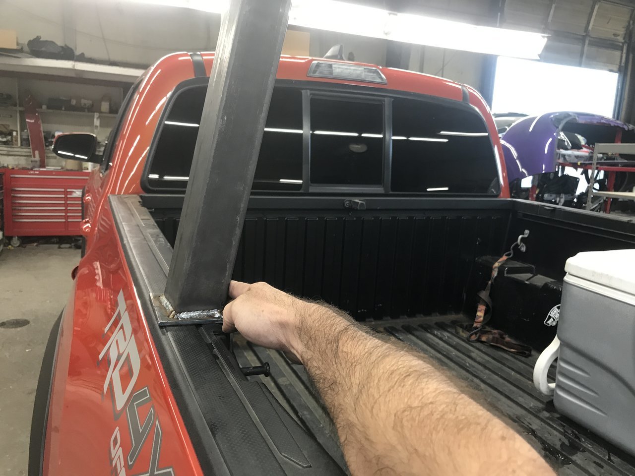

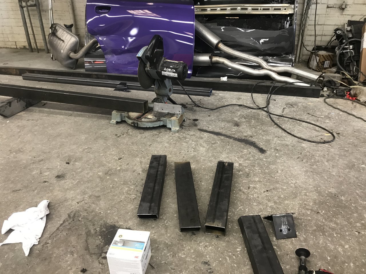

    I know it's a little crude but I'm only going to use it when camping with the rooftop tent. I get paid on commission and as you can see my stalls where empty today so I broke out the steel I had bought a while back . I started with some flat bar from Home Depot and some 5/16" hardware to figure out a nut plate that worked with the brackets I made for mounting.

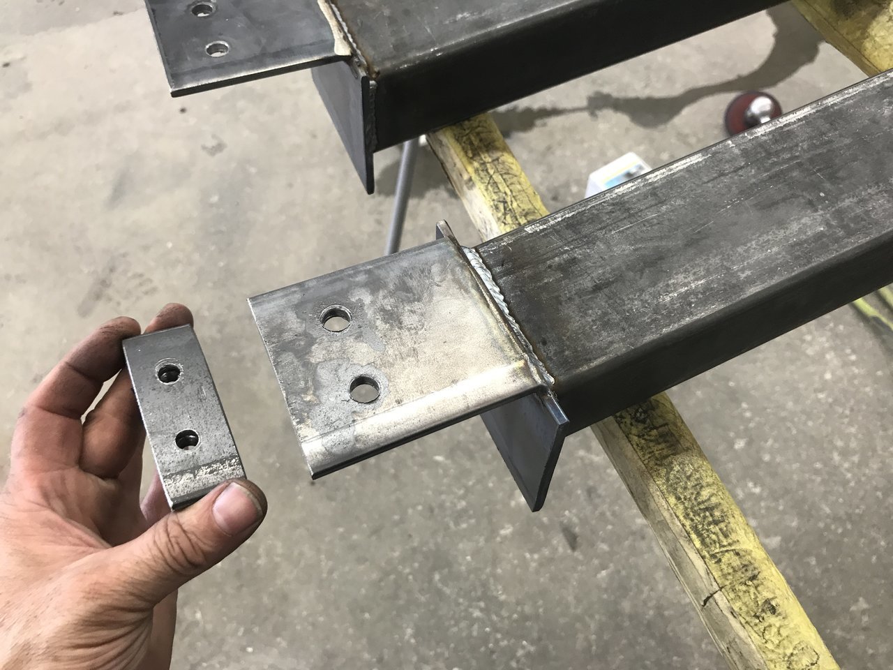

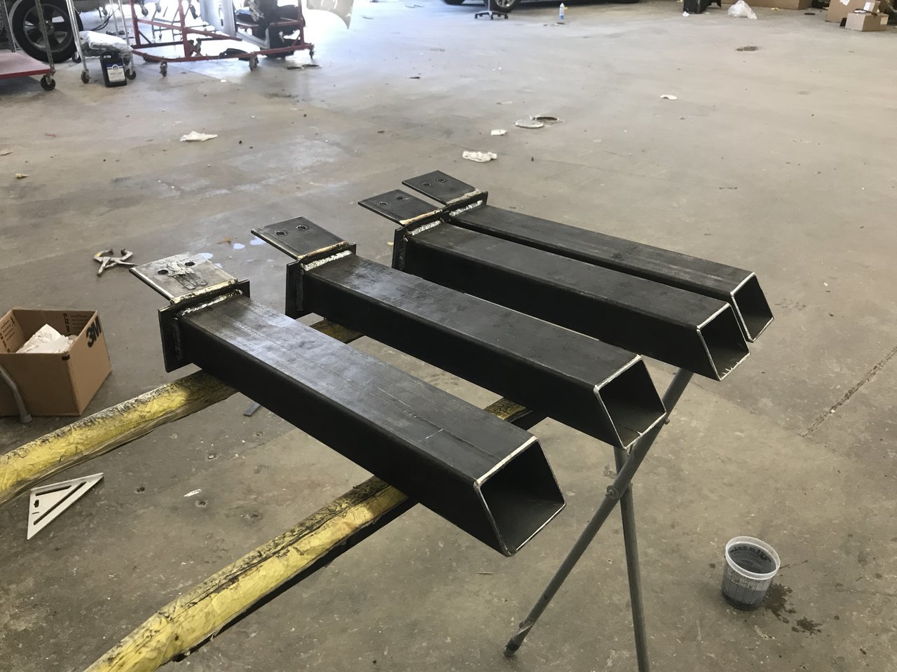

    Then on to making the "pedestals"

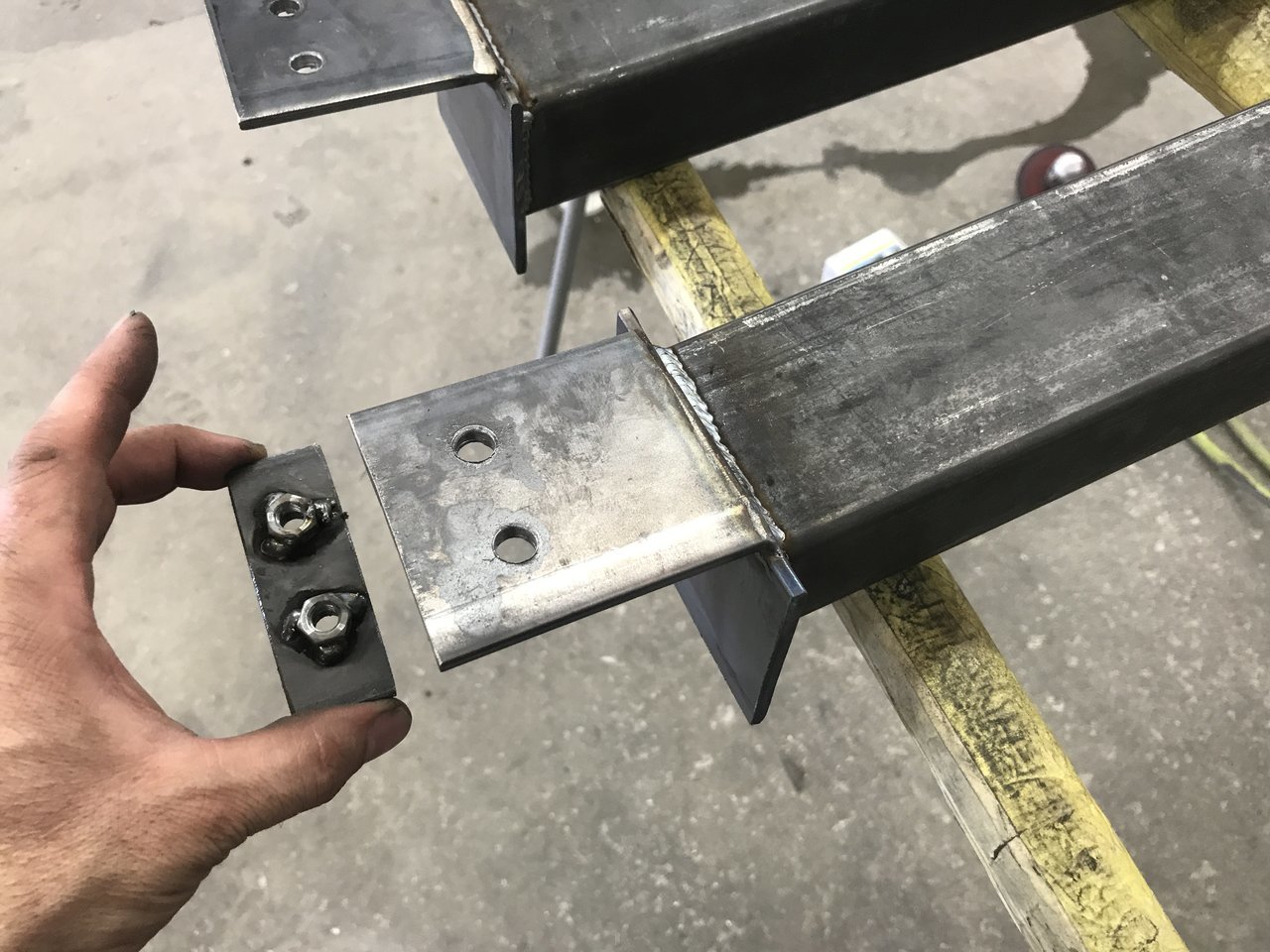

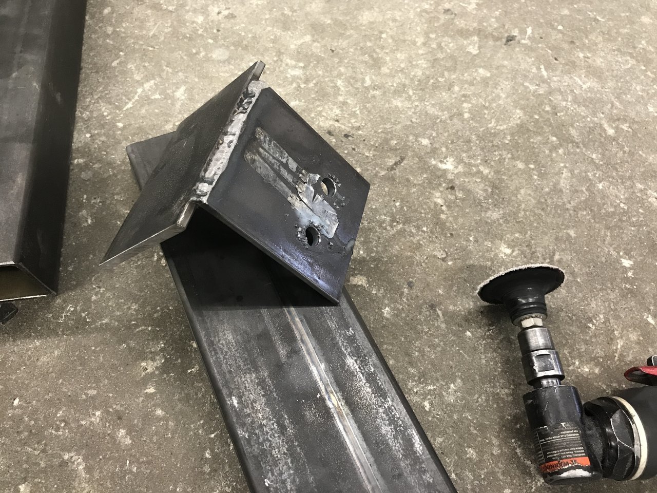

    Here are the nut plates that slide in the bed cleat tracks

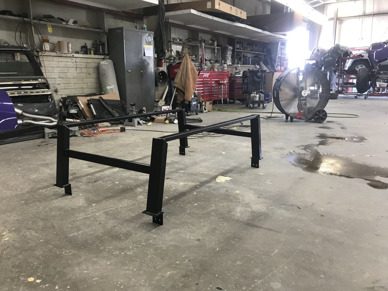

    Ok it's coming together a bit

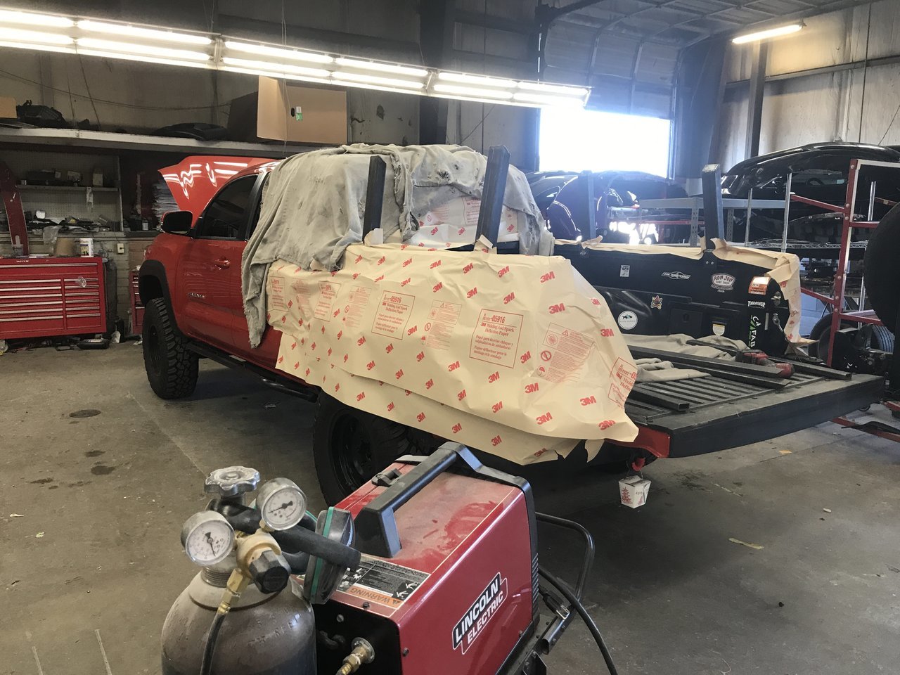

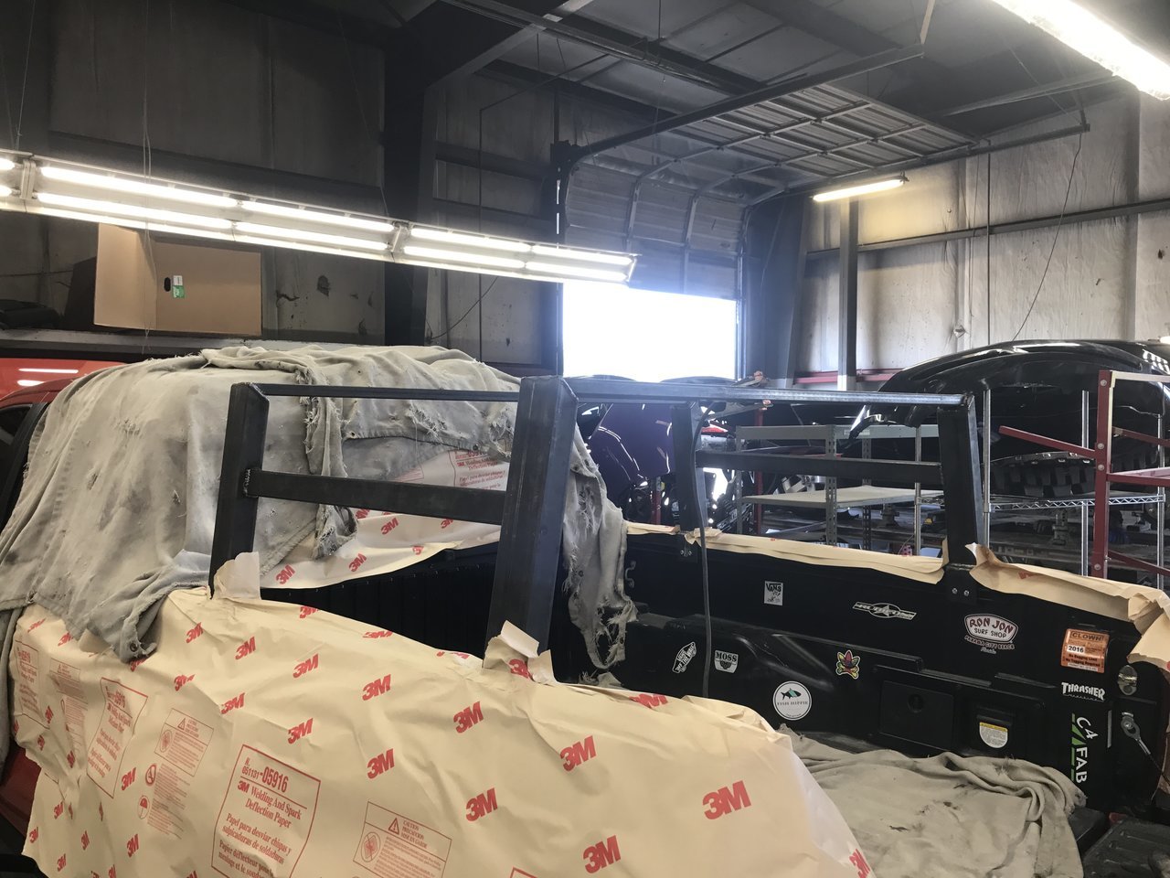

    A little spark arrest paper and welding blankets so I don't burn the paint with slag

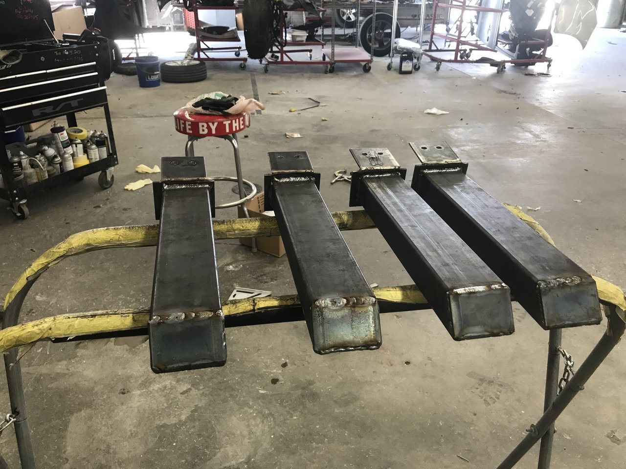

    Then a little black PPG epoxy primer followed up by some black SEM e-coat .. I'll post up some pics Monday . I grabbed it from underneath the bases because that was sprayed first and got it out of the paint booth but still to wet to mount.
