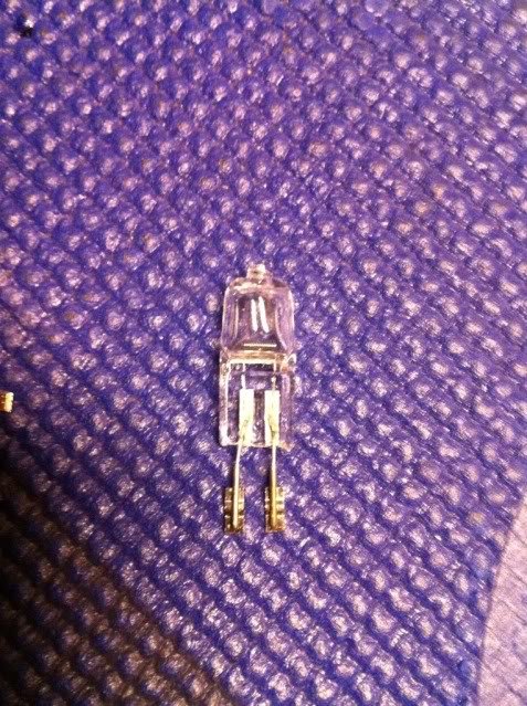

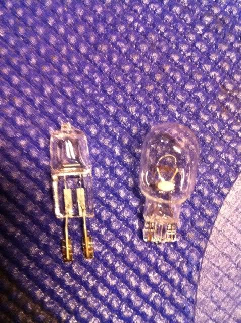

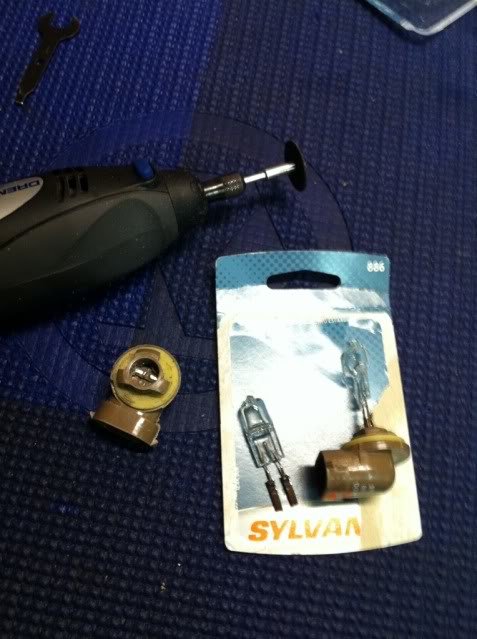

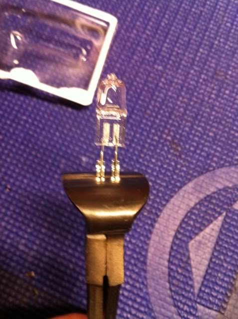

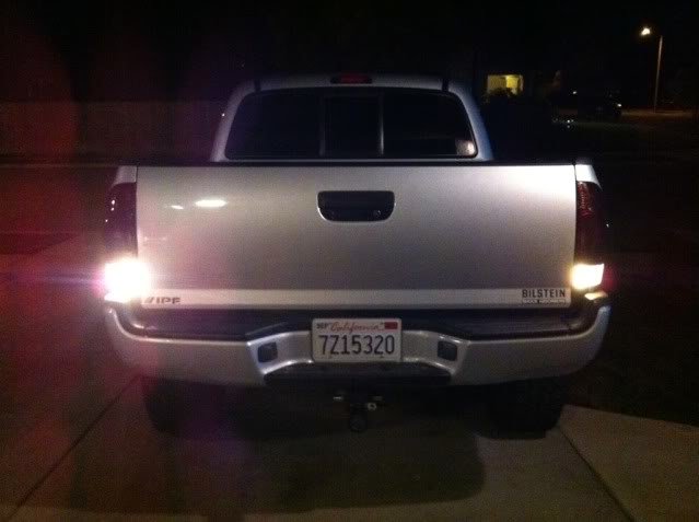

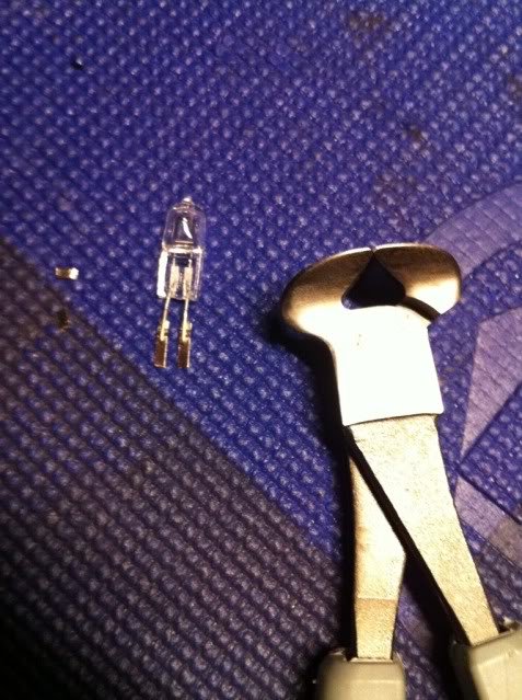

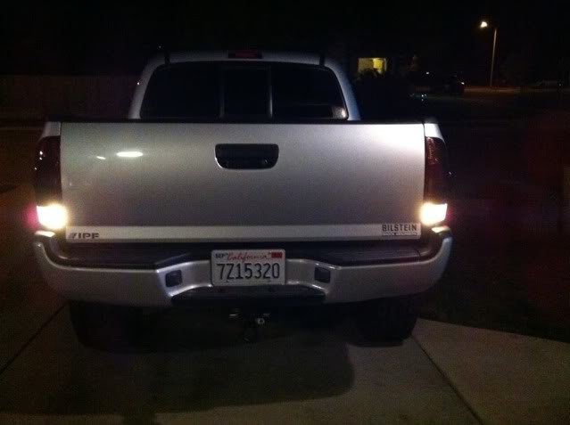

    Just installed the 886 bulbs tonight
    Cut the bulbs from the plastic base with the Dremel
    I then shortened the exposed connections with End Cutting Pliers
    Before:
    Comparing (Left = 886 <-------> Right = Stock)
    Done:
