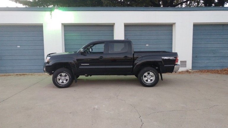

    5100s all around, front set to 1.85, 1/4" top plate spacer, Deaver AAL
    Still on stock 265/70/16s. Plan on getting 75s when it needs tires.

    Looks good! Is it level? Looks like the rear sits a little lower but could be the picture.

    VERY nice. I had a '14 TRD OR DC that could have been it's twin.
    Curious why the 1/4" spacer? Couldn't you have just gone one more adjustment on the 5100's?

    Taco lean. :)

    Next setting is 2.5, I didn't want to go that high with stock tires.

    I thought so too, I haven't measured it yet. I will tomorrow and see where it sits. I hope its real close, it will drive me nuts if the rear is lower!

    Looks dead on.
    Here's the same pic, straightened with the frame.

    Looks good though. It will settle a bit, so it may change some.

    Looks great! Looking at the lines on the truck I think it's level, looks good! I think people maybe thinking it's lower in the back because the truck is all black so it's hard to see the space in the rear wheel well.

    It will settle. Mine did.

    Finally got around to measuring the fender height. 37.5" in the front and 38" in the back hahah, just made it lol. Wish I would have measured it before lift. I would like the rear to be a little higher. what to do what to do.
