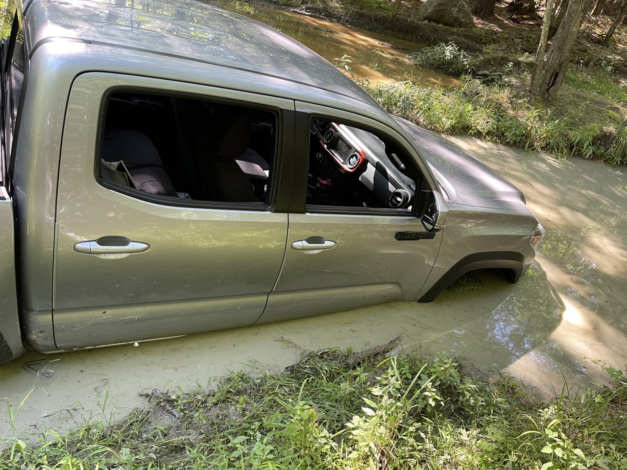

    So today I went off-roading and got stuck in a deep mud hole. The truck was initially failing to start, but it turns out the ground line was just loose for some reason. The truck is now taking an extra 0.5-1s to start, but after that, it runs fine. I've driven it for about 20 miles at speeds ranging from 30-60mph with no issues, but after learning where the air intake vent is, I'm super worried that I got water in my engine. I have no idea if hydrolocking is something that occurs instantly or after some time so some input would be appreciated. Attached is a photo at its deepest.

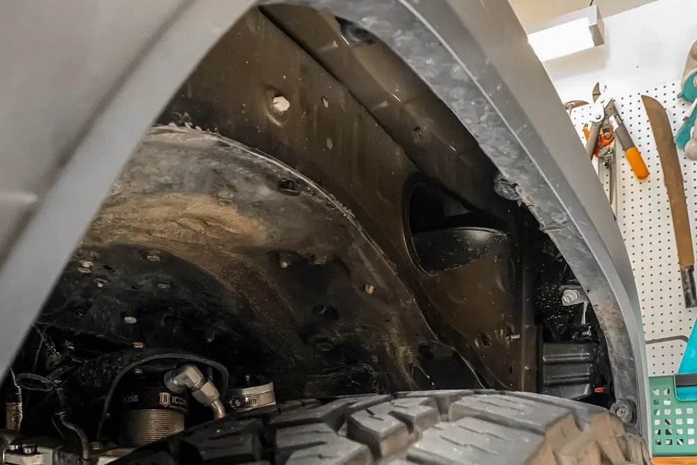

    Your intake is well above the water line and behind your fender liner. No issues there. It’s basically behind the decorative crease in the bodywork of the fender.

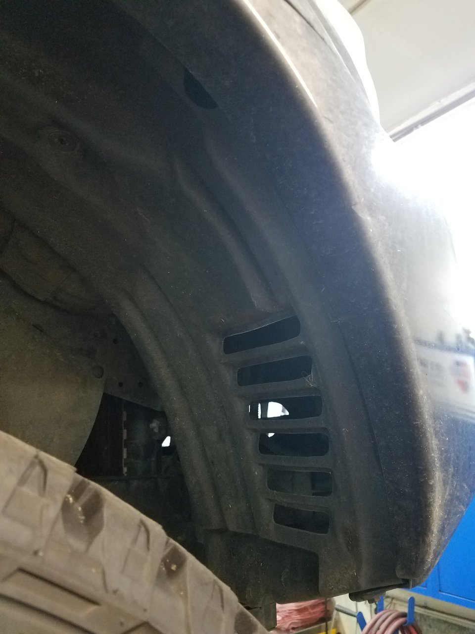

    Okay, I just saw this picture on the forum which is what had me worrying. My truck is across my campus parked right now so no way of seeing if mine looks like that.

    Those vents allow air into the area behind the fender liner, but the actual intake is high up in the fender, almost at hood level, with a splash guard over it.
    Toyota has your back on this. They put the intake in the best spot possible.

    The black plastic intake can be seen with the fender liner removed. The splash guard is facing toward the front of the truck in case any water makes its way up there.

    These trucks are loaded with computers, just wonder if one got wet thats now been affected. The water on the passenger side front tire appears above the rocker.
