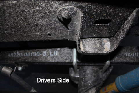

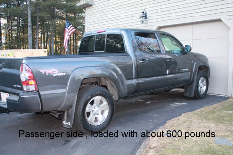

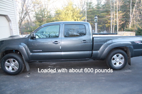

    Bummer, just checked my 09 DC, LB, 4X4, and it has the old part numbers for the leaf springs. I just picked it up last week 2/12/09.
    I currently have the truck loaded with approx. 650 pounds. I will post pics in a bit. The one thing I noticed is the amount of space between the top of tire and the bed. It appears that on the drivers side (LH) the bed is much more compressed than the passenger side. By about 2 inches or more.
    I shifted the weight to favor the passenger side as well to see if that was the issue and it is not.
    Could it be due the fact that is where we fill up (drivers side) with fuel and the tank ids more on the drivers side than in the middle?
    I will post pics after I download them and change resolution, then upload them.

    Here are the pics. If you right click on pic, then open in new window, the pic opens up larger.

    Drivers side natural lean has bee discussed in threads before so that seems to be standard.
