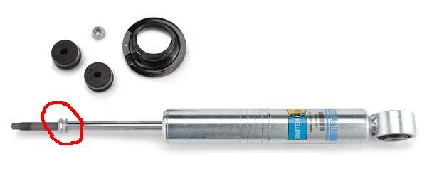

    Did you happen to install this piece?

    yes i believe i have that piece install on too. i left that at the very bottom. why do you ask? jw

    Because without it, it would like the pic you have posted.

    Also make sure your spring perch is not upside down..just a thought since that happened to mine and my bolt was sticking out just like yours
