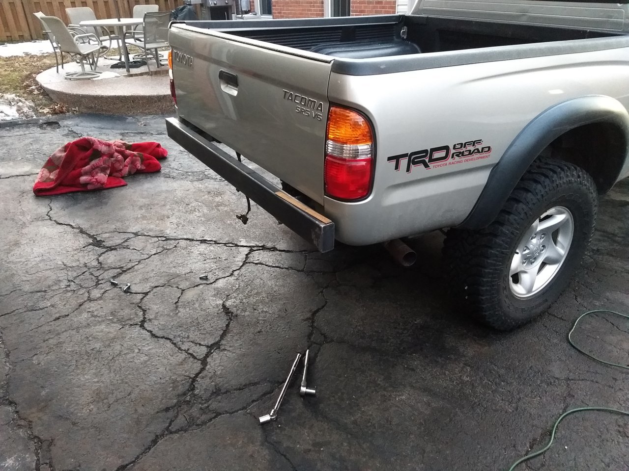

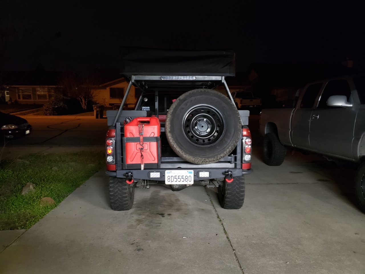

    I'd love to have my spare 285/75/16 on a swing out but honestly I'm not sure if I can make it work with my current setup on the custom bumper I had made a couple years ago. ANY advice would be greatly appreciated!!
    At the time I had a tire mount welded in the bedrack cause that's the look I wanted. Well since then I've changed my mind. I just got an RTT and that is now going to have a home permanently on my bedrack.
    Below is what I'm working with.

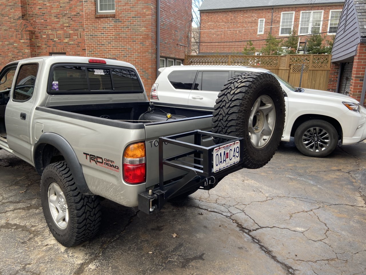

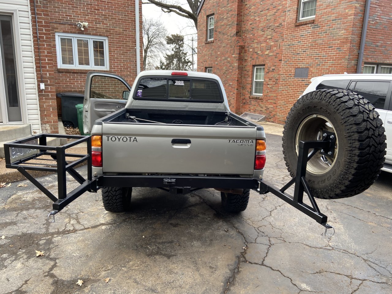

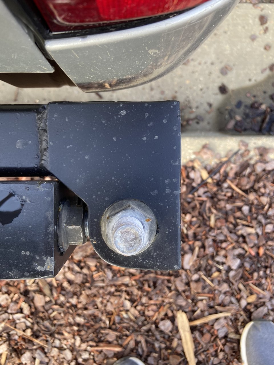

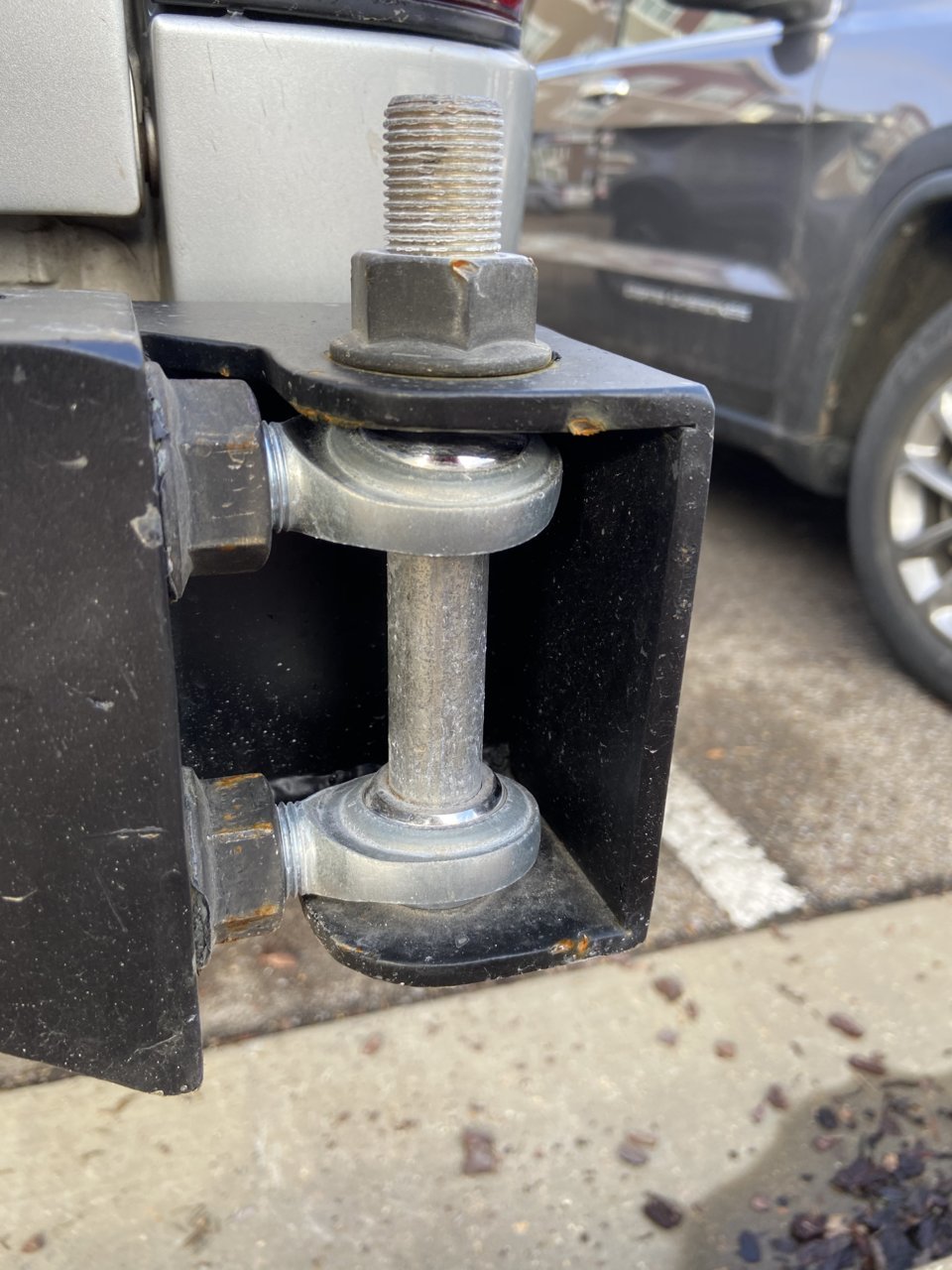

    I just built a very similar bumper with a swing out. This is the outcome I can answer any questions you have just let me know!
    main bumper is 4x2 3/16” wall then there are 3/4 bolts on the ends with heims to pivot on for the swing arms.
    before swing outs
    after
    D6AFDCB5-E63F-4CC8-81A0-82FDACEF86D5.jpg 5829F8A6-CF93-41FF-AA48-8A88BC130467.jpg

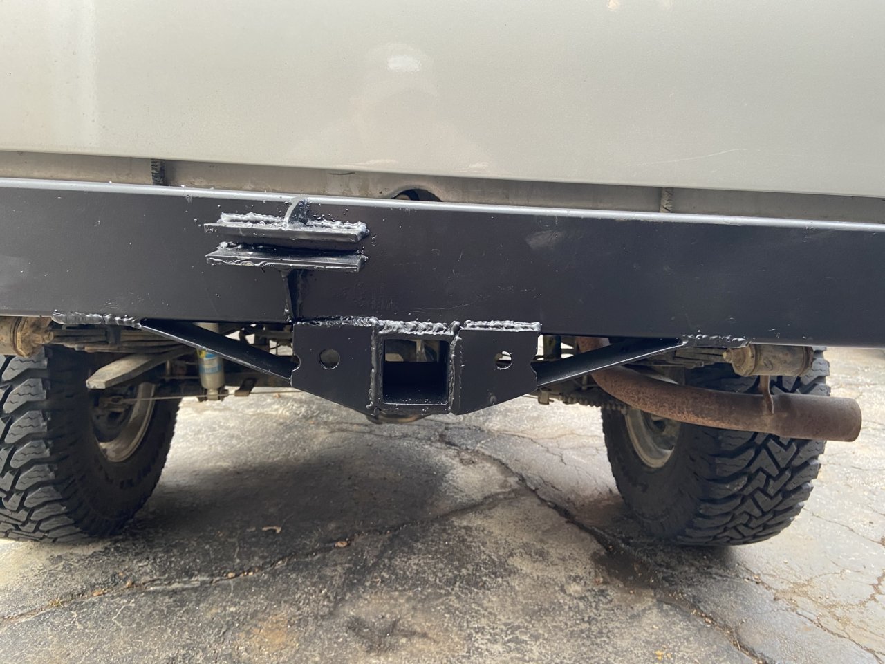

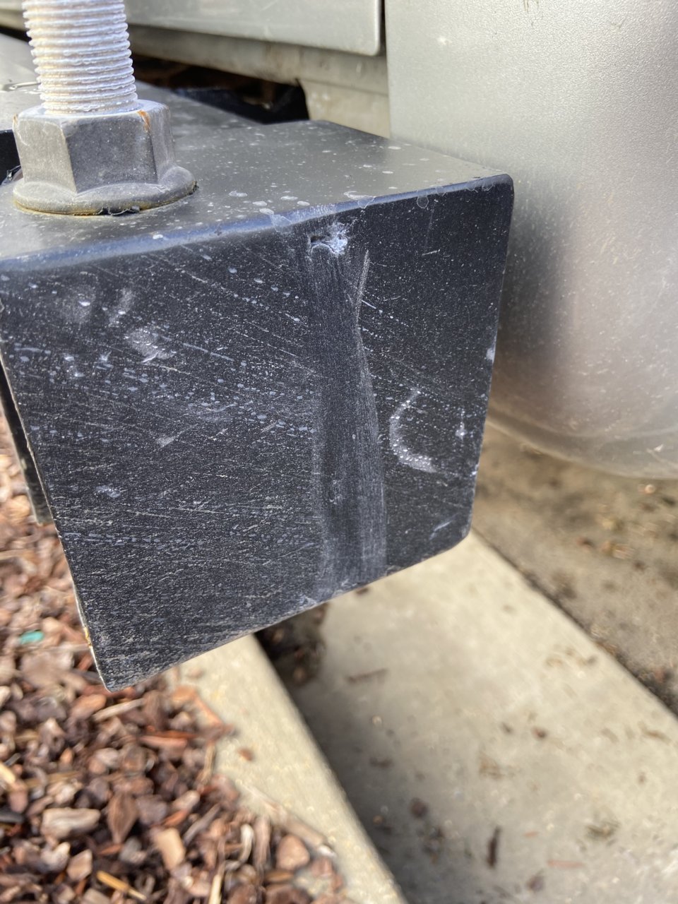

    These brackets?? Are the custom built?

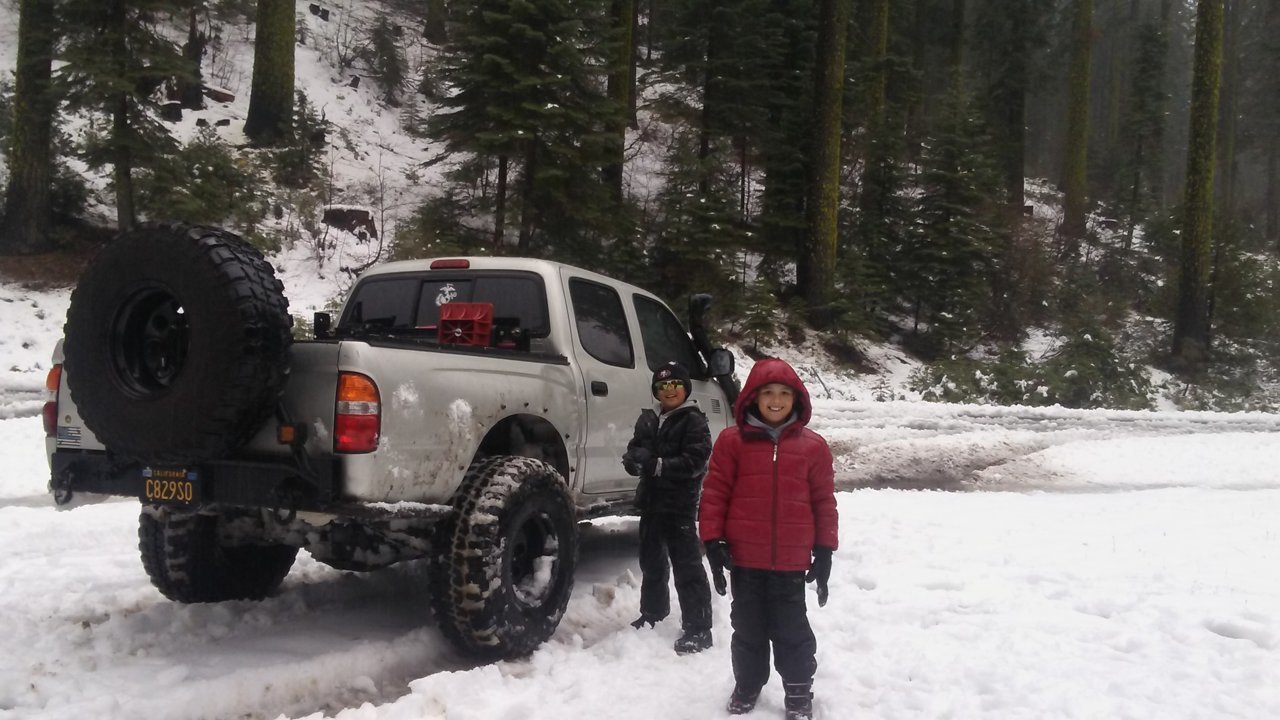

    My old bumper was like yours. Had a swing out built on it a few years later. You should be able to do so without cutting your shackles. I since sold it and got something a little simpler and cut into my bedsides

    Yes it is all custom. I will take pics in a few hours when I can to give you much better answers but I built it all with an angle grinder. In its essence it is 2 P shaped pieces of 1/4 plate per side where the top of the P has a 1/4 plate between them to keep them from smashing in if I drag it on the ground.

    Hey Fernando! Not sure if you remember me. Its been a while since I've been on here lol. If I remember correctly I think I tried to replicate your bumper a couple years ago. By any chance do you have any more pictures of the rear set up? Maybe closer up so I can see exactly what you ended up doing? Any pics with the tire swing outwards?

    Top view- you can see the p shaped piece of plate
    side view- where I rubbed the line in the dust is where a cap I put on the end of the tube ended and where I put a piece of 1/4 plate between the Ps
    rear view- you can see the swing out mechanism (3/4” bolt with 2 heims that sandwich a piece of 1/4 plate between 2 nuts to attach to the swing out)
    trailer hitch assembly and pin location to keep the swing outs closed

    What's up bro, yeah I remember you. Your trucks looking good. I actually just sold that bumper about a month ago to a guy in a gold first gen. I think I have some pictures in my build thread towards the end. Got some close-ups. Some guy had asked the same. Go check them out.
