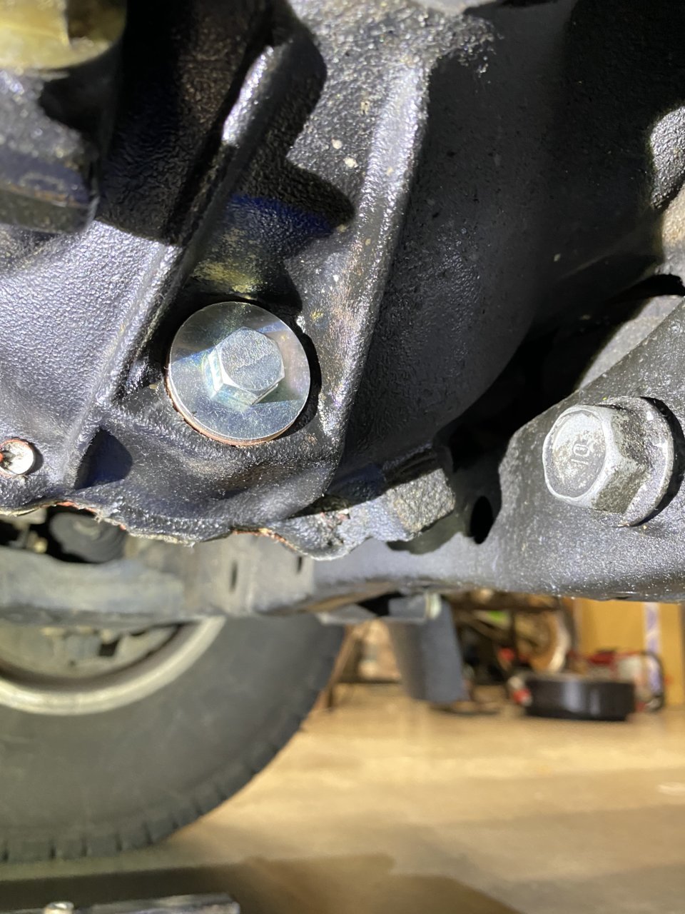

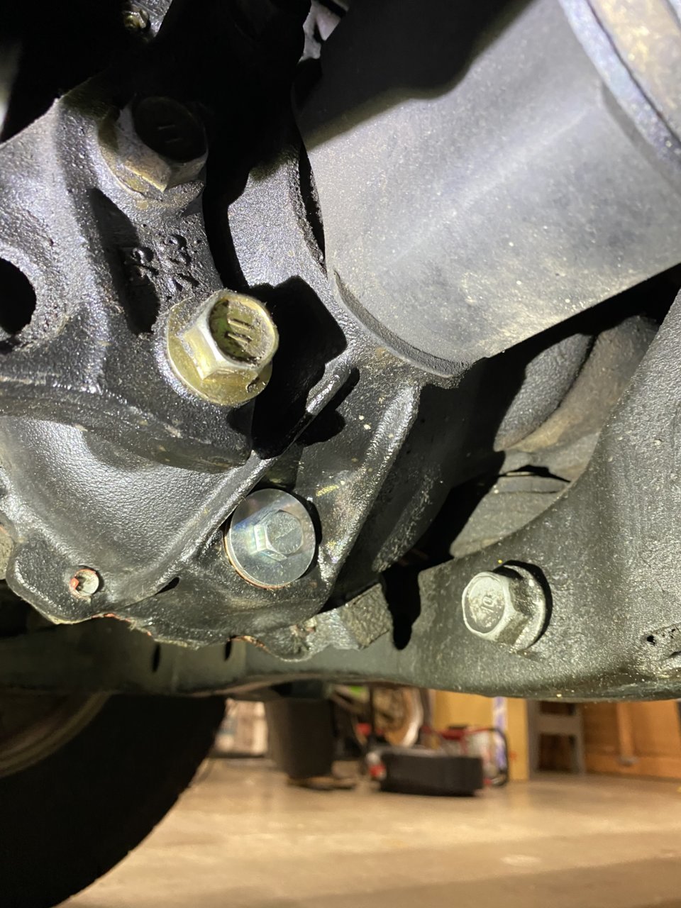

    Rear diff oil change.. No issue. Transfer case.. No issue. Front Diff? Man that thing is tight!! I probably could have re used that old drain bolt but man, having a 12mm Allen socket as the drain plug sucks. A little research and I was able to drop down to Lexus dealership 20 min away and pick up this one thanks to some members here and other online forums. If you do end up doing the job down the road.. I recommend getting one with the crush washer and just swapping it out. P/N: 90341-24016. (sorry if this has been preached to death)IMG_9292.jpgIMG_9293.jpg

    Wow I literally did my diffs and tcase two days ago and didn’t know you could do this.. maybe next time I guess

    Ah I See. I didn’t stumble on that one!

    I didn't either until you posted, then I searched on the P/N and voila, I got to buy more stuff now :/
