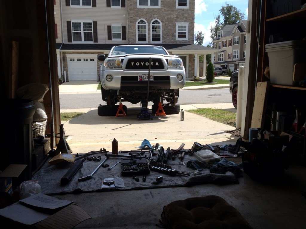

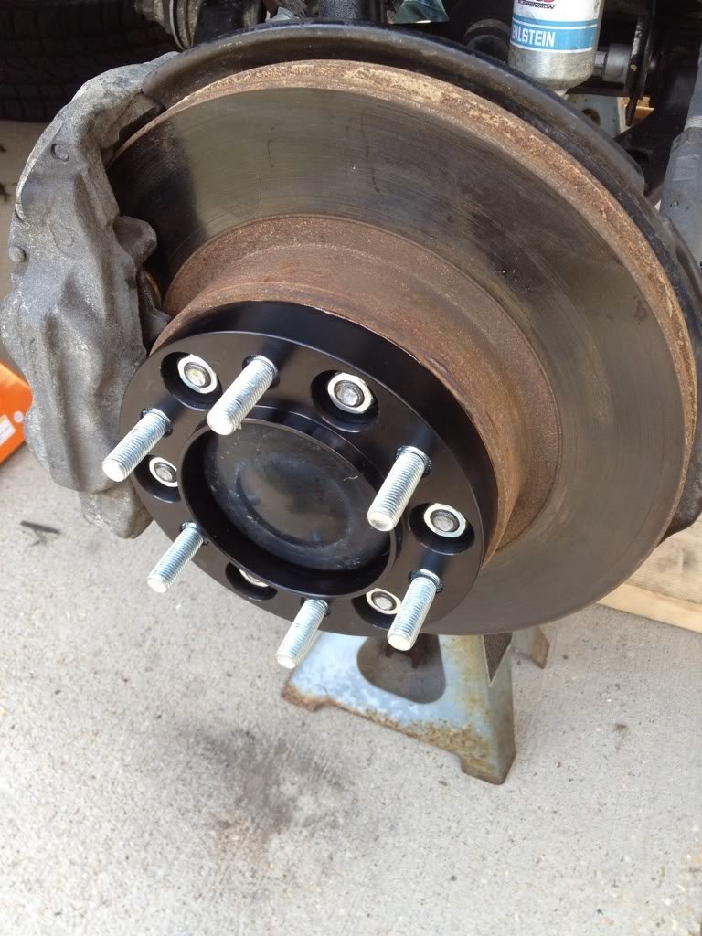

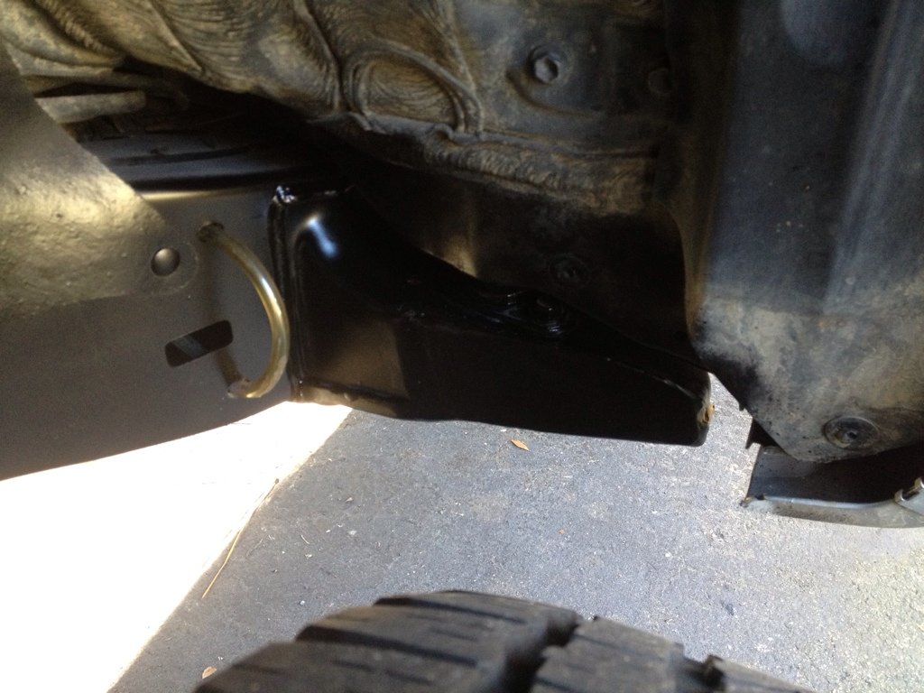

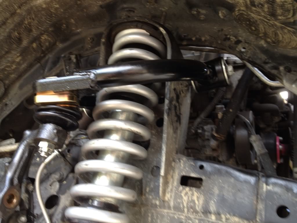

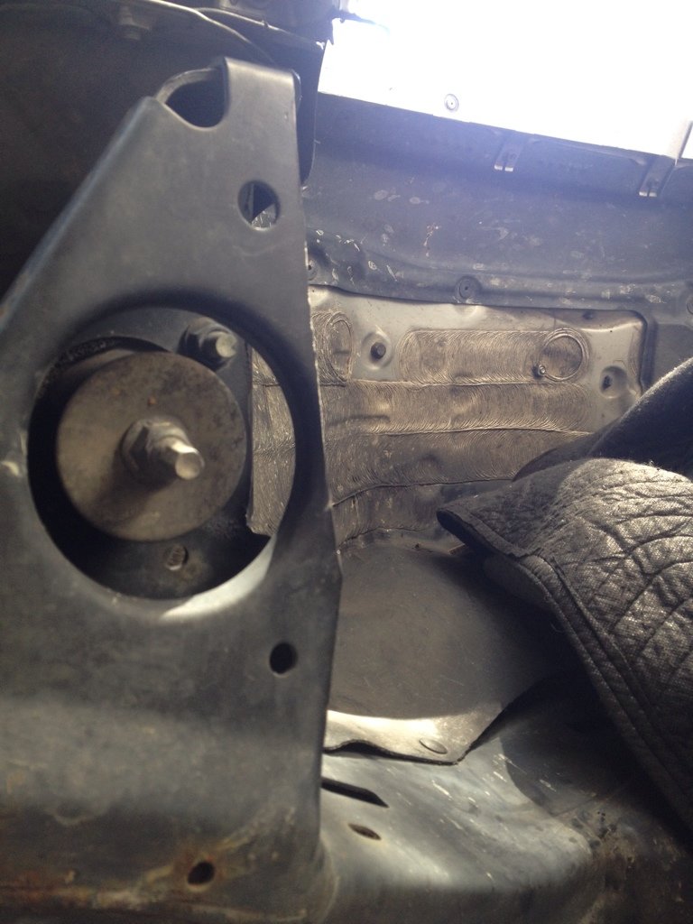

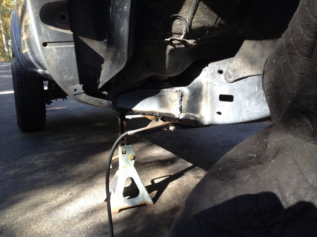

    I finally got a chance to install my LR UCAs from the GB that I started with Head Strong OffRoad, as well as the BORA 1" Wheel Spacers. Also added a 3/8" spacer to the drivers side, and moved the 1/4" spacer over to the passenger side, just to get that little bit of extra lift I was looking for. Finally I painted and installed a lower milage set of stock LCAs, all of that took me about 8 hrs, including a trip to Lowes for some tools, and a break for lunch, not too bad.
    The BORA spacers went on very nicely, I coated the backside of them with High Temp Anti-Seize, hopefully that will prevent them from fuzing to my rotors and drums. Then took them to 82 ft-lbs all around.
    I also got a set of lower mileage lug nuts from a TRD Sport, to replace the slightly damaged and annoying TRD OR lug nuts on mine. Funny thing was, the Sport lug nuts where longer than the OR ones I had, weird, but didnt make a difference, and I like them better, they stick out about an extra 1/2", you would have to be looking and give a shit to notice. I am just happy to have lug nuts that are not all buggered up from an improperly used impact...
    81E28F9A-0589-4788-9DFD-D244DC2B25FC-546_dd24cd85be2b511275bb63dc098eb2da0302982f.jpg
    Painting the new to me LCAs
    And the real work got started:
    93F4AA78-6CB9-4ED7-B372-5B30BEC8736B-546_7ec3611b300a240075f4818db33823fee245b168.jpg
    57A4DB27-67F4-40BA-8279-1F1480225E85-546_5f1a4d2f36730075ae1a73edd8621941fcfe917a.jpg
    Overall the arms went in very easily, a little bending of the fender got the factory bolts out, and I ended up putting them back in the same way they came out, it wont make a huge difference, but it only took about an extra 15 mins to get them back in the "correct" or "Toyota" way. Torqued everything down and crashed for the night. Now it needs an alignment, the skids need to go back on, and I want to actually drive it. I set the Drivers side LR UCA to +2.0 of Caster and the Passenger side is set to +3.0 of Caster, because the passenger side on mine was maxed out the last time I got it aligned, so I set all of the alignment eccentrics to 0 deg top dead center. Everything got a healthy splash of grease and it should be all set to go.
    I also installed the OME carrier baring drop kit, that seems to get rid of some of my drive shaft shutter.
    And I also went through an entire can of brake cleaner on my rotors, and boy did a lot of crap fall out. Wet sand it evil shit...

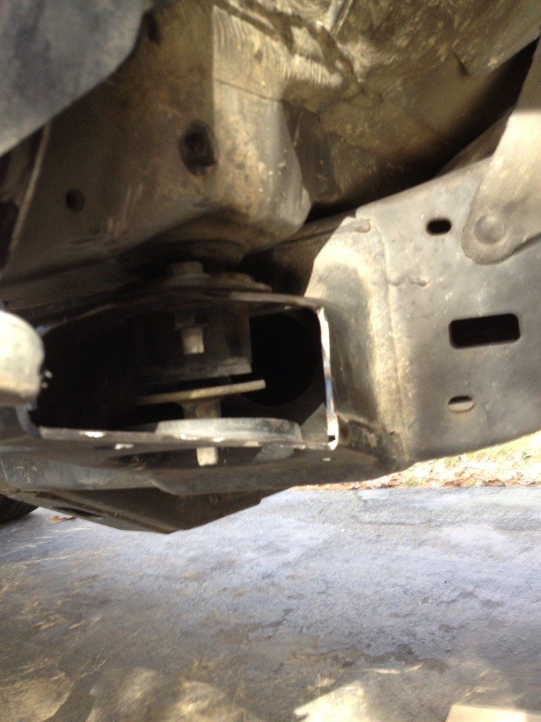

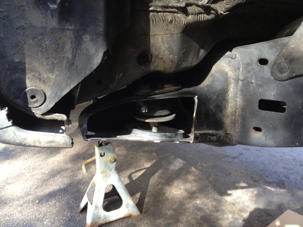

    Installed my cheap 3/8" diff drop kit - it is 2 fender washers, reused the factory bolts, still had sufficient thread engagement, and the skids dont need to be relocated, and nothing is hanging low. It isn't huge, likely wont make a difference, but it makes me feel better... :rolleyes:

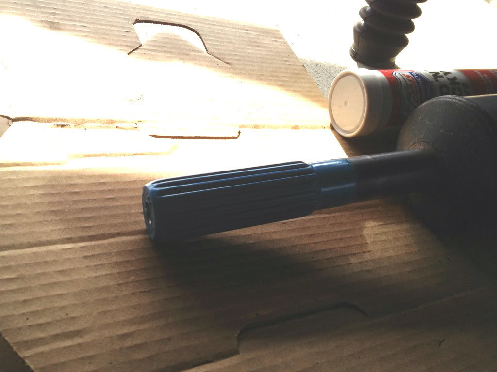

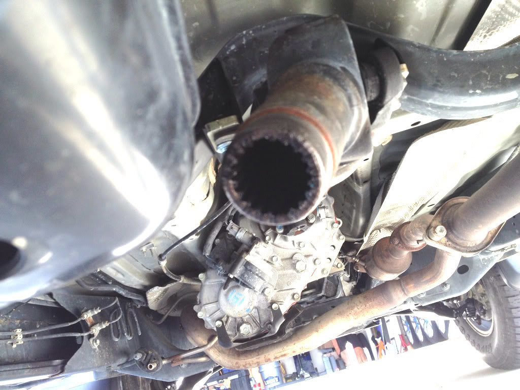

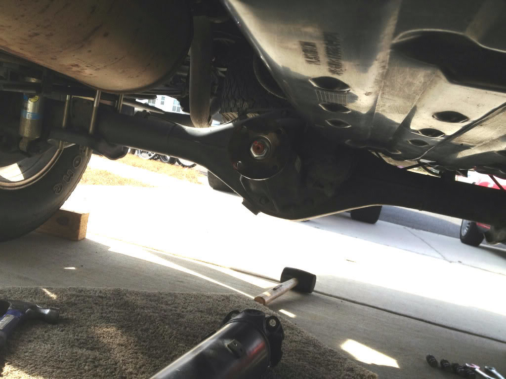

    I ended up doing this today, not too hard, and used Lucas Red N Tacky, Anti Seize Grease, it is a bit thicker then the Valvaline stuff I had on hand, and I felt this needs something a little thicker. I liked it, and once it was all put back together, the truck no longer has the thud/lurch, and it looked like it needed to be done, my truck has 110k miles and it has likely never been done by the previous owner, and I hadnt done it either, till now.
    D035FD53-F2D5-474A-97F5-5202B7518A0C-128_e65fc023f4fa050fb39598d3ed210b66798cc106.jpg
    Stuck a bunch in the female end of the Yoke.
    DC4FB3E7-4D3C-4C18-B3E3-4AD44F272A62-128_a11c5a328371a6522f665ae7c28eb8c90199ee59.jpg
    I smoothed out the blob of grease into the groves, before putting it back together.
    I filled the bellows of the boot with grease too.
    5D26C735-5E94-4715-A410-F3E1C08647A5-128_47ffb2784fedaae2a42772e4b0fbad2a9d733e81.jpg
    All back together, I got the factory clamps off ok, but didnt want to bother putting them back on correctly, also have a feeling I will be doing this again.

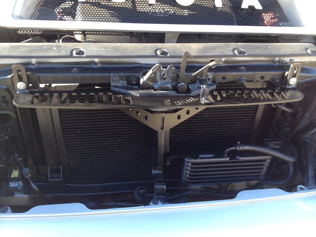

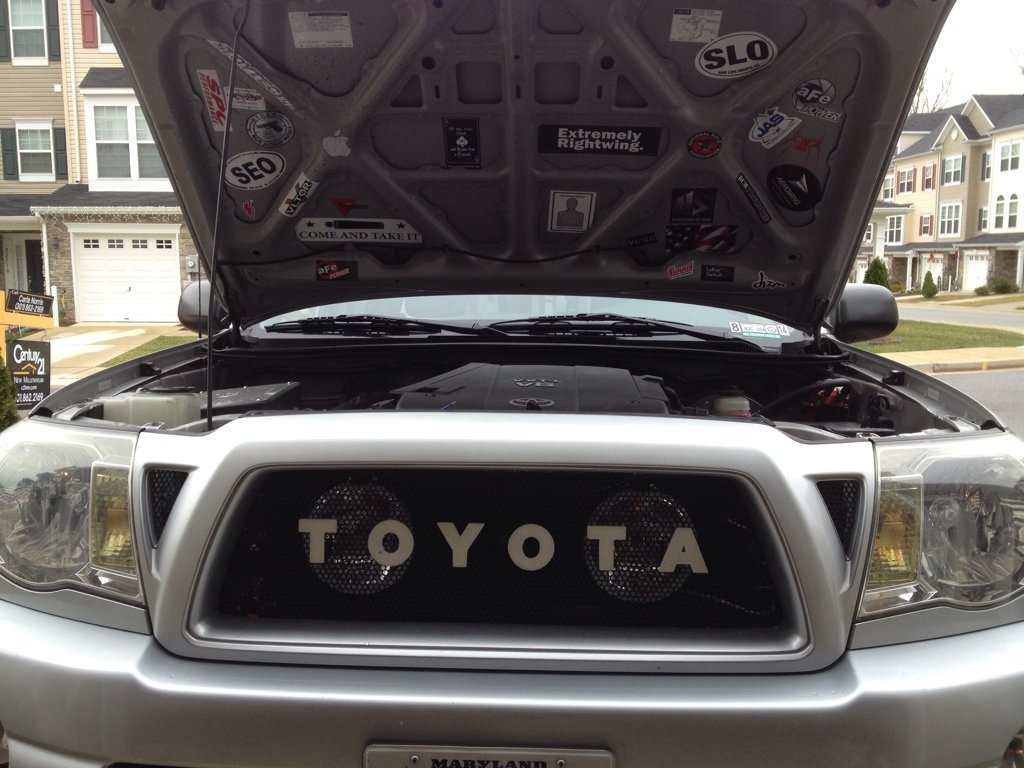

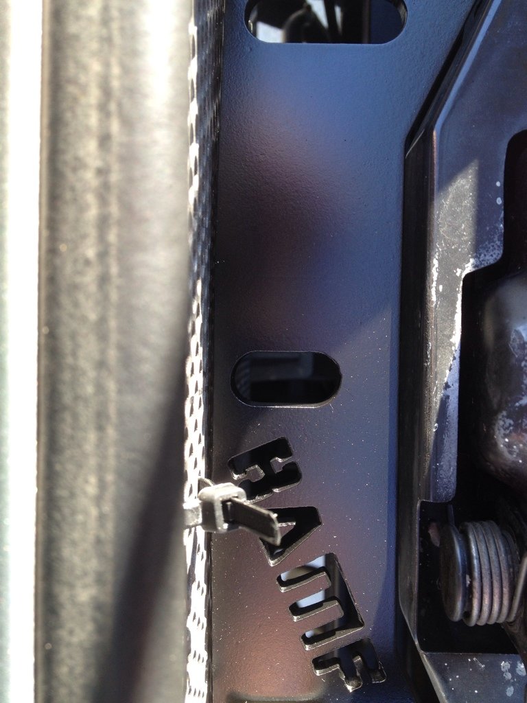

    Did the CMC with the BAMF plates the other day:
    E24F3E80-9665-48C8-9D74-F73748A45463-132_5b7e98fbf9d86f9e3e4a60eeffc71b985c2ab73e.jpg
    C8A3878E-E029-4EF9-BBB3-56FB21B8027E-132_cbcf1ee3922c1ed96981bc150175fb74bb3ef737.jpg
    FA41D13C-3753-4C6A-B486-D3A4E8387AE0-132_288cf18a8569c5d91759978b0b74cbb7364a1071.jpg
    68E67F23-FB3F-4D80-A795-85C7D9CD6357-132_cc254bb7e50f6a3501cd3b00e912b6175d4905f4.jpg
    C348E47A-D52E-414B-859F-301A638A993C-132_d4b2a40619442a2da6f0d46522a09cbdb60b9a11.jpg
    1A83E9F7-9A70-48B5-82EB-A8124CBEEBEE-132_1be41f296cfd33115f9b02bc5b3b8d62249e12e3.jpg
    I also added my new BAMF Light Bar
    461334E1-6D2D-4A7E-A242-B50ED3CEBD5A-132_d0357138ed8afb473483e6d3c569bf955563f227.jpg
    A perfect fit behind my Satoshi
    7254E4BF-6C1A-4288-A007-D88C72E45177-132_fcde7290febfc10f98ece37fa7ad28bda10deb3a.jpg

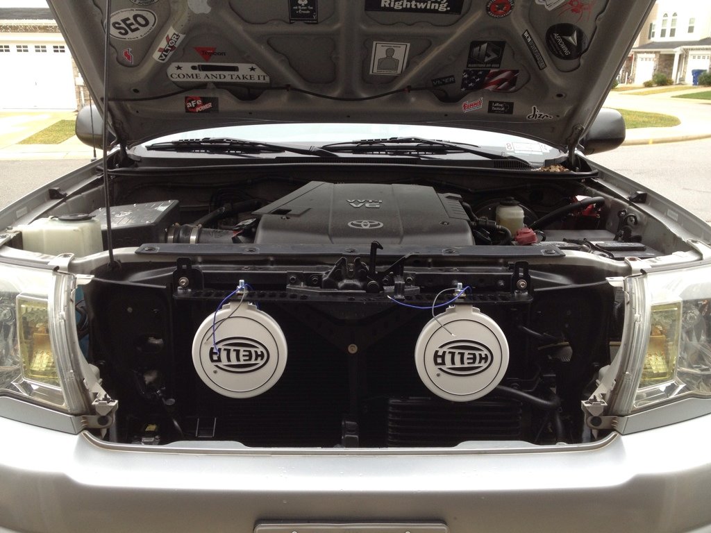

    Installed a set of Hella 500FF Driving Lights on my BAMF Light Bar:
    C0C895A5-9C4F-486A-819C-D3AD99408D53-263_8fdeae9c932eba64ea7b5d00627d26753bff76e3.jpg
    2D3F0F66-8643-4AB3-81F4-AD7C8B4CE804-263_f094e95c5ca9f8348bcf1ef58618b854953b2ec5.jpg
