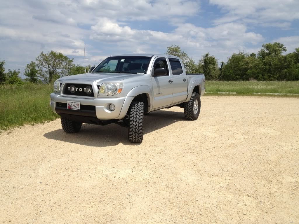

    Bought a used 2006 DCSB TRD Off Road 4x4 in 2011.
    Truck:
    • 2006 Tacoma Double Cab 4x4 4.0L V6 with TRD Off Road Package and Short Bed. Bought it used with 97k miles on it, but it was in near perfect condition, looked like it only had 20k miles on it.
    Suspension:
    Wheels and Tires:
    • Stock Off Road Rims.
    • 1" BORA Wheel Spacers
    • TRD Center Caps
    • 285 75 R16s Firestone M/Ts
    • BAMF Cab Mount Chop Done.

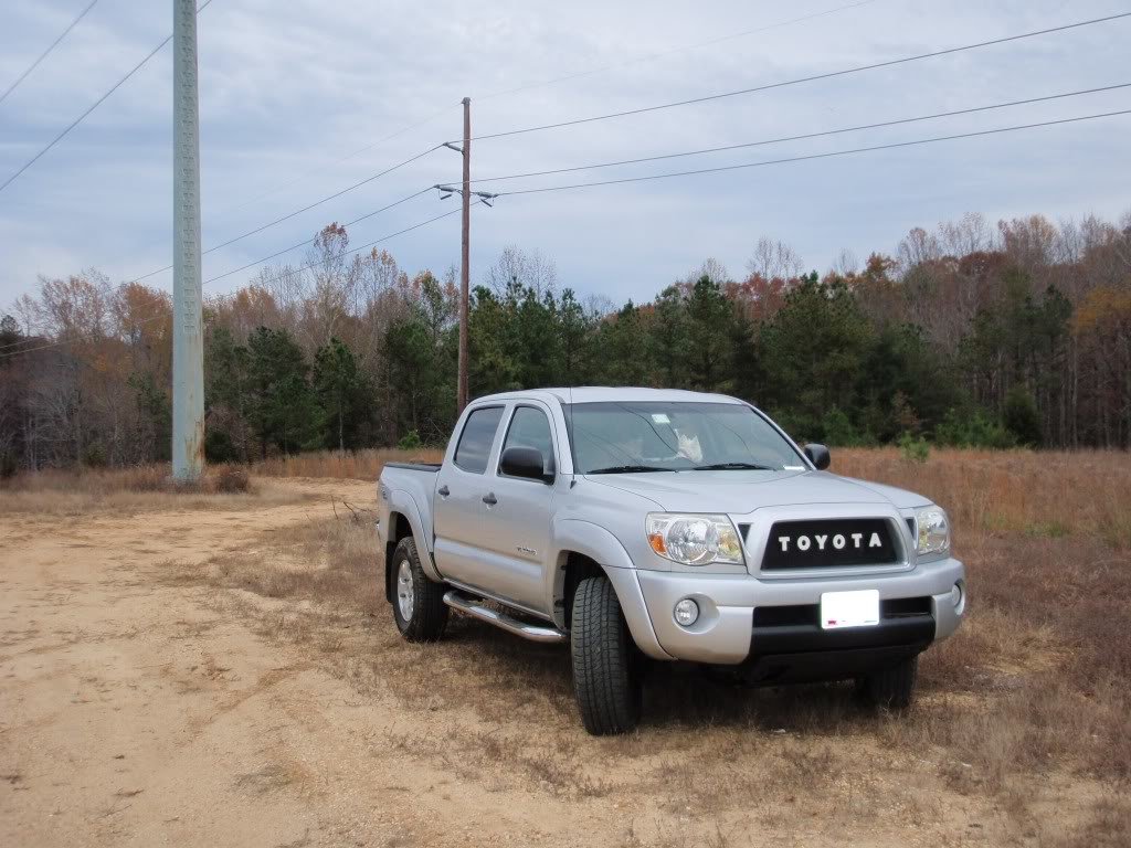

    Pics:

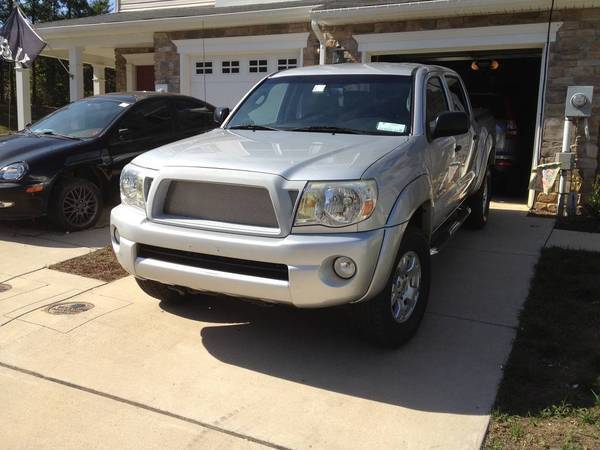

    How it sits now:

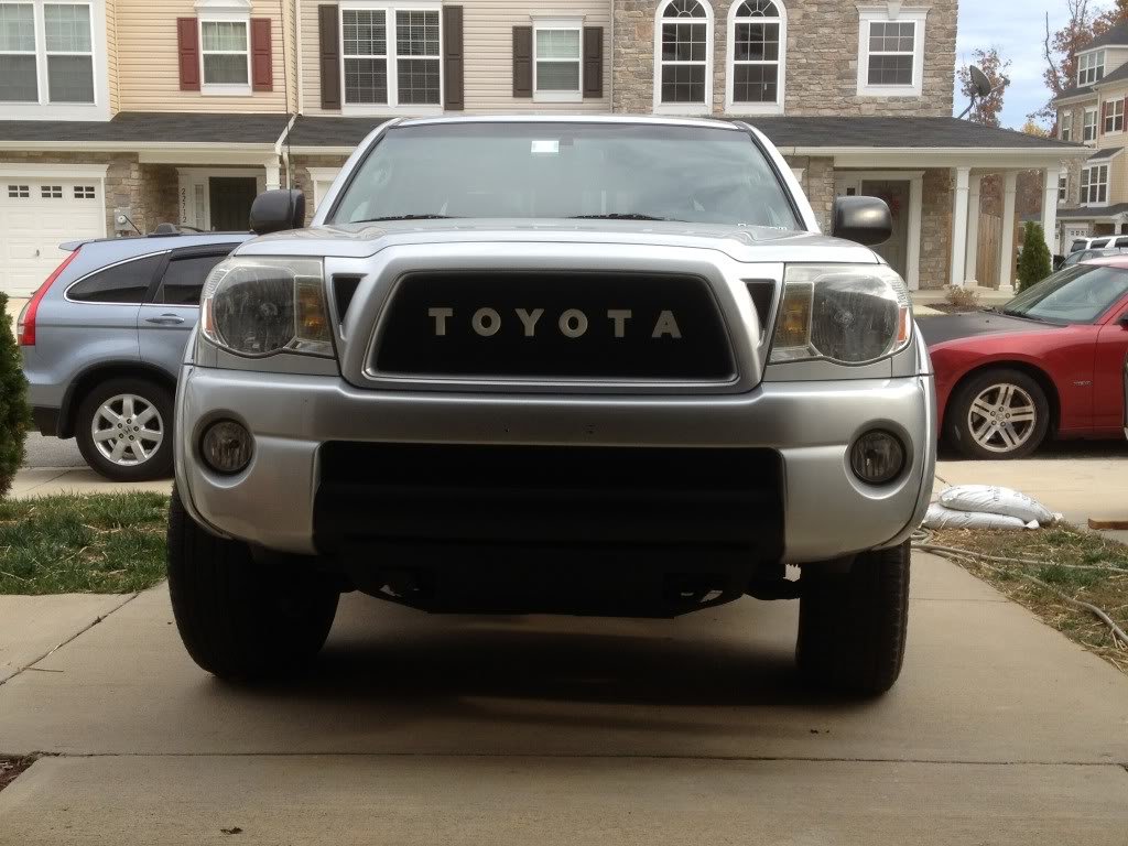

    My Custom Satoshi:
    More to come...

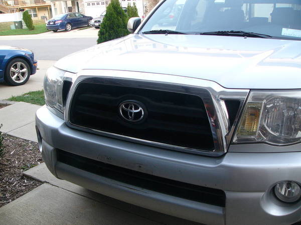

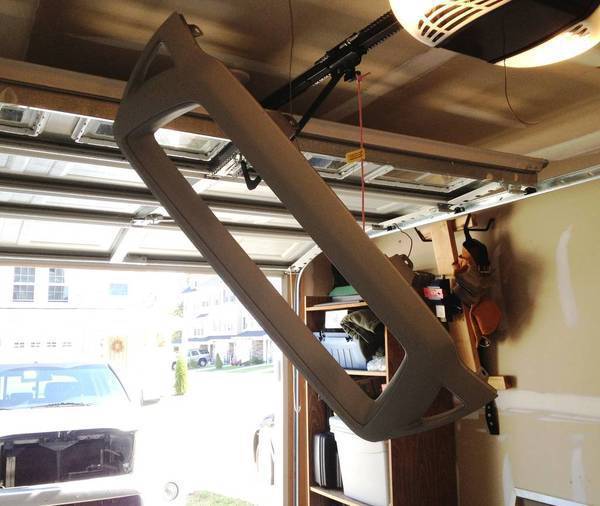

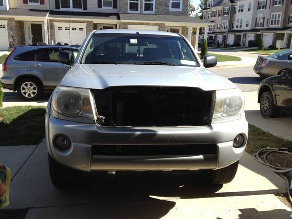

    My grill when I first got it home:

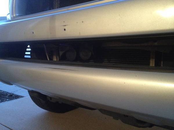

    Truck in Work, and I moved my horns out of the way:

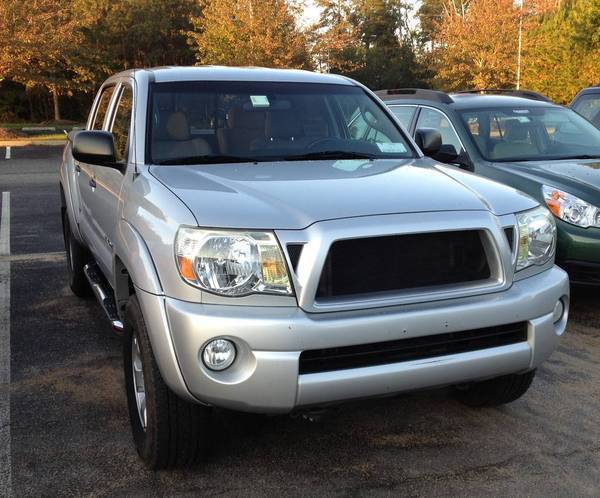

    Mockup before final paint:

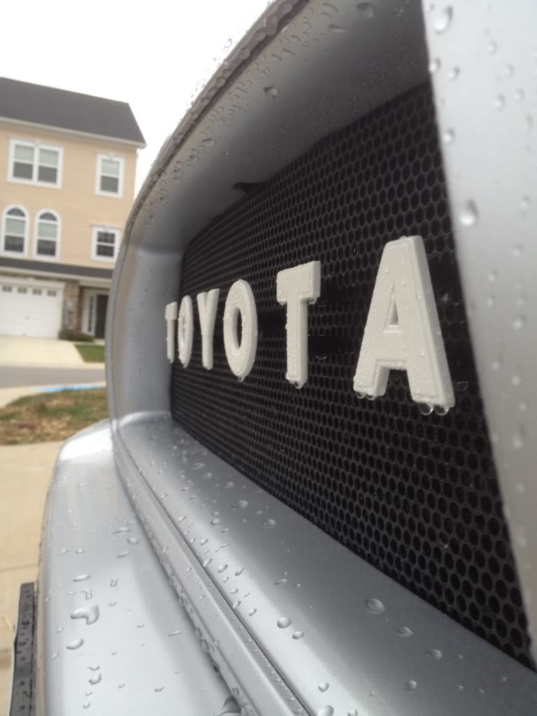

    My new almost complete Satoshi Grill that I color matched:

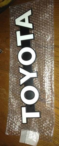

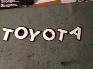

    My Emblem showed up: (Part # 75311-90K00)
    After some Dremel work, now for some hand sanding:

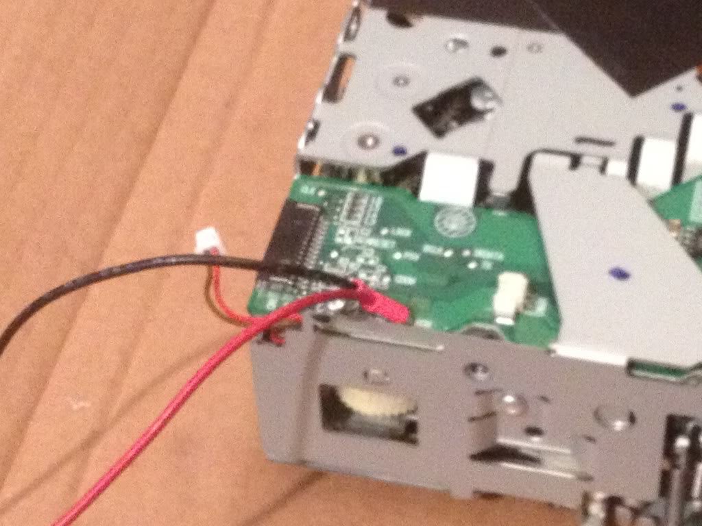

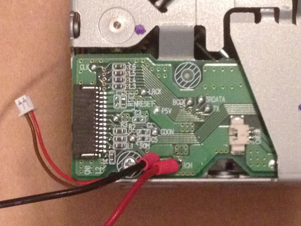

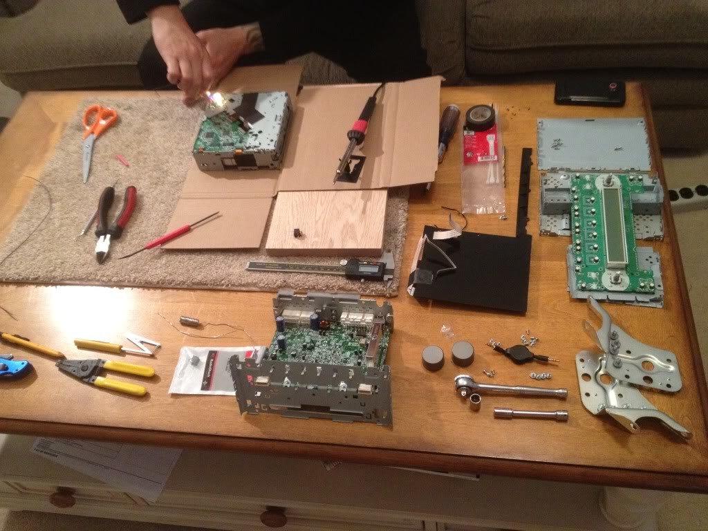

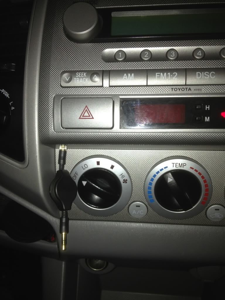

    My head unit in pieces, about to solder in the wires for the 1/8" audio in line:
    All Wired up:
    Head unit installed and everything is working, unlimited Pandora in my Tacoma!

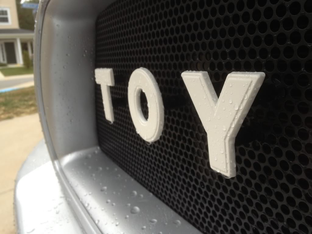

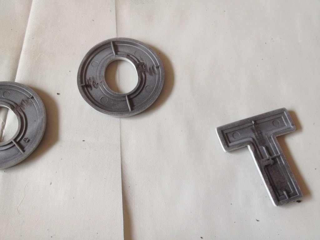

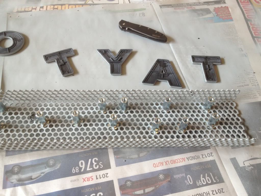

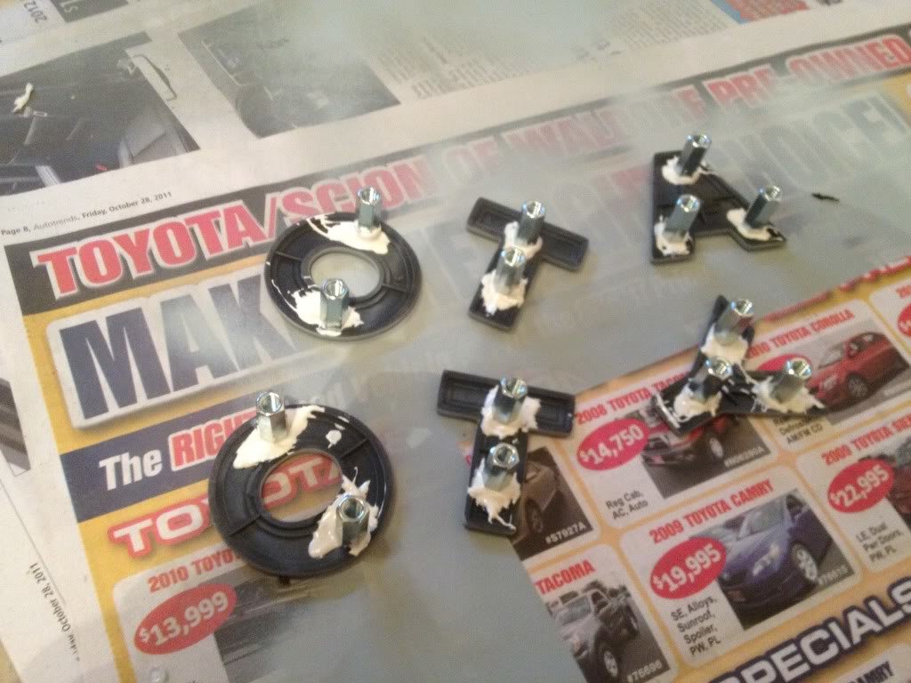

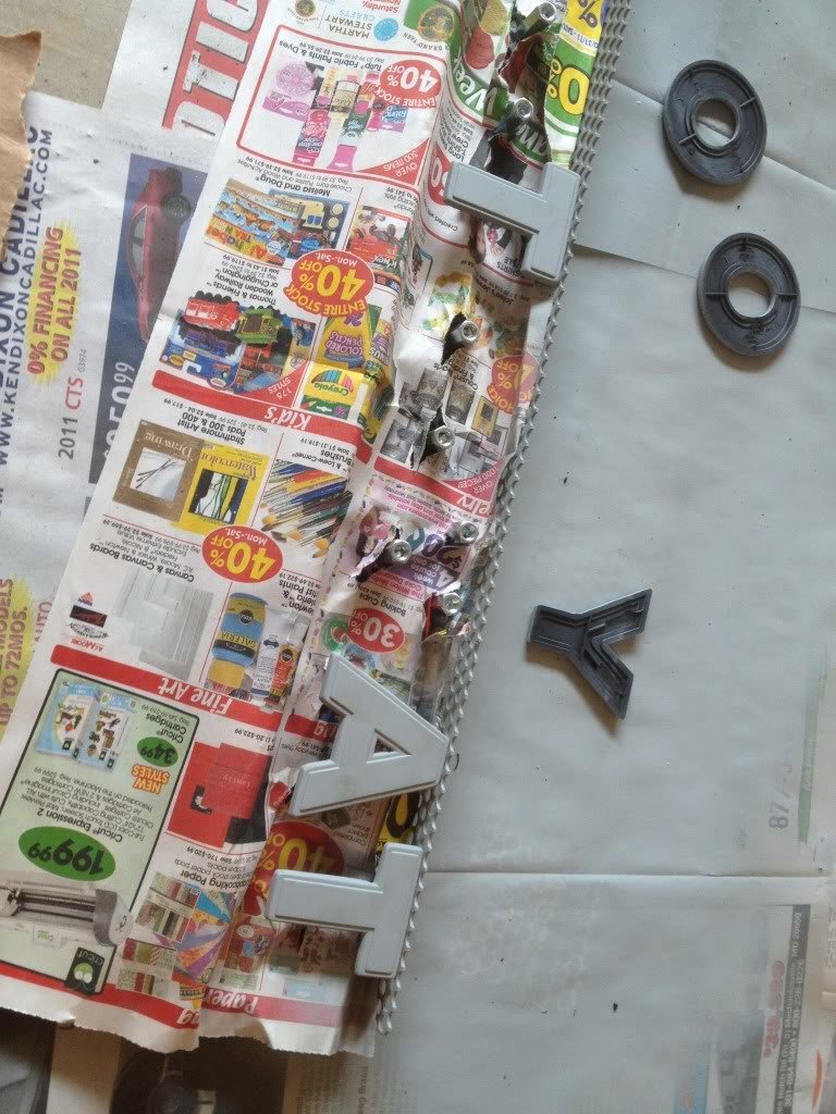

    More work on the letters:
    About ready to epoxy them the the stand offs:
    Half way done:
    Removed from the mesh and ready for paint:

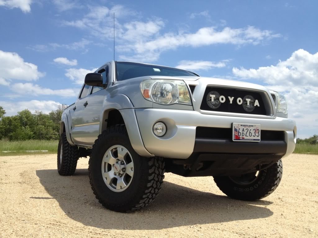

    On my Truck:

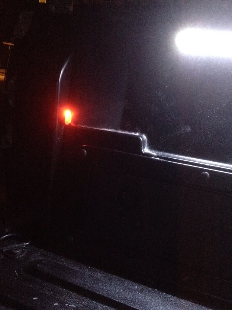

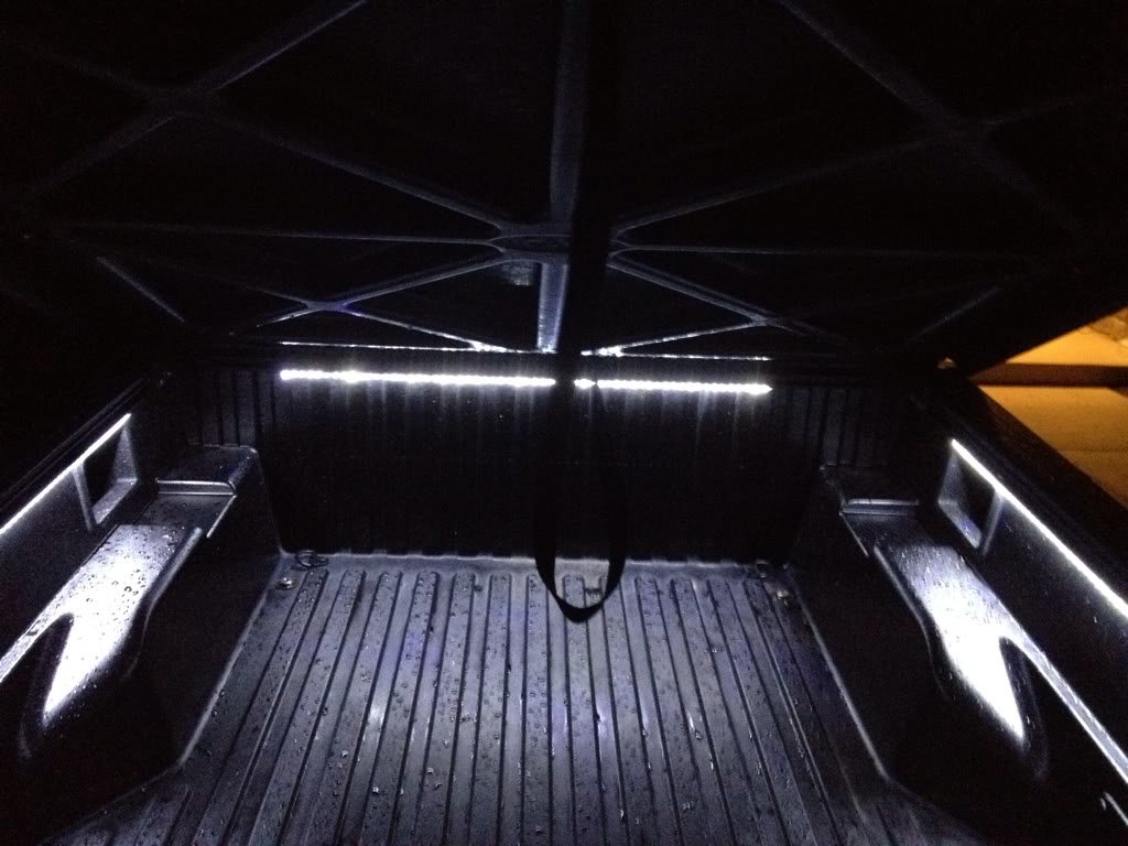

    Added white led strips in the bed, running off a sing switch that is wired up to the horn fuse for constant power even with the truck is off.
    I drilled small 7/32" holes in the bed to run the wires to ground and power, I am sure a few go you would disapprove, but this worked out great, completely hidden wires.

    Did you sand the chrome before you painted it?
  6. Nov 20, 2011 at 6:44 PM
    goufcustom
    goufcustom [OP] 7.62x63mm
    Oct 3, 2011
    #64586
    1,307
    MD
    2006 4x4 TRD Off Road DC SR5
    Bed Topper, Diff Breather, aFe Cold Air Intake, Satoshi Grill, Moved Horns, Oil Catch Can, Tailgate Lock, Husky Mud Flaps, H4 65/70W Bulbs, Lower Grill Mesh, TRD Skid Plate, LEDs in the bed, LEDs behind the grill for accent lighting, Parking lights as turn signals, LED turn signals and reverse lights, 5100s up front, eibachs up front, SS extended brake lines all around, 1.5" AAL in the rear, Relentless Fab U-Bolt Flip Kit, ICON Progressive AAL, TRD Wheel Center Caps, HomeLink, Heated Driver Seat, Hella 500 FF Driving Lights, BAMF Diff Skid, BAMF LCA Skids, BAMF Rock Sliders w/ KickOut.
    Yes, started with 220 grit and finished with 600 grit and then primed it once and then bondo'd a few spots and sanded and primed again before color matching it.

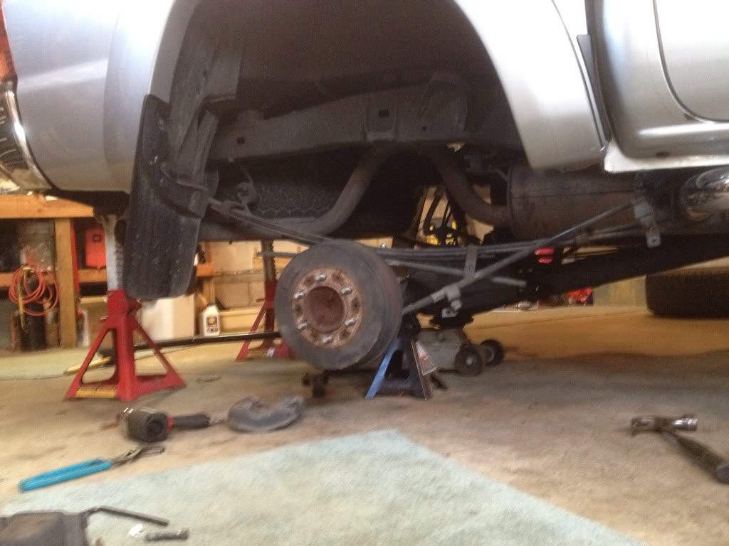

    Installed some AALs to bring the rear up to TSB leaf spring standards:

    I started two separate projects with the same waterproof LED strips from eBay today.
    First is strips for bed lights, one strip under each of the 3 bed rails, so I wired up the strips after I cut them to length, and added leads, and then put silicon in the ends to water seal them.
    Other end
    Went crazy with the electrical tape to make sure the ends were solid.
    Used some 3M double sided automotive tape on the back:
    That is as far as I have gotten here, got dark and dropped to 20 deg outside so no work on the truck tonight. I did test out the strips to make sure they still work after everything that I did to them.
    (bad cell phone pictures, they are much more white than this)

    Finally added my third strip of LED light strips to my bed, now there is a lot of light back there.

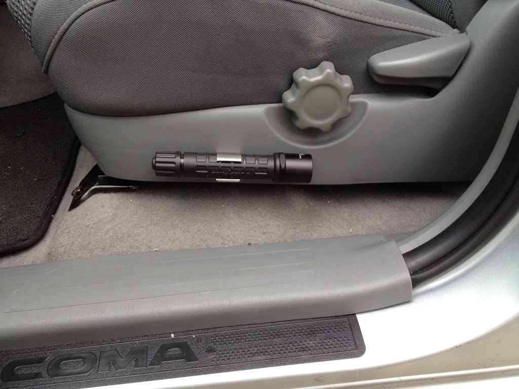

    Finally got a mount for my SureFire G3 LED, I found a M15 SureFire Helmet Mount, and I think it is going work great for mounting my light. Hope to mount it later this week.

    Bed lights look good man, I wanna do the same to mine.

    Thanks,
    Total cost on that project was $45, spent $18 on the LEDs on eBay, the switch was less than $5, and the wire cost about $5, double sided automotive tape, and the add a fuse to connect to the horn, plus some silicon and soldering time, it was pretty easy.
    It makes a huge difference, I use them all the time now, I can finally see stuff in the bed at night, my cover makes things really dark at night.
    Also mounted me Surefire today.

    Installed a new switch for my bed lights, this time I went with a waterproof switch, the last one fried when I was washing my truck...
