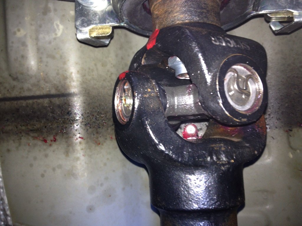

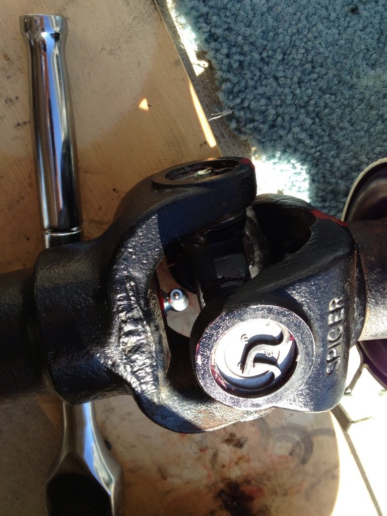

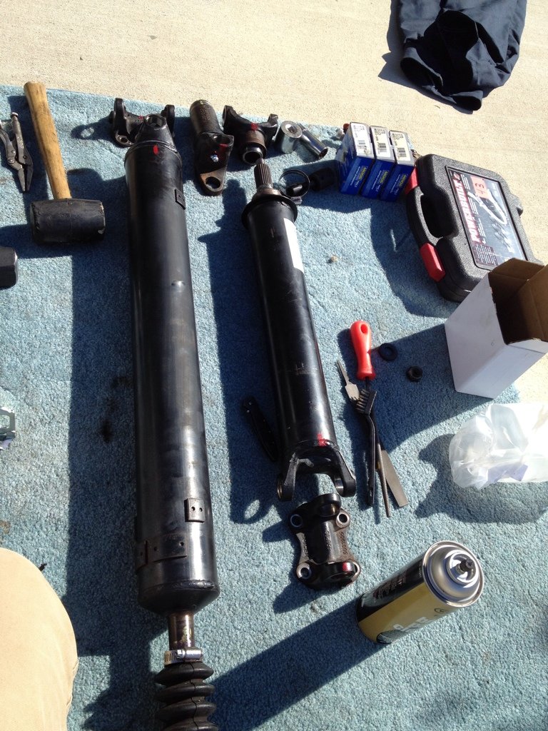

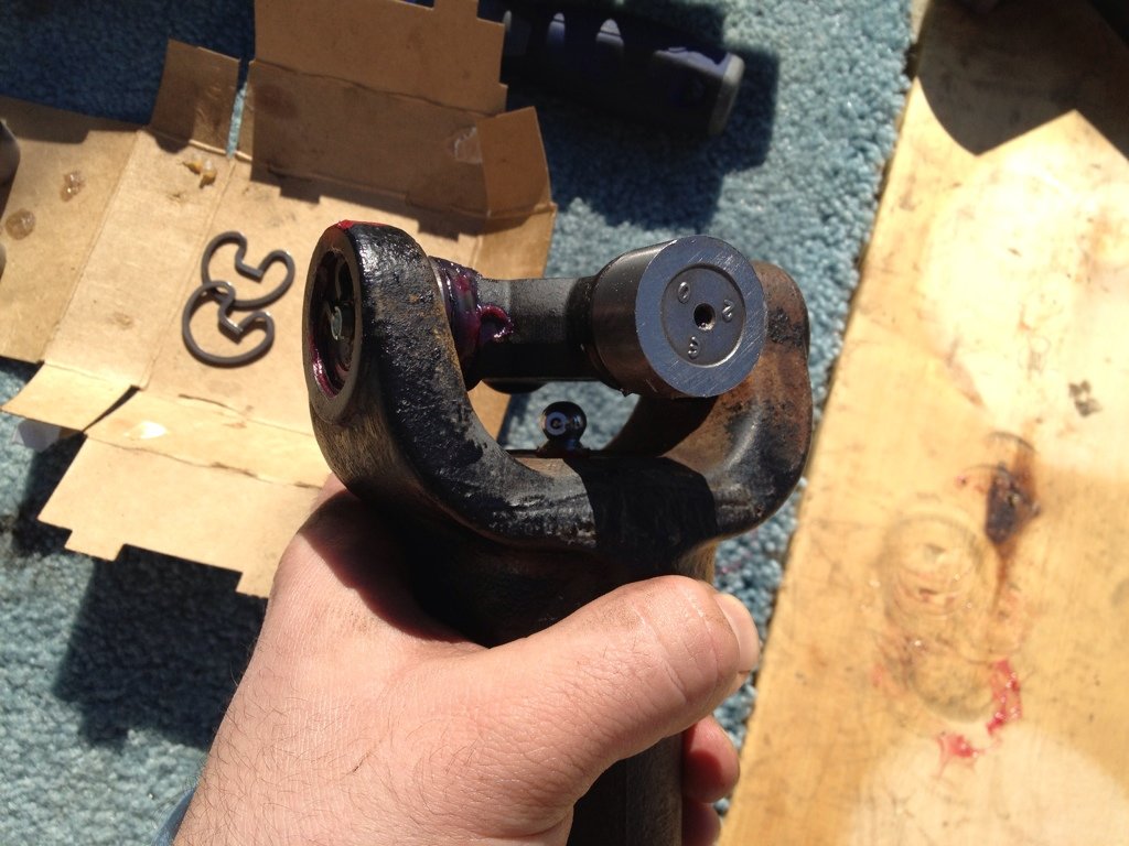

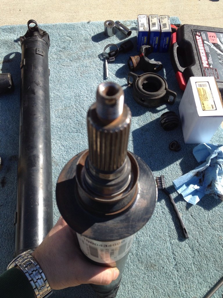

    I am rebuilding my drive shaft on my TRD Off Road 4x4, replacing the U-Joints and Center Support Bearing, and while it is apart I figured adding a grease fitting to the slip yoke would make things better and get rid of the axel wrap thud. I have been pulling my drive shaft apart and adding grease every 10k miles and it is a pain, so the grease fitting will make this much easier. I couldnt find any pictures, but I know there are a few folks that have done it here. I was going to do it myself since it is really easy, but I didnt have the proper drill bits, tap or grease fitting, and I just haven't had the time to do it. So I took it to a local shop and they charged me $50 to do it, got it back in 24 hrs and I am pleased with the results so far.
    This is what it looks like, the shop checked the clearance with the old U-Joint and said there were no clearance issues, I will post some more pictures as I put it back together today.
    055B2F08-440A-4912-87DC-A921B5302BF6-403_7761eadc9199a0eb7d1e8ad9fc491b52e621324b.jpg
    B2B3B1F1-4703-4183-8B1C-F0556224E95A-395_53244afef9d7c6fb180c25e2bb520fbf11c7c122.jpg
    Some more pictures:
    CE10B123-CC39-4F5C-8BFF-EF90C8E034EA-440_a781ead217172656adf812b96cabe5d4f32a0de3.jpg
    D81830D9-05FC-4513-9EC0-C3B6CA0C6D97-440_4596722a28f498ac920e1059b081fcb8fe2edde2.jpg
    C513F6B2-DC59-412A-8BD4-2C2C4F77C650-440_06e9aaec5484c7fffc870106d74cc7f711954dde.jpg
    Fully Assembled
    - There are no issues with clearance, and a standard grease gun tip fits in there for east greasing.
    16112843-5E38-49D1-BE03-249665AFC6DB-440_ebfb559f625f2f652130efbd707b3ddc42ed10fb.jpg

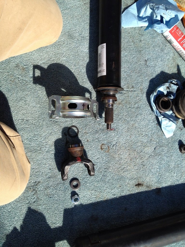

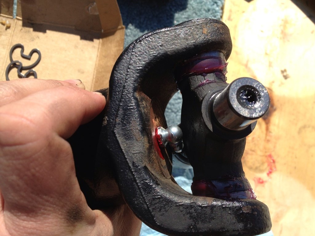

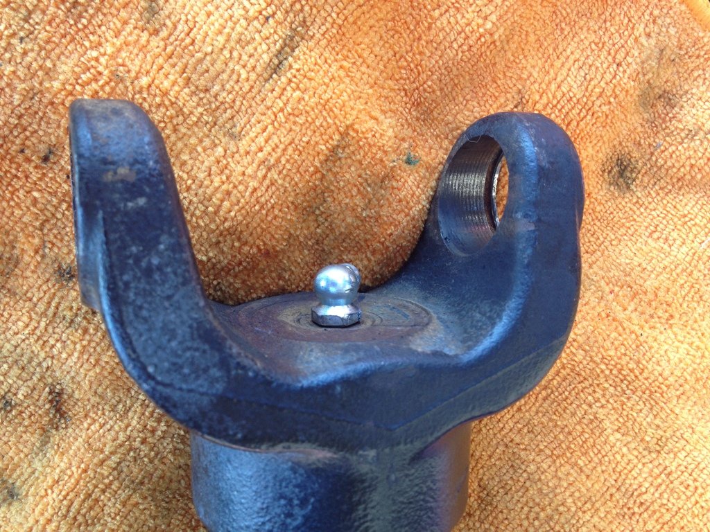

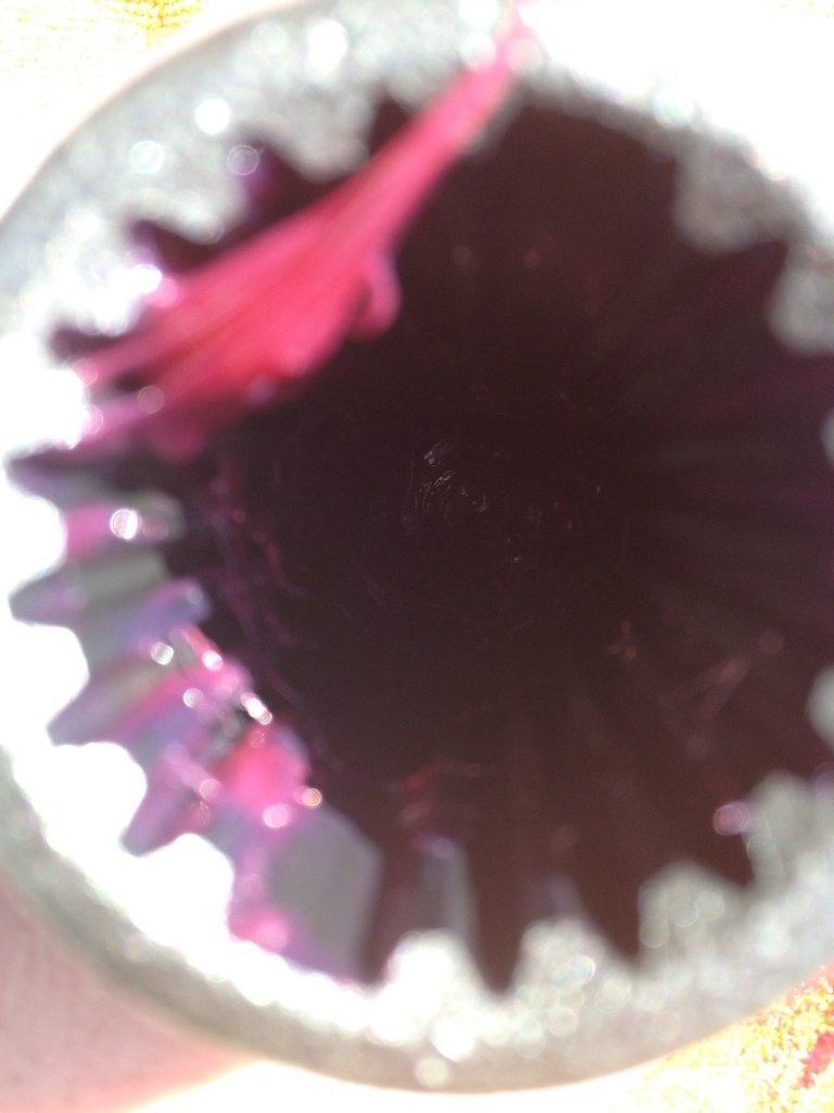

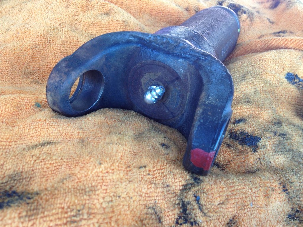

    Grease Fitting on the inside -
    424A0732-8AB5-42FA-BBF6-DC00978F9CB0-440_9d523a09f858d61dbef6a201fc5cdf4d6c506f38.jpg

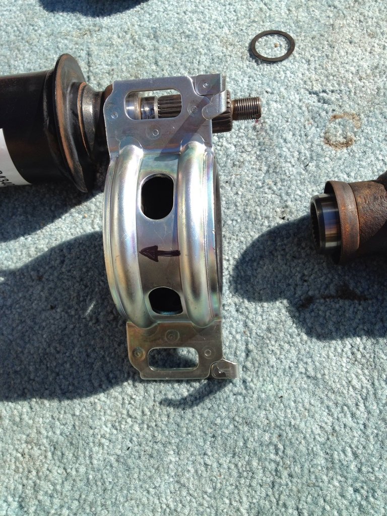

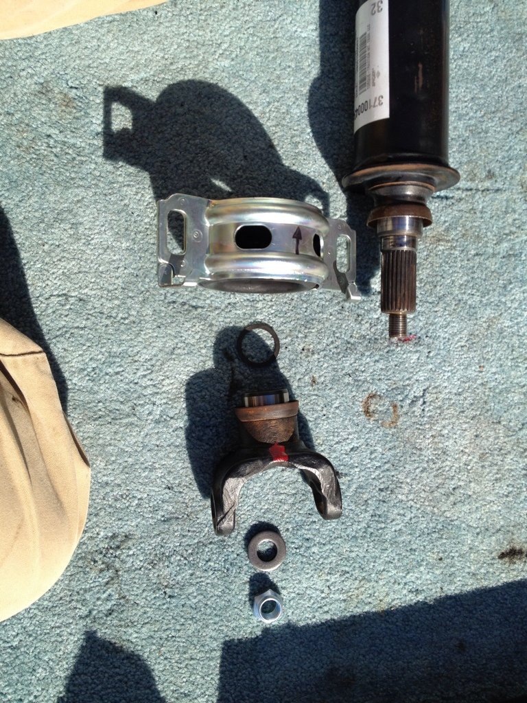

    NOTES:

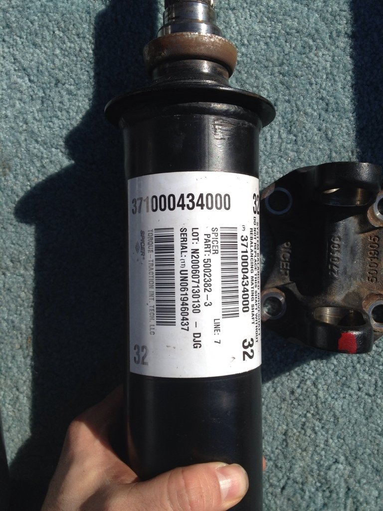

    Mark everything, so you can put it back together exactly int he same orientation that it came apart in, this is IMPORTANT!
    Also, I torqued the nut on the center support bearing to 135 ft-lbs and then backed it off and took it to 55 ft-lbs and then staked the nut. I used the nut to "press" the bushing on, and packed the bearing before assembly.
    Also, to get the ears that go to the U-Joint off, you need a 2-jaw gear puller, it comes off very easy with that. Then having a 2 or 3 jaw gear puller to get the old bearing off. I didnt take pictures of this because it was dark, and using a gear puller is pretty easy. I also used a vise with some blocks of wood to hold the drive shaft on the end ears instead of the hollow shaft, and used an impact to get the nut off.
    It doesnt make a difference to the functioning of the drive shaft, but I chose to mark everything on the side that had the factory grease fitting, which were all on the same side, so you can grease them all if you can reach one of them. Unlike the front drive shaft you cant spin the read when in N. I used some red touch up paint from my red Miata to make the marks, black marker was too hard to see.
    Other pictures:
    60179A65-5161-483F-9918-C14873C724B4-440_05bf5340db99ac0b5c77abf4f72e10f205fde134.jpg

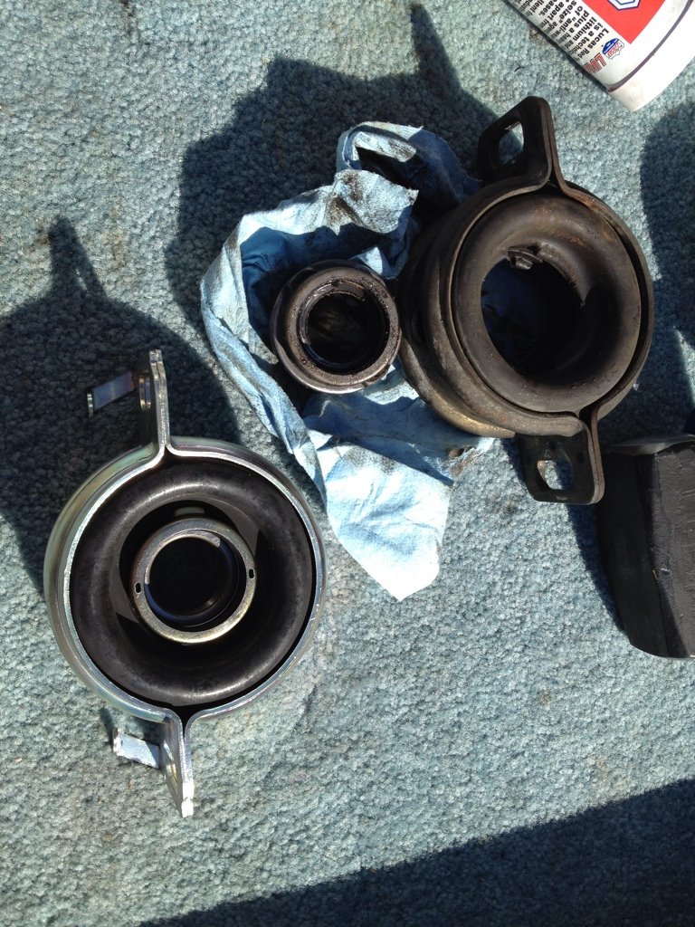

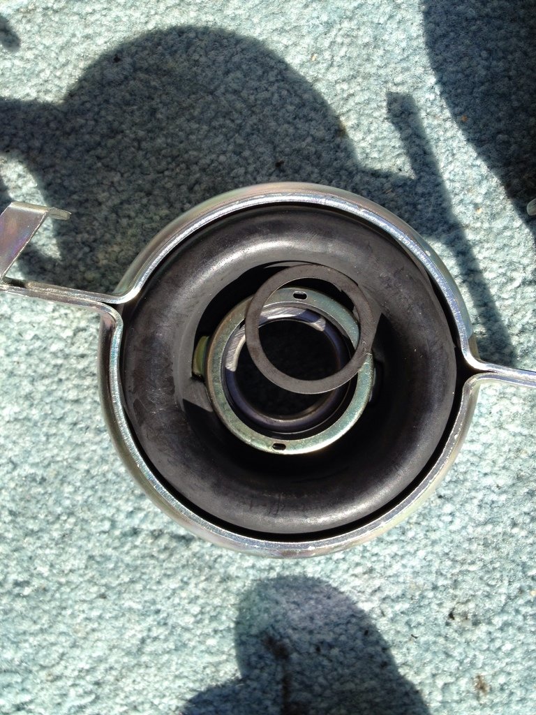

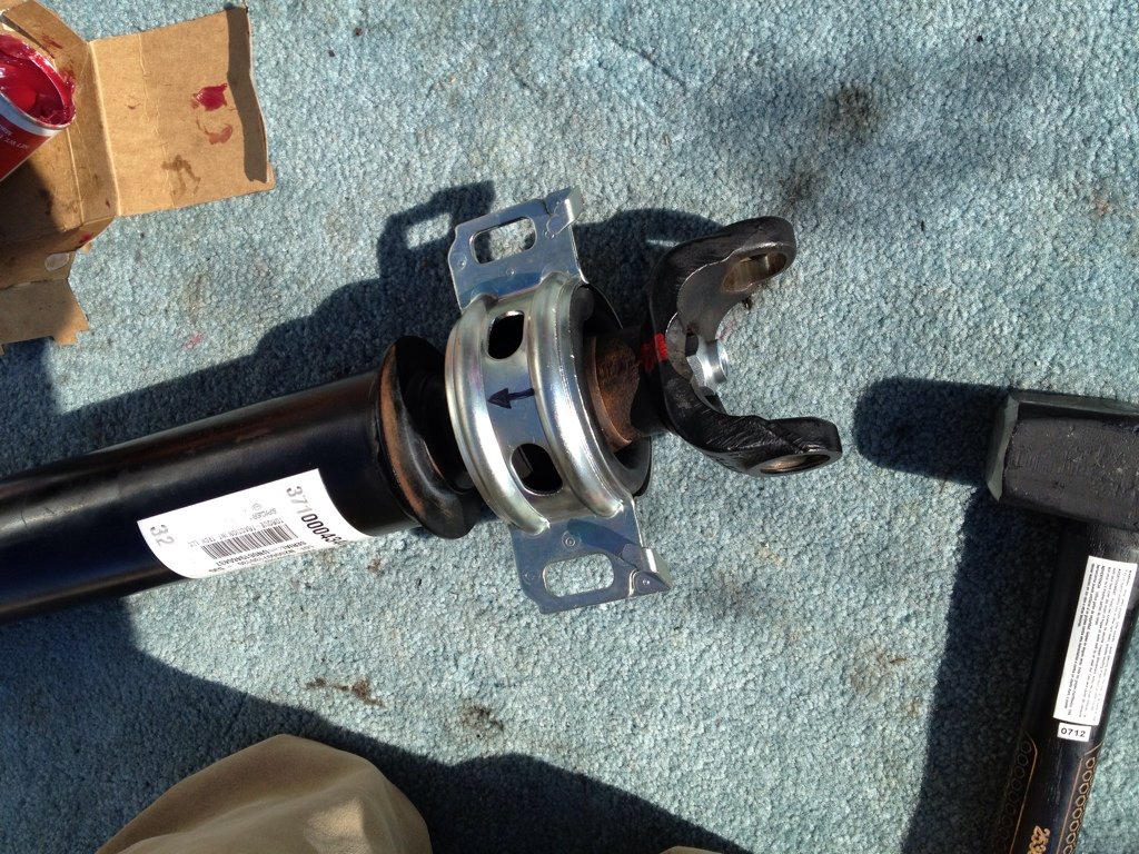

    Center Support Bearing (Carrier Bearing) Removed -
    EFA57CC4-C2A3-4B80-B5C6-9F5BC3337DD1-440_bd962252066dccce3b08f26fb4ae05b02783dbb6.jpg
    4055C96B-C8D2-43C0-B912-F5CD4103B50E-440_7ced0eef5c4b72373c1b270703c65d2f6ab4968b.jpg

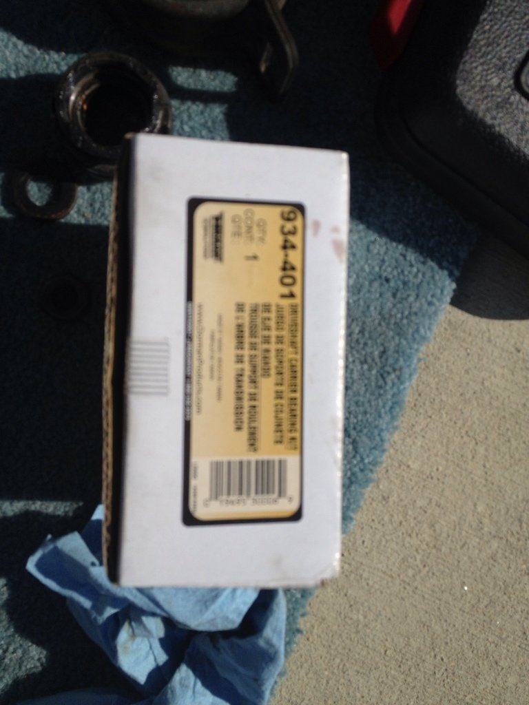

    The new Bearing - went with the Dorman, interested to see how long it lasts compared to the factory one, it cost $45, so I am taking the risk when compared to the $200 factory one.
    6A581901-06D9-4F18-960F-EDE5931A0850-440_3f6d29eb68d923ab398efe525749670911b98f50.jpg

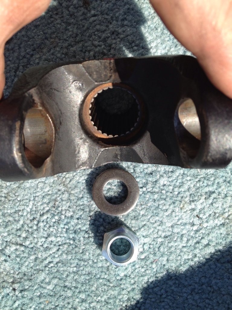

    I bought new washers and nut for re-assembly, you dont need them, but my local Toyota dealership sold the 2 washers and 1 nut for ~$5
    This shows the order for re-assembly with the washers.
    27668A14-EADD-42BD-8B15-94271E04D25E-440_1d061bea081973fe831eecb7ca7b49ea68db0cd8.jpg
    Clean everything, and apply more grease to the spline an bearing.
    C6CE212F-787B-45C3-8763-6AADC8358CFD-440_02ced0cf953b95797a76a2ae54f5d11e87f2138d.jpg
    I marked the direction on the bearing, the Dorman comes un marked, and direction is key on this part.
    181AC78E-6638-4D66-B9CB-659778AEB3B5-440_3ea2205f77da9eebcd2bee6586b18e4a0a66bb53.jpg
    DFD9D601-69B2-4986-86BD-525A3F869C46-440_66f031c585138c2d16f43c028102e1fd21cc7091.jpg
    4BCA9491-9286-4979-ACF4-C2B700DE6B08-440_64d3471fabbf5cf3715265cc0acb8eeb584dfe36.jpg
    This thin washer sits inside the bearing, on the side that the nut it on, see the picture above for the order, it wont go together wrong without breaking something.
    AD5E3346-2AAD-4FB7-A555-243E81F4A422-440_4a30ccbf1d4846f72357ead922c02f7557075ba8.jpg

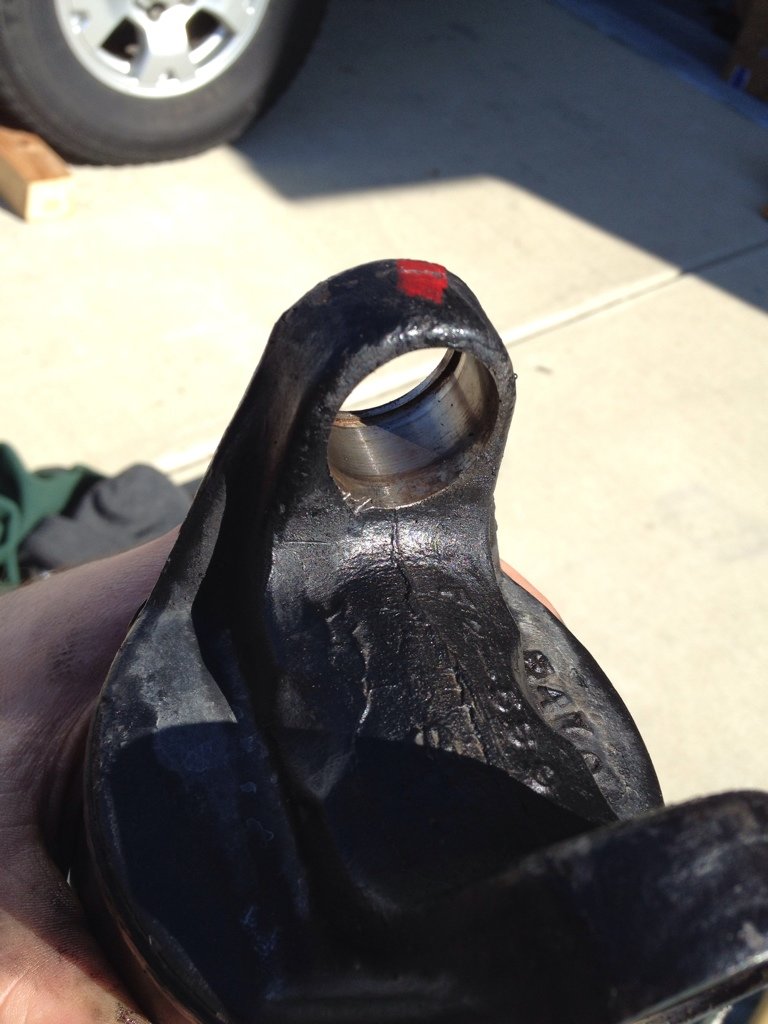

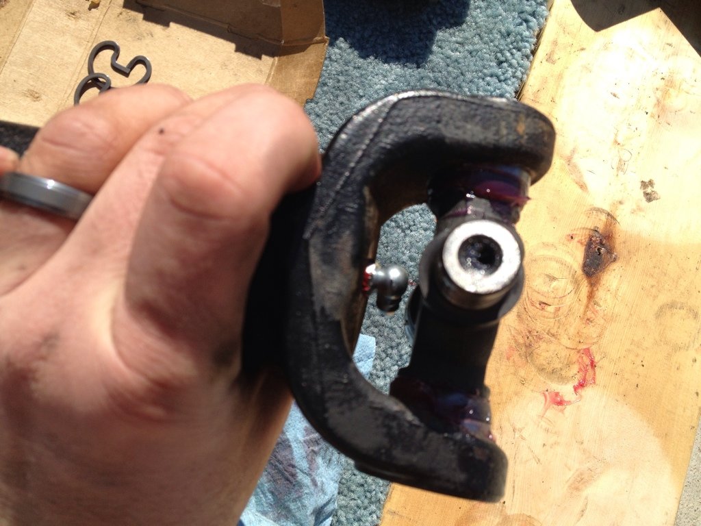

    Watch out for burs that are created when you take the old U-Joints out. Use a file to get rid of this. And grease the holes before re-assembly, makes it easier and prevents it from seizing.
    8F6A3628-963F-44DB-A8D2-775DC8F0458B-440_f9ec86ef3b1e26dc5e0a3f9b21f15b310195ca80.jpg
    COMPLETE -
    E0C4F9B5-152F-467F-831D-969FB3A95B48-440_7ba426bdbbd981897bfce72de27a701b45647d4c.jpg

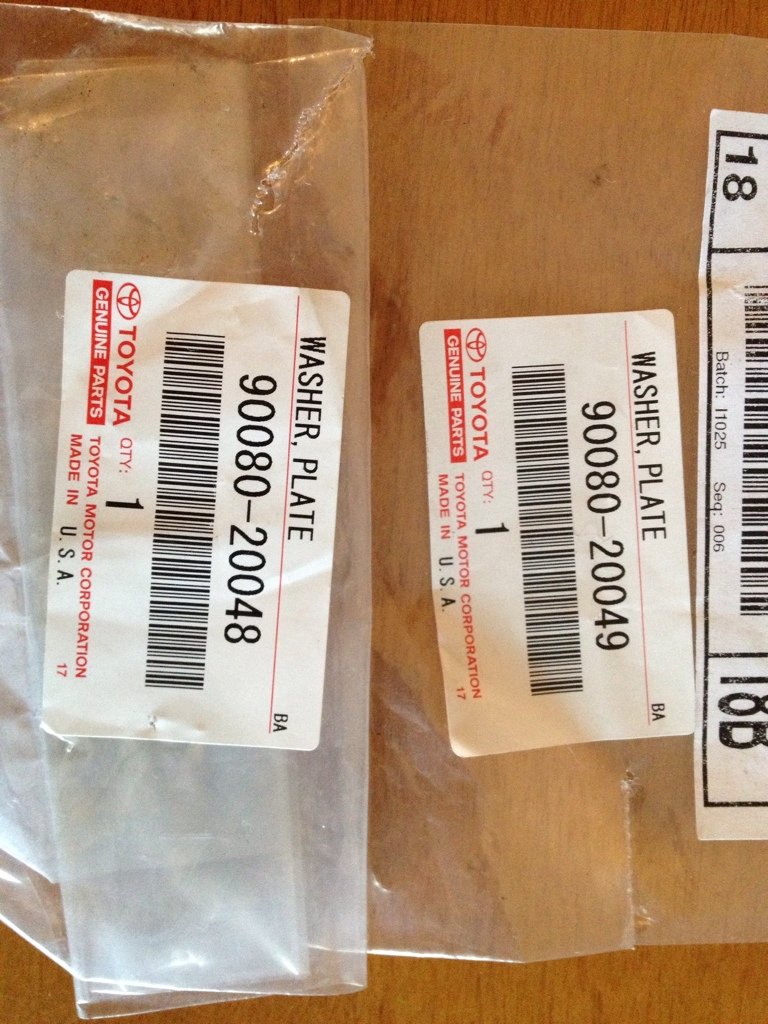

    Ok, so here are the part numbers for the two washers and nut shown -
    NUT - 90080-17083
    Washer - 90080-20048
    Washer - 90080-20049
    51B3EE5A-7FFB-403C-AC6B-D8A786EE68DC-833_bd47a534a0b47ef67888385c03853594e21a963e.jpg
    85D20BCB-AE84-449E-8E1B-E09F95126597-833_c440c9a378f834a67986622b48e0008ef44d6146.jpg

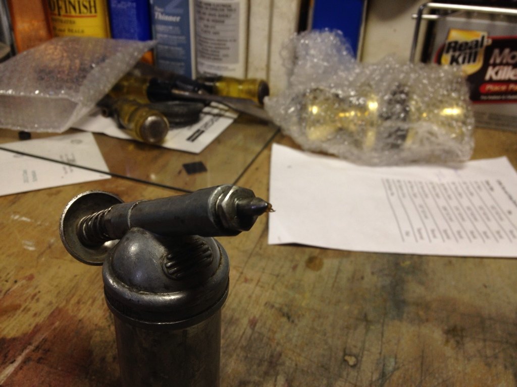

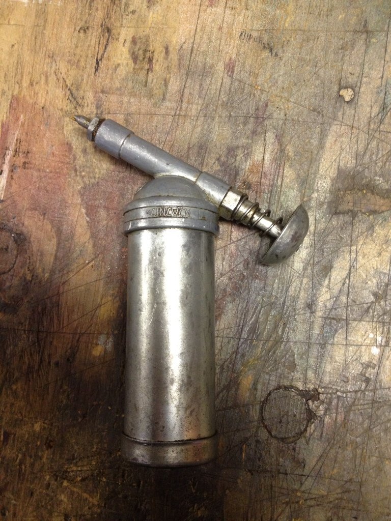

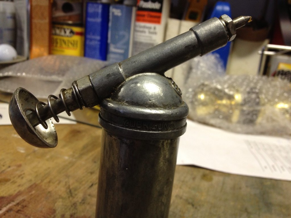

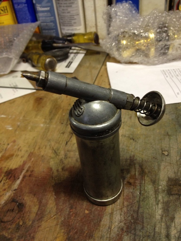

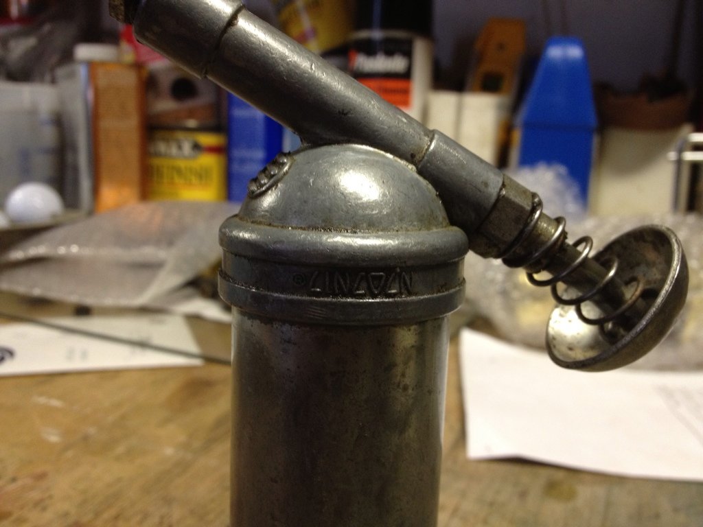

    Also, I figured out what to use to grease them- My father-in-law had a little hand held gun that he uses for his chainsaw, and the tip fits perfectly. Also the gun is rigid, so you can press into the center of the fitting, I was able to grease all of mine, took a little longer because the gun is small, but it worked perfectly. So now the task is to find one online.
    The one he had is made my Lincoln, and called the Lubrigun, and has a chainsaw tip on it, see the attached pictures.
    Here is what I have found online so far -
    (1) http://www.amickssuperstore.com/Dualco_Chainsaw_Grease_Gun_p/dualco grease gun.htm
    Dualco seems to be the best one.
    (2) http://www.mfgsupply.com/32-5801.html?source=googleps&gclid=CLzc-o_lz7UCFckx4AodKzwAIw
    (3) http://www.amazon.com/Dualco-Grease...361737927&sr=8-4&keywords=chainsaw+grease+gun
    (4) http://www.amazon.com/Astro-Pneumatic-Grease-Needle-Nozzle/dp/B000FMK7FG/ref=pd_sbs_sg_8
    No free shipping either, and about the same price after shipping as the better Dualco one.
    (5) http://www.amazon.com/Mini-Grease-short-Needle-Nozzle/dp/B0057GX4XW/ref=pd_sbs_sg_6
    (6) http://www.amazon.com/Oregon-Chain-...361737927&sr=8-2&keywords=chainsaw+grease+gun
    Some pictures -
    8F9B6C44-FE14-4CE4-82FC-A204EAB92FC2-419_0175a5340cf2d64a249ea3aaa141ae495379ded0.jpg
    98CDF23D-C62C-4555-B050-706CD34B2E00-419_e52883aa0584dbf41b5f946538f179cd3e199bad.jpg
    C1778ACF-1DA5-4AAB-B718-E39B4DB22B6A-419_5f3c2b197aa061503291d495293856a16c90fead.jpg
    47E522F1-2643-475F-864B-0FA2E59DADB8-419_aaf77637ea7b6a6b32de8507eb46256b90fa79ba.jpg
    0FD80415-7B85-4FDA-B7C7-EC0AFADC2282-419_78fac40f2985d2c50b5b30f291d01f7da1760bbe.jpg
    Another picture of the slip yoke grease fitting, so far so good, have about 1000 miles on it so far.
    5FB53062-22C7-46EF-8FA4-09D989D521B9-419_4d476fe9eb4b061f1eee6d98fe59ce46035e0e38.jpg

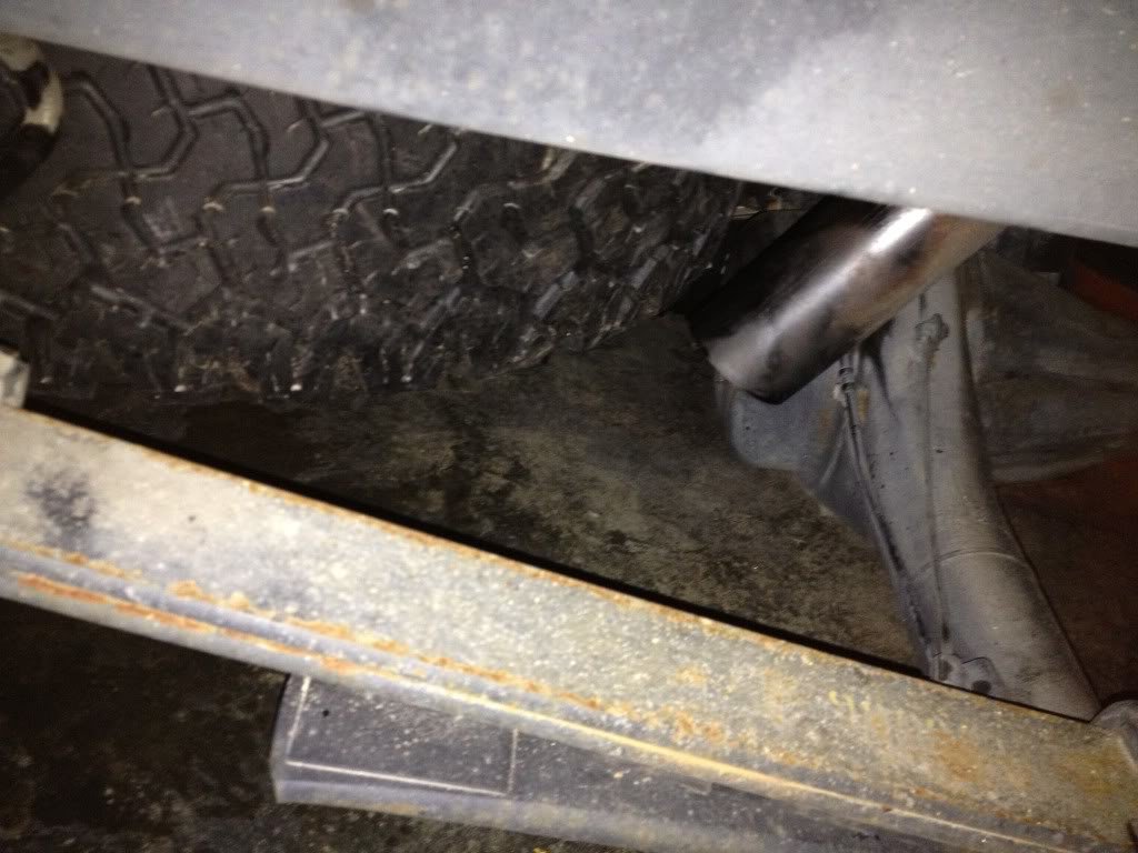

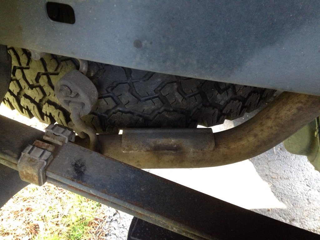

    I also cut these off so I could get my spare under the bed:
    It is extremely close to the exhaust:
    280ED631-9008-41CA-82A6-C661ECA72F37-138_4d7abfa415e7b8afaa16050a0d2d89067b09b261.jpg

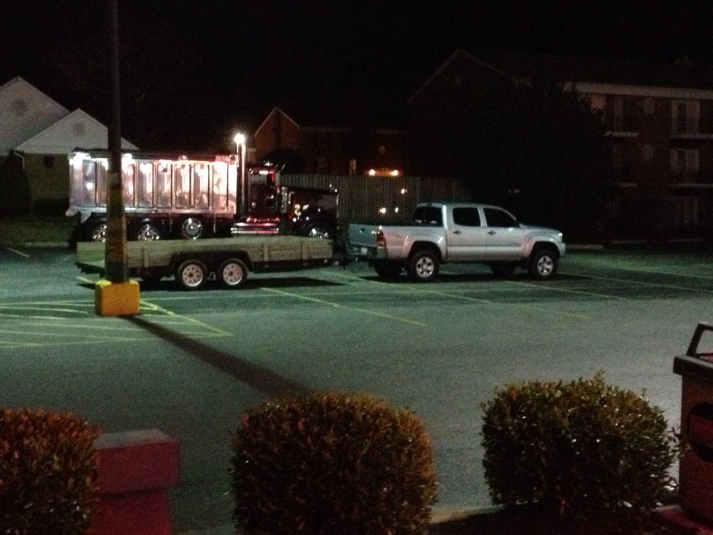

    Borrowing my friends trailer to move.
    All of my cars next to each other one last time before we move!
    91D4A5E1-FE35-4687-BFD0-28B4106FEE8A-697_71c4c1a9c42c9b95d78f593823ac2e2e27ddd57b.jpg

    Cut my exhaust so it wouldnt touch my 33" spare tire.

    Did some trimming, and now there is no more rubbing in the front in reverse. Not the best pictures.

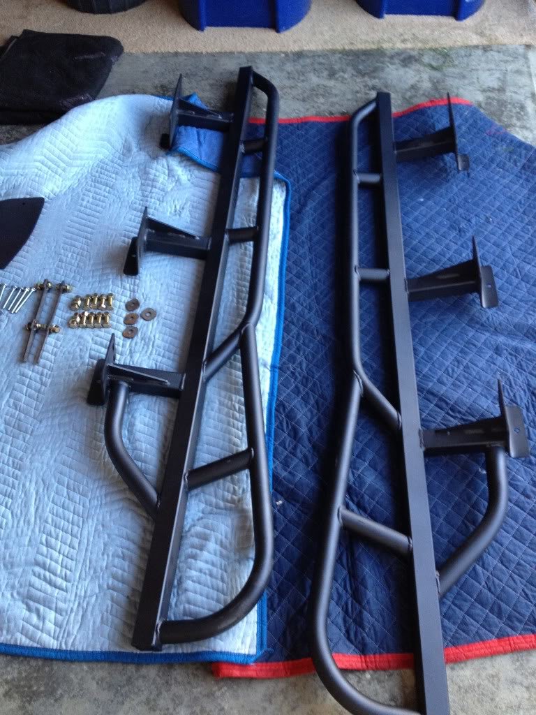

    I got my BAMF Sliders today! I also got my BAMF LCA Skids and BAMF Diff Skid, time to get installing...
    Looks like I need to trim the stock "skid" to get the LCA skids to fit.

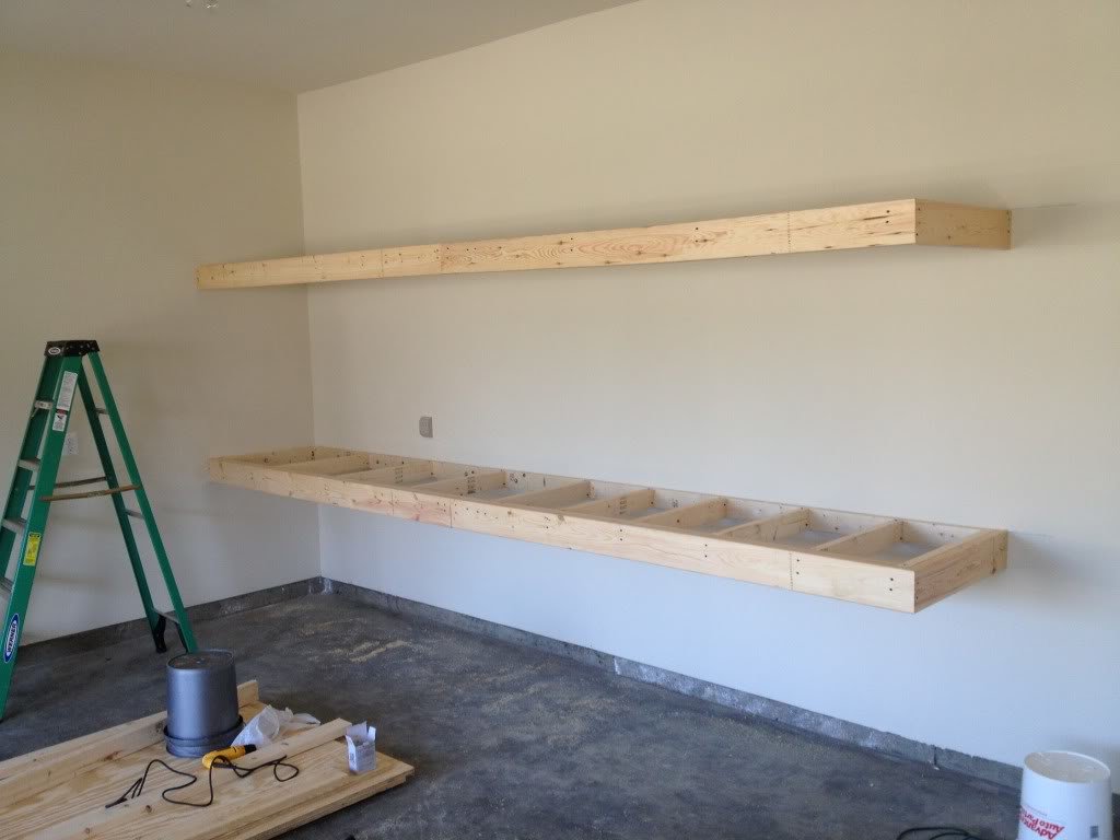

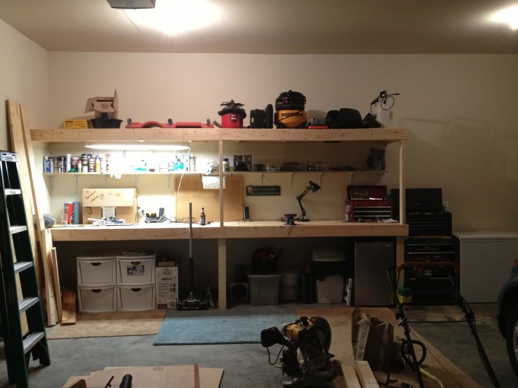

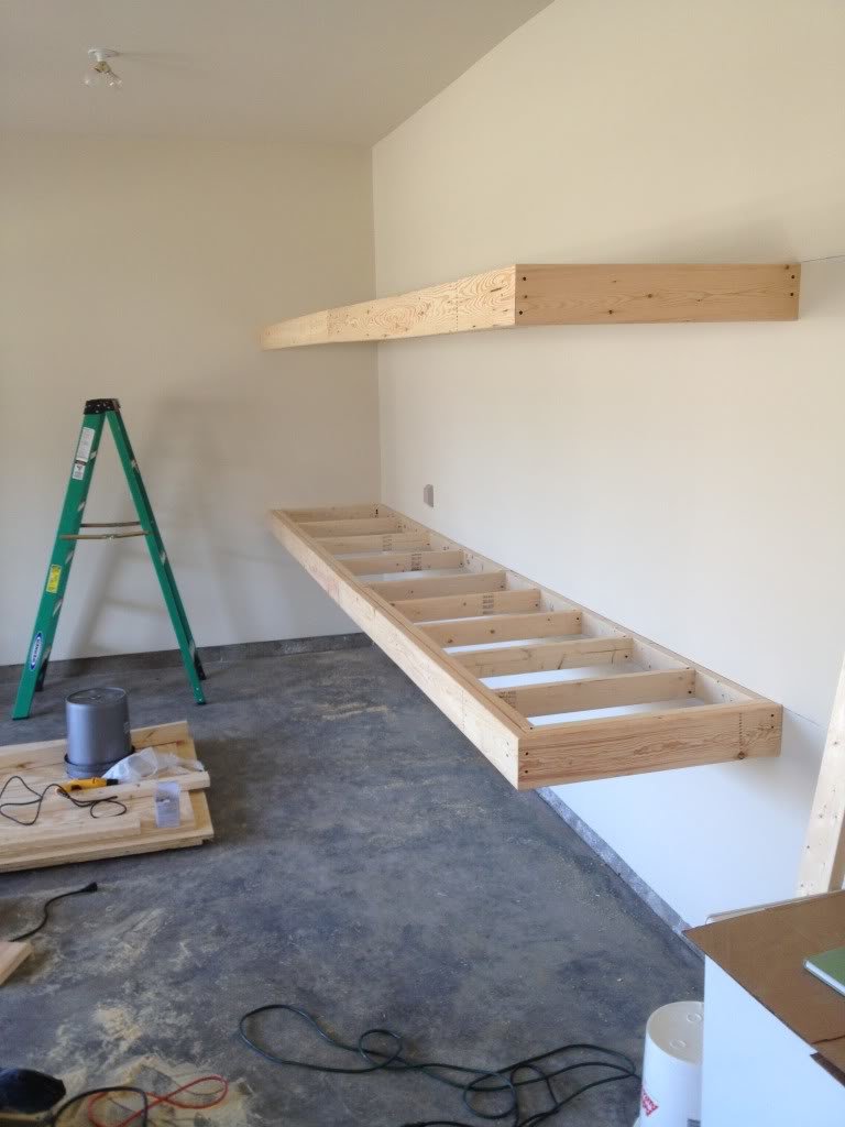

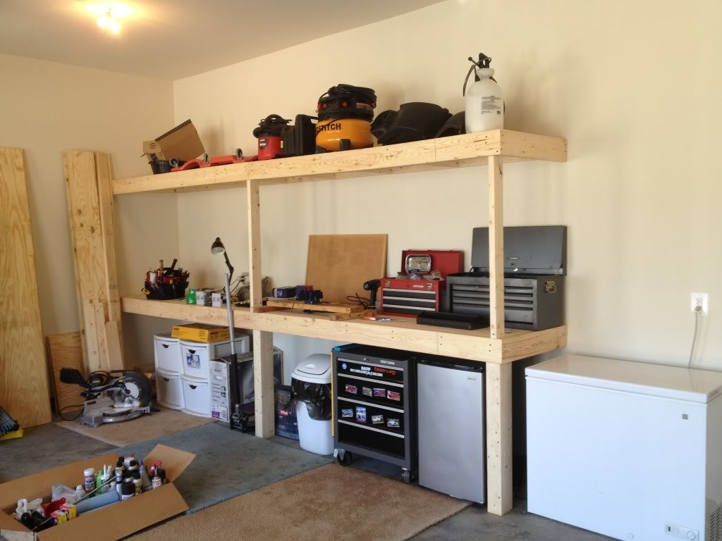

    Started building a workbench in my new garage -
    I have another shelf on the bottom to build and then start adding hooks. I got my old collage computer set up, it is almost 10 years old now, and still kicking, nothing fast anymore, but great for a garage computer to surf Tacoma World. I need to add more outlets from the basement up into the walls, and get another overhead shop light, but so far it is great.
