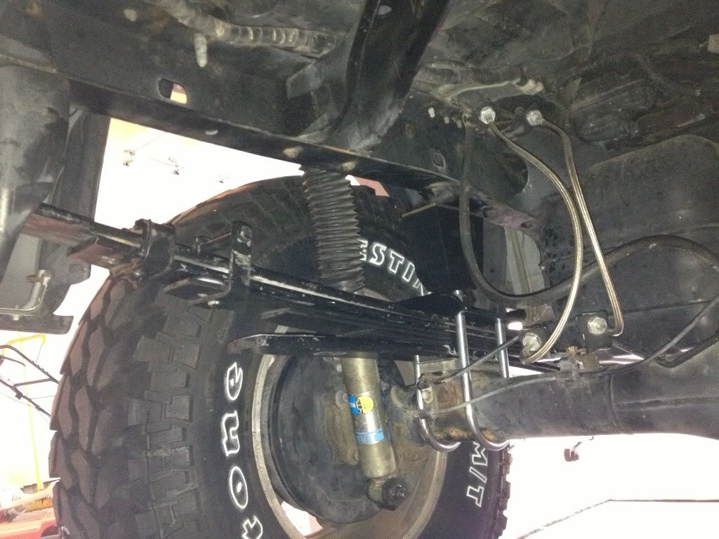

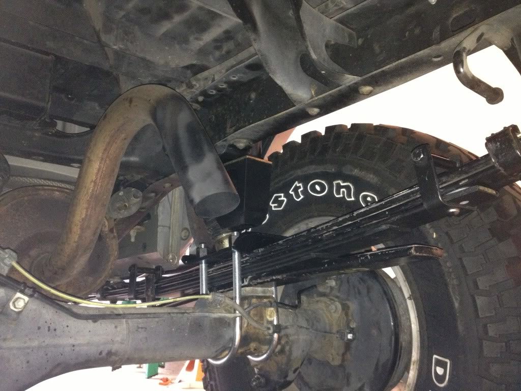

    I removed my rear leaf springs (w/115k miles on them), replacing them with a newer set of OEM springs I got for free (w/ 15k miles on them) and a ICON 3 Leaf AAL. Wish I had the money for a proper set of springs, but the newer OEM springs are going to be way better than my current springs. Nothing was seized! Going to put it all back together tomorrow and then start working on installing my sliders!
    So many springs!

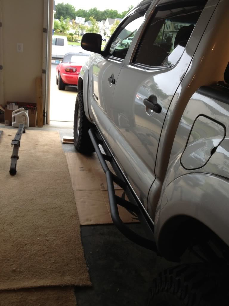

    Installed New Leafs and ICON AAL
    BAMF Bolt On Sliders

    I have the same rear setup and its great

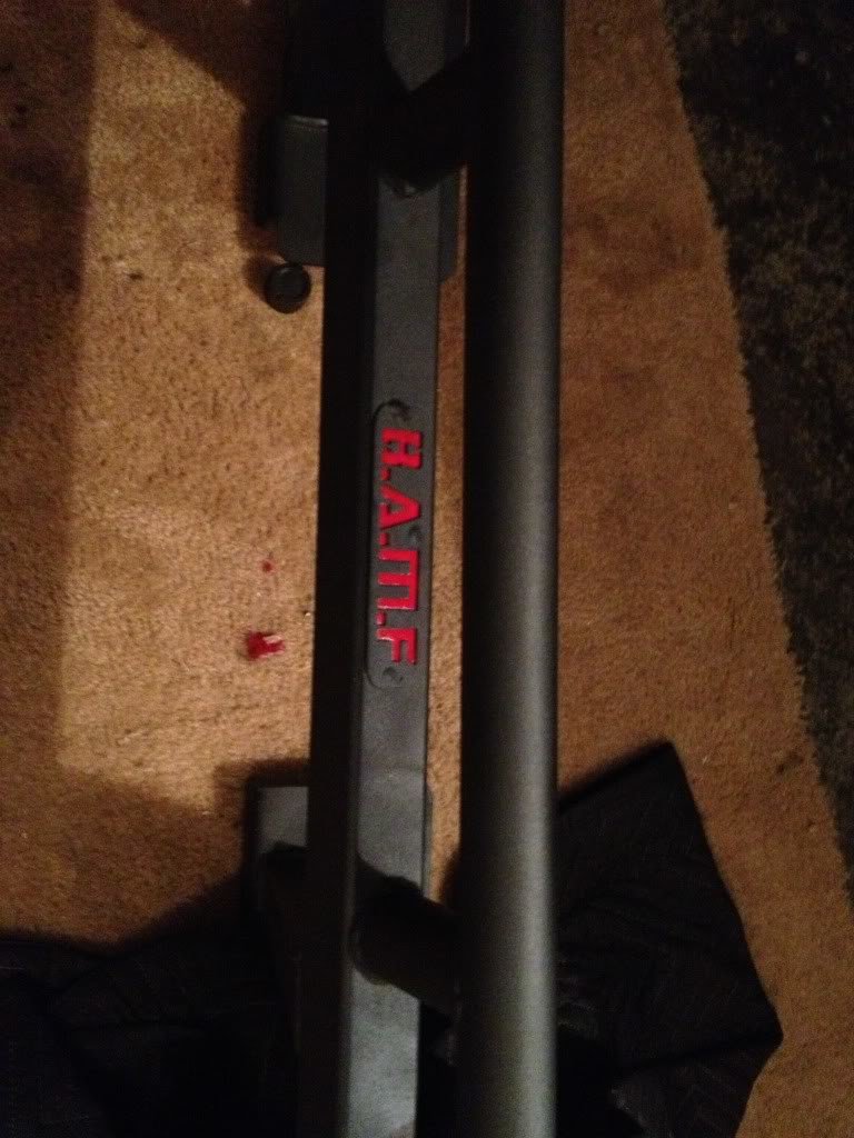

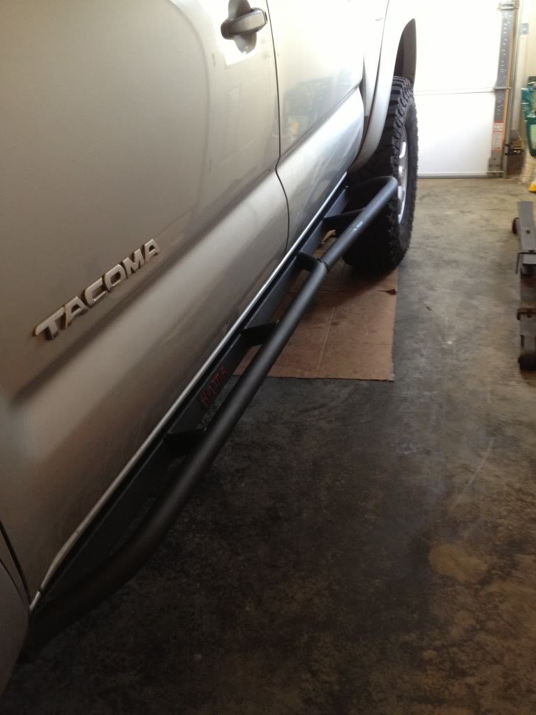

    Drilled the holes for my sliders on the drivers side, and painted the frame, also painted the letters on my BAMF sliders:
    Installed the drivers side today, completely bolted on! Now to finish the passenger side. Used POR-15 spray paint to recoat the frame and prevent rust, stuff went on great and looks great, considering painting the entire frame with this.

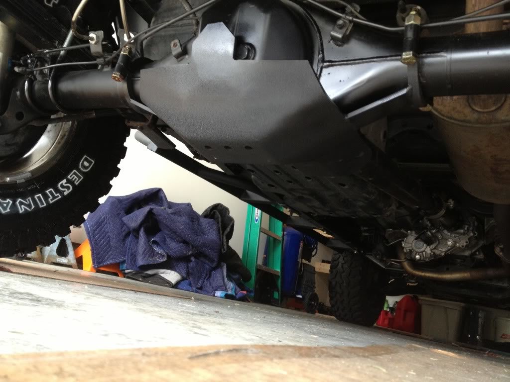

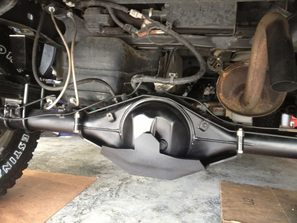

    Installed my BAMF Diff Skid

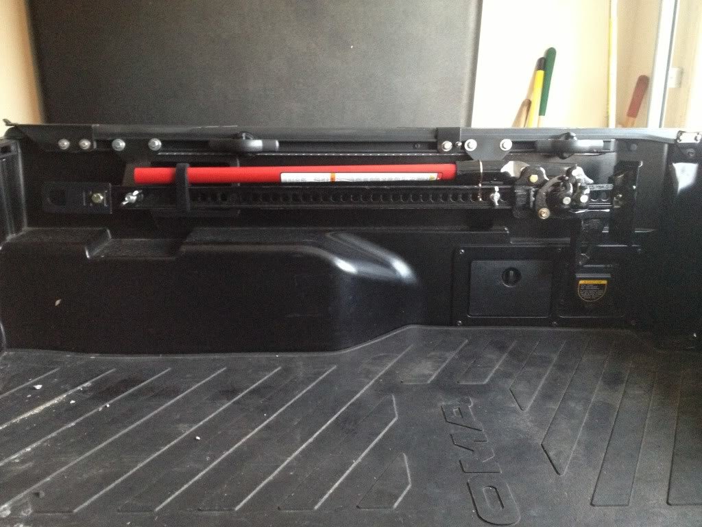

    I got my Hi-Lift today, fits perfectly.

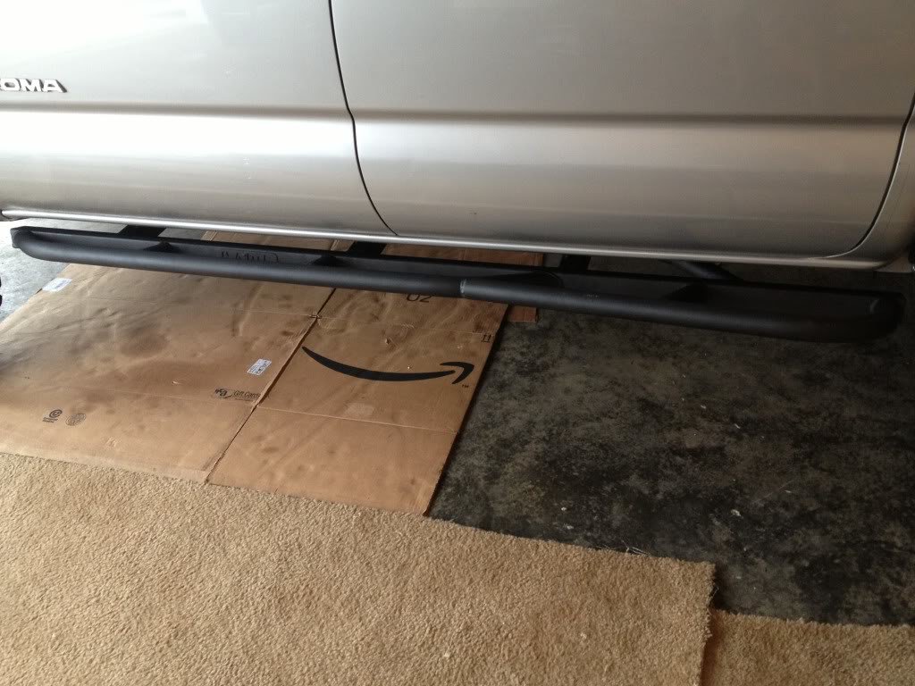

    Friends lifted 5-lug with stock tires, I helped him lift it last weekend - see the details here
    Also got the slider spacer kit from BAMF for my bolt on slider, painted and installed.

    Which hi lift mount are you useing?

    The 4x Innovations one, it is very nice.
