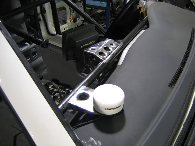

    Is that a fish finder & transducer????? :rofl:

    Pretty much. I've installed some weird crap in my truck.
