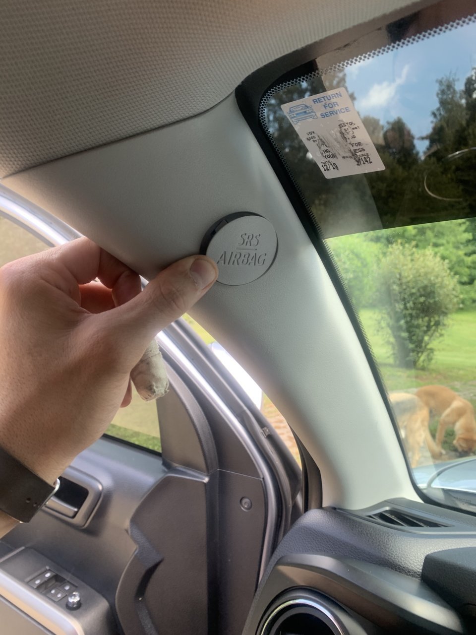

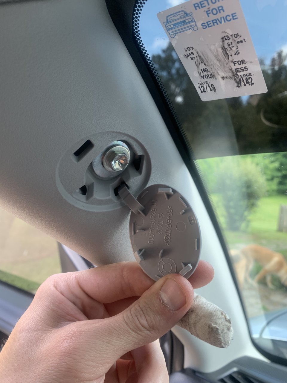

    These holes are spaced 7 inches apart. Therefore, any handle with 7 inch spacing at bolts/ screws will fit this. If the handle has a wide base, it can hide the holes that will be required.
    Important point, neither hole is actually threaded. Feeling behind the hole for the screw, it seems like Toyota glued or welded a nut of some sort, maybe a threaded t-nut, to serve as anchor for the screw. Same can be done for the second hole.
    When I find a handle I like, I’m installing it.

    A Rivnut and a Passenger Side Handle and you are good to go.

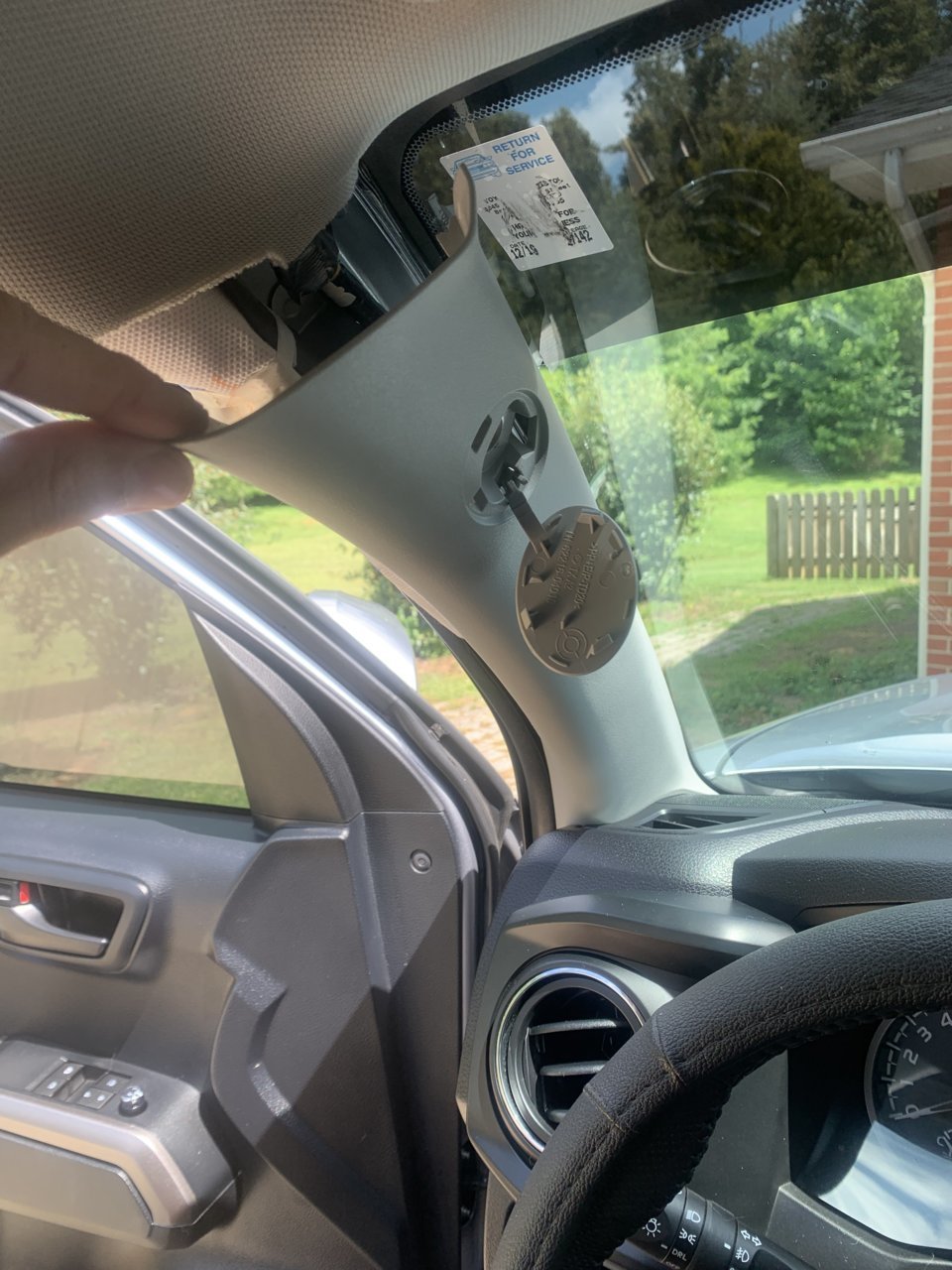

    Even the largest $500k 3D printers can only do 36in x 36in x 24in volumes. Most desktop printers are about 10in x 10in x 10in. So, the pillar trim would have to be about three sections, if not more. Beyond that, there are no flat surfaces to start a nice print on, so finish quality will be truly horrible not even considering the joints. Finally looking at crash test videos, the pillar flexs quite a bit to allow the airbag to deploy. If one thing can be said about our easily scuffed trim, it is very flexible and does not break easily which is the exact opposite of most desktop prints.

    Unfortunately besides the color, the pillar trim is shaped differently.

    Ah! The handle is the easy part. I think we can even flip over the passenger side handle? The stupid trim piece is the massive hold up. It would be worth the full $86 from Toyota.
